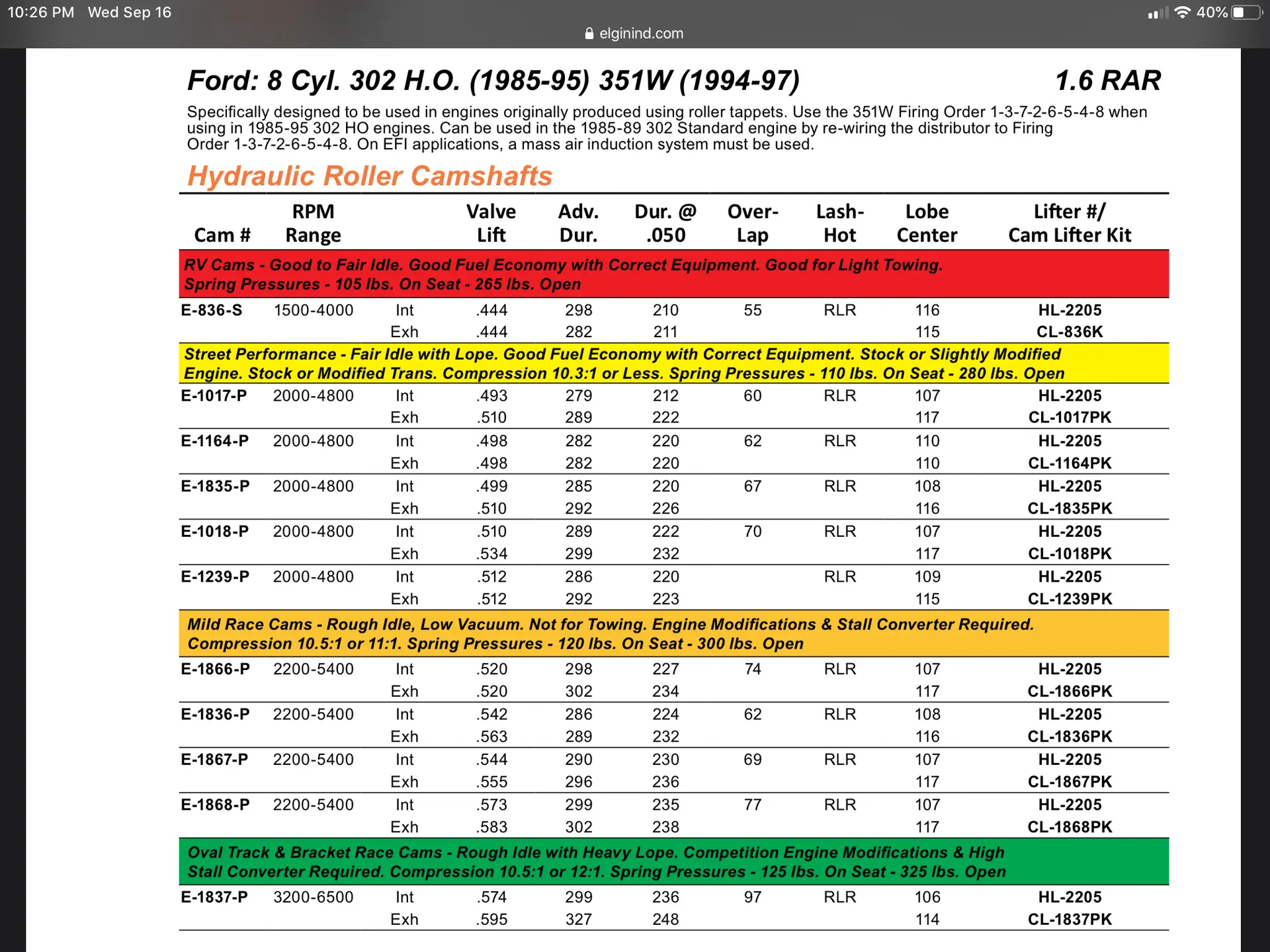

See https://www.elginind.com/wp-content/uploads/2018/12/Elgin-2018-ProStock-Catalog.pdf
Neither 1018 or 1087 show up in the catalog, so that may mean that the camshaft is no longer being manufactured.
This may be a flat tappet cam. All stock 1985 and later 5.0 pushrod Mustang engines had hydraulic roller tappet cams.
There are a number of things that need to be taken into consideration. Roller tappet camshafts are steel and need to be run with a steel distributor gear. Roller tappets on a flat tappet cam may not work well, this is a trial and error area.
The firing order may be wrong for a 5.0 Mustang HO engine. The HO firing order is 1-3-7-2-6-5-4-8. If you use the stock 5.0 Mustang HO EFI Mass Air Computer with a Non HO firing order (1-5-4-2-6-3-7-8 ), it will not perform to the stock cam levels. If you are using a Speed Density (1986-1988) computer, it will not run good at all.

The Elgin 1018-P is a hydraulic roller cam. The Lope Sep and duration are almost the same as a TFS2. The lift is about 3 tenths lower. Why is this an outdated cam?
