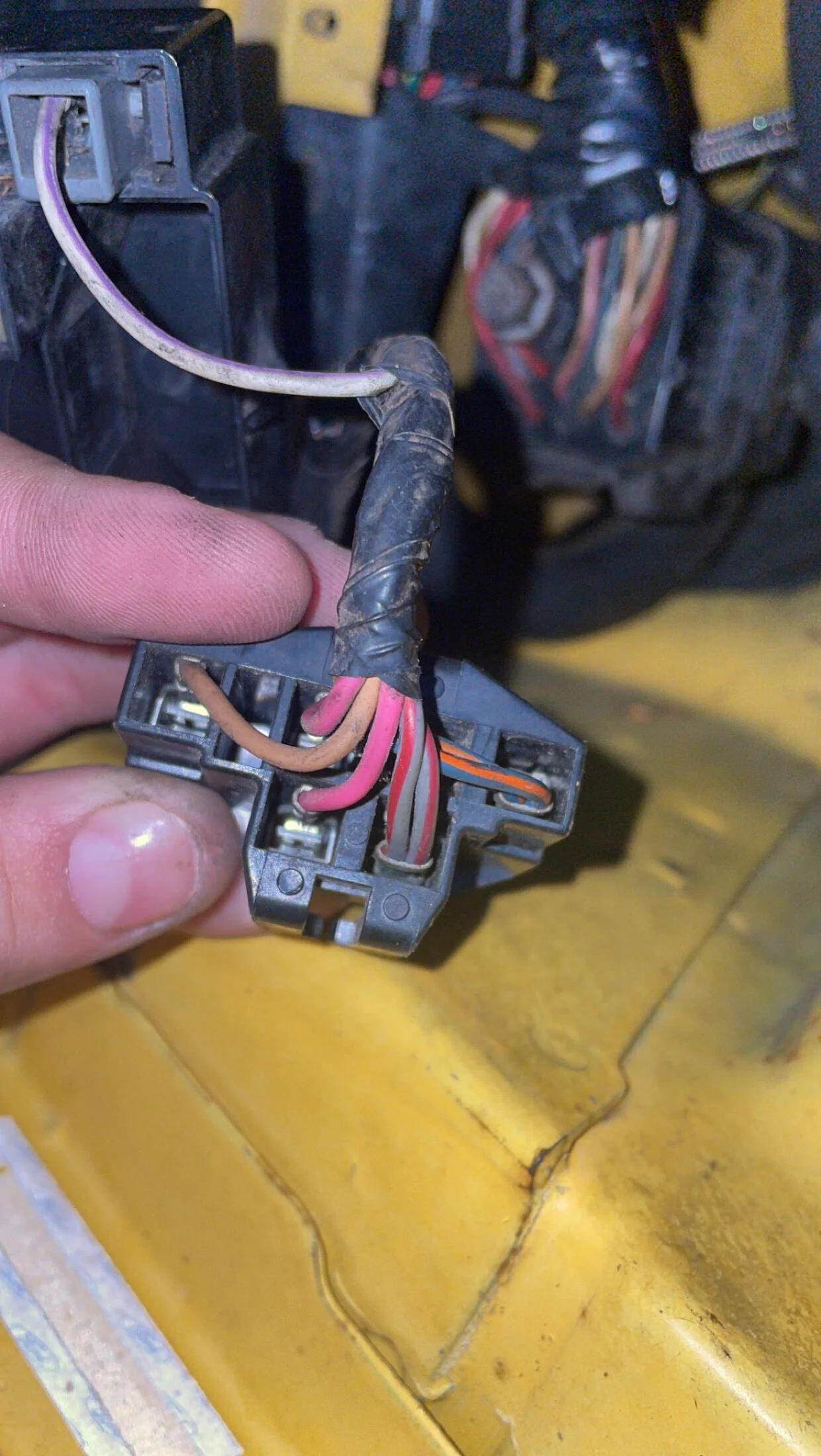

What is the wire color on pin 2 that you are trying to connect to? Black with white stripe?
T
tyler6368
May 28, 2023
Jun 3, 2023
  • Jun 3, 2023
Yes
T
tyler6368
May 28, 2023
Jun 3, 2023
  • Jun 3, 2023
No its not actually just checked
T
tyler6368
May 28, 2023
Jun 3, 2023
  • Jun 3, 2023
This is the connector
