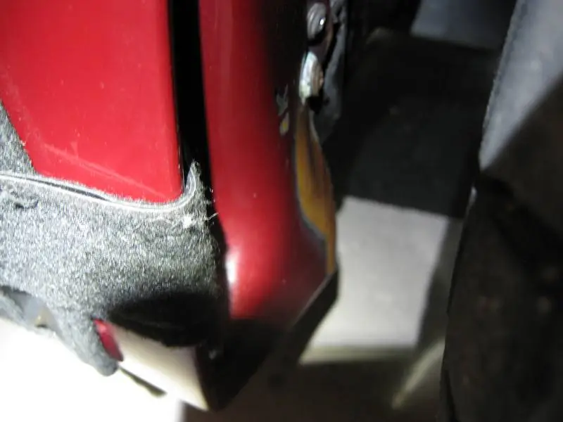

I have a picture to show how the factory 225/60/15's rubbed the flares on my '88GT.
Picture is driver's side, forward. Only occurred at full lock in one direction, even with one factory installed steering rack limiter on each side of the rack.
This is not a problem on LX or later GT's. The shape of the flare was changed slightly.
Reducing the overall diameter will prevent this.
225/50/15 or 225/50/16

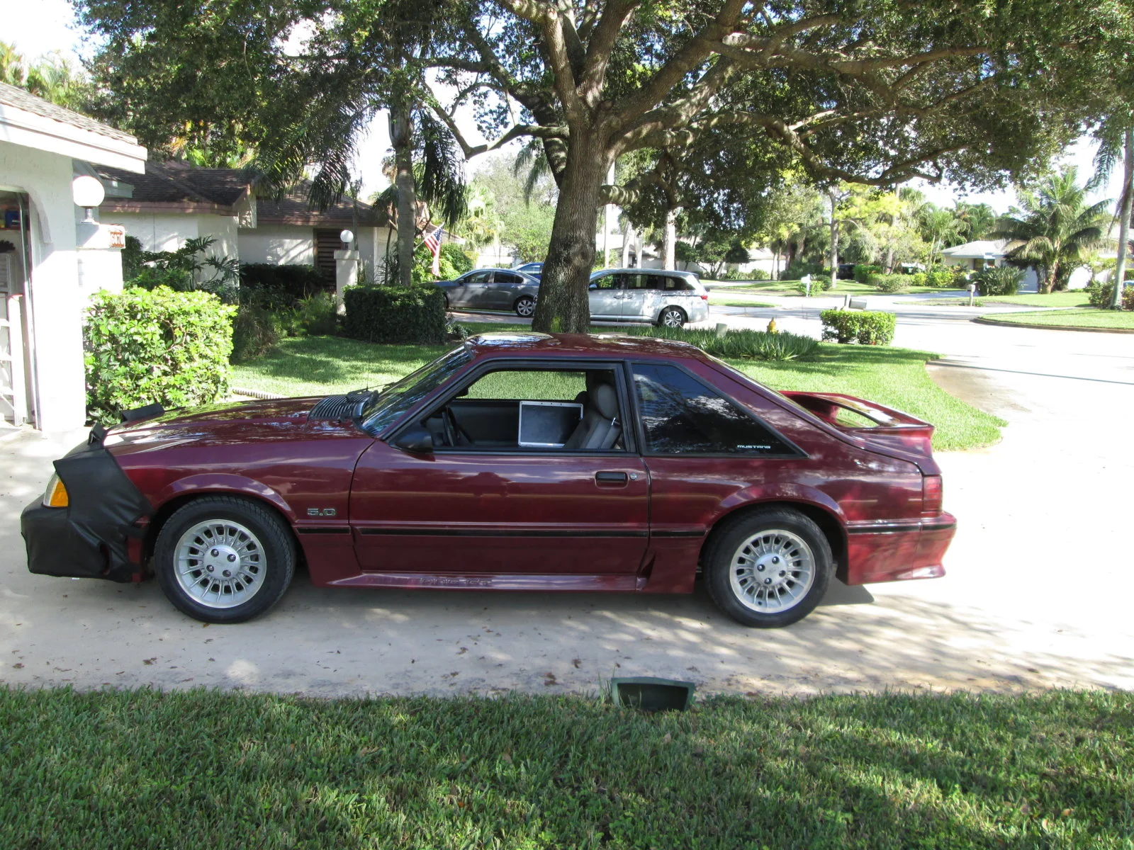

Here's a pic of the factory turbines with the 225/50/15's
