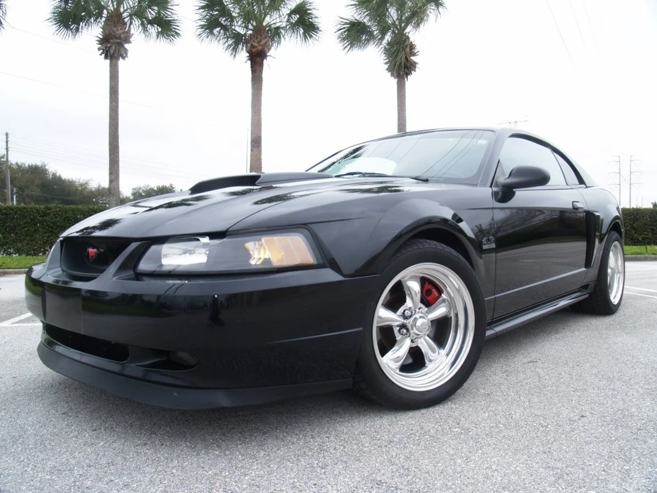

Description TORQ THRUST M 17x9 5x114.3 GUN METAL (45mm offset)
Offset 45 mm Backspace 6.77 in
Size 17" x 9" Center Bore 72.60 mm
American Racing has (or, at least they had) Torq Thrust IIs specially designed for the SN-95 Gen2. (What they didn't tell you was they wouldn't fit a car with Cobra brakes...doh! I had to use a small spacer to clear the calipers) I absolutely LOVED these rims, but they were polished, not chrome, and required a lot of elbow grease to keep them shiny.
