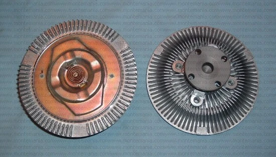

If there is an exposed bimetallic spring on the front, it's thermal. If it's smooth, it's not.
Yes, but the fan is blowing constantly! - and temp does not rise to normal - it has to be a non-thermal or broken I think...

I'll check the spring. However, the fan blows max from the very minute I start the car, and it just keeps on going. Takes 30 min to reach 1/3 temp. Can't even have the underdash vent open any longer because of the EL Ninja wind blowing in..

The one on the left shows the thermal spring.
