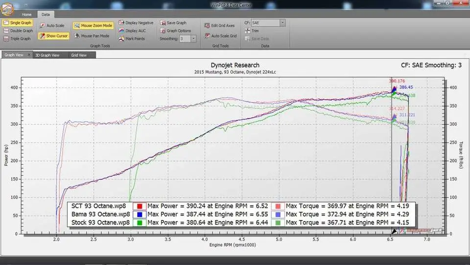

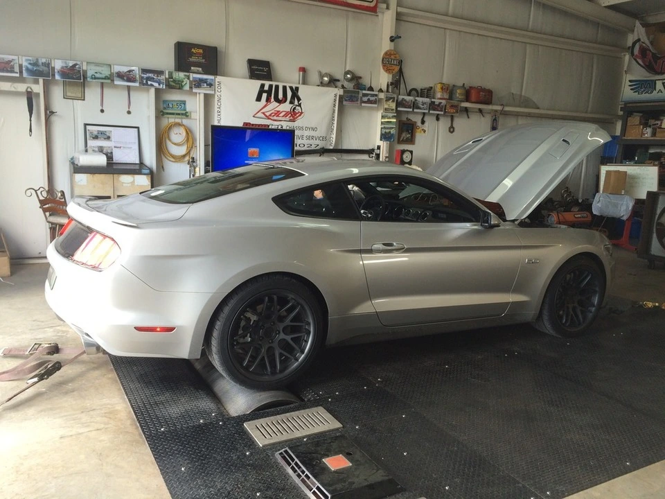

So I took the car back to the dyno today. I've data logged the crap out of the car, done AT LEAST 3 WOT hits a day in the process, and received 6 tune revisions from Bama. After the last revision and data log it was deemed that the car was ready to get strapped back down, so that's what I did today.
Here are the results. lol
First up, stock tune, 93 octane. Second, Bama 93 Octane Track tune. Last, because I was a little ticked off, I decided to load up the baseline SCT file that comes on the tuner....

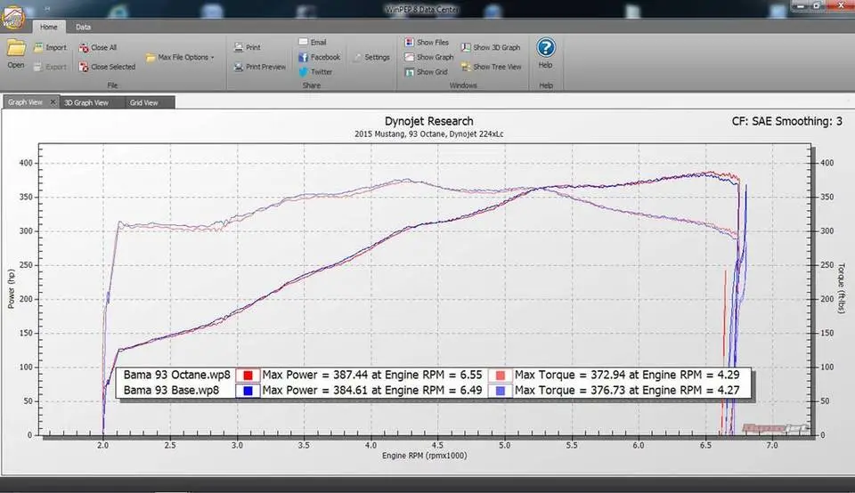

Here's the net result of several tanks of fuel, lots of thrashing on the car, and more than a little patience on my part.....
The base file (blue) is the one that was originally sent with no logging, no drive time.
The 6th revision of the tune (red) is the one after all the logging and thrashing on the car.
The ONLY spot the revised tune out performed the base line tune was from 6500 - 6700 RPM's, otherwise the base file was ahead of it the entire time.
