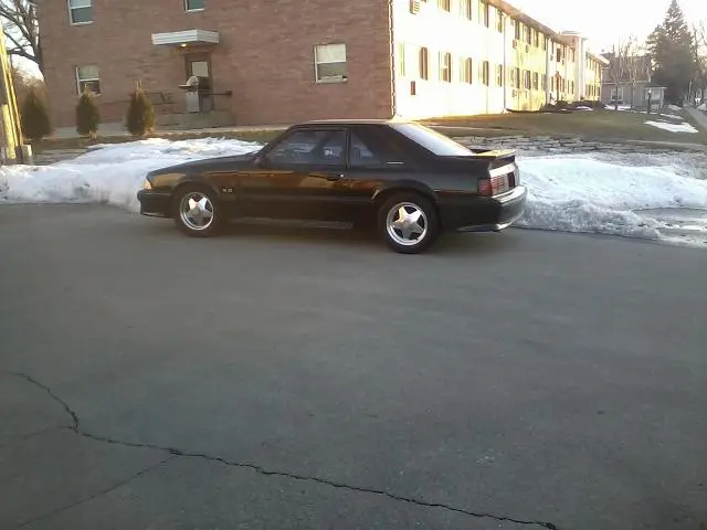

End result.
My car used to ride really rough and was noisy with stock 73K suspension.. I just installed Strange shocks/struts with B springs and poly isolators and the car rides like a dream. While doing the front, one of my springs was broken - probably before I bought the car. Waiting to go on next is MM sub frame connectors and XD LCA's.
Hmmm, I like the stance on that. About what I'm looking for.

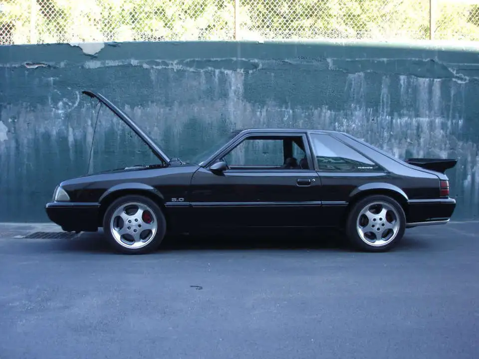

I'm using the Tokico suspension package, HPK-211. Great ride and great handling, couldn't be happier with the setup. Lowered the front about 1", the rear about 1/2".
The kit came with 4 springs, 2 struts and 2 shocks, cost $405 to my door.
