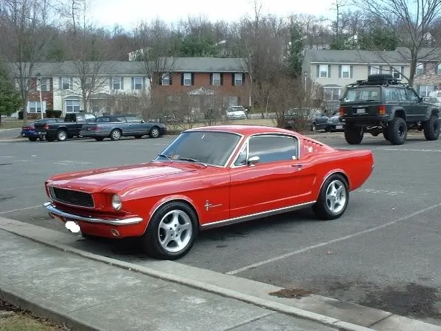

That's VTstang66's fastback running the same rims. He told me his spacers are 1.25" but could be smaller since they rub the fenders a little. I'm looking at 1", but I don't want it to go too small and rub something on the inside.

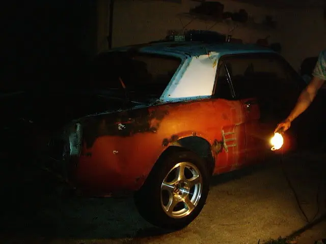

These are different and something tells me they'd look good on a coupe. They looked alright on my friend's project car.:rlaugh:
