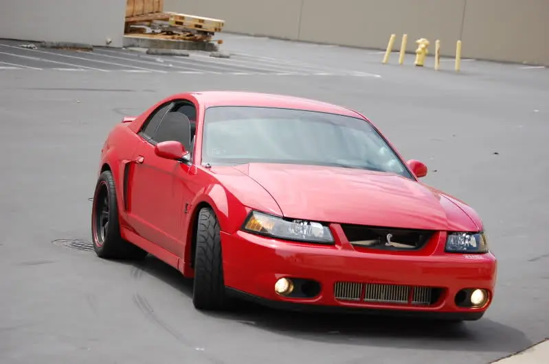

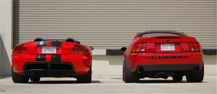

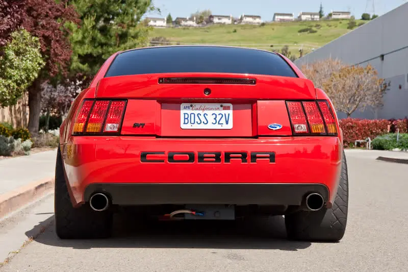

345/18's :drool: :drool: :drool: :drool: :drool: :drool: :drool: :drool: :drool:
LOOK @ THOSE REAR MEATS!
thats so awesome!

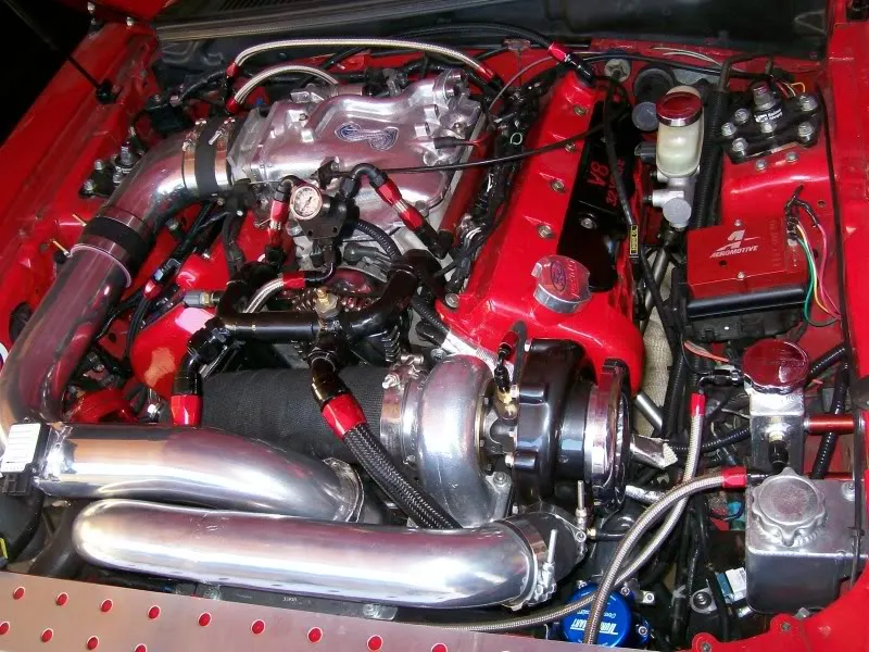

id like to see whats under the hood!!!!!
if its a dressed up 6 ill knock someone out! :jester:
Motor specs:
03 cobra iron block .020 bored over
5.0l Stroker kit
Manley H-beam forged rods
Manley 11cc forged pistons
Stock ''C'' heads/cams
Stock intake and t/b
Drivetrain:
Tremec TKO600 tranny
Spec stg. 3 clutch
aluminum drive shaft
8.8 Solid rear axle with 3.31 gears
Turbo:
Custom (garage built by me) Turbonetics GT-K1000 kit (t76 .96 a/r)
4 inch down pipe with 3.5'' oval DMH electric cutout
Turbosmart 50mm w/g
Eboost2 boost controller
procharger race bov
Stock exhaust manifolds
hot and cold side ceramic coated
hot side wrapped
Paxton a/a intercooler
3.5'' pipe from i/c to t/b
Fuel system:
Aeromotive A1000 pump and filters
Aeromotive fuel pump controller
Aeromotive sumped fuel tank
Aeromotive fuel rails and regulator
Siemens deka low impedence 83lbs injectors
Acceleronics injector driver
PMAS maf sensor 30T (Blow thru)
