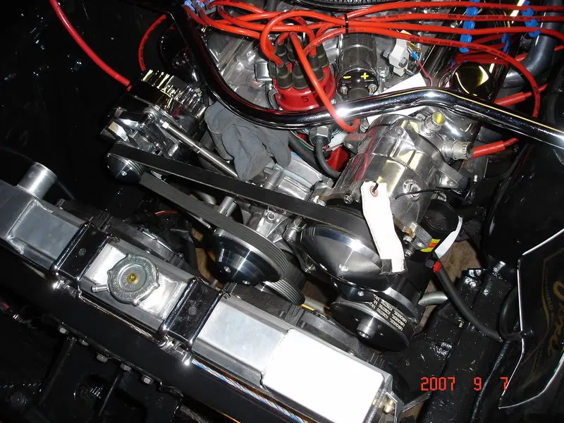

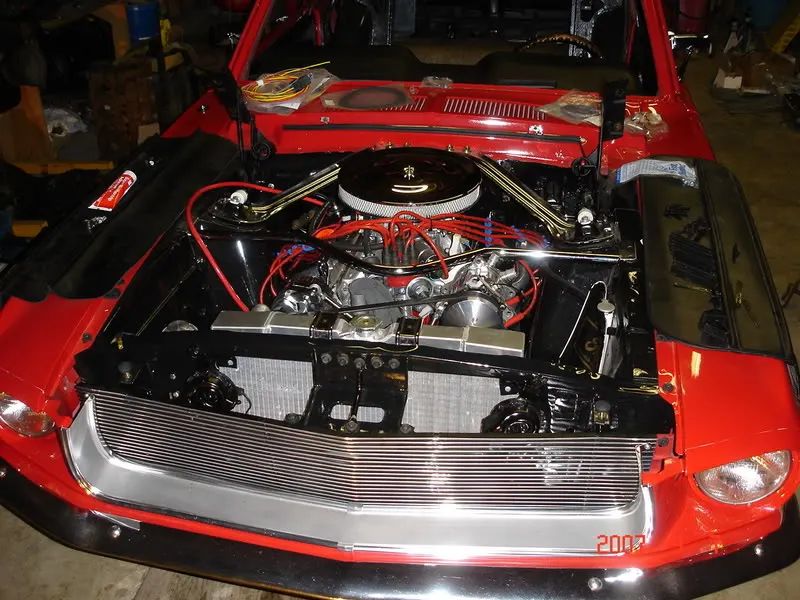

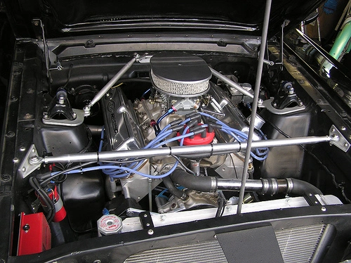

1967 Mustang Coupe Restomod
351W, 400 HP, Serpentine Setup, Ron Davis Radiator, relocated battery

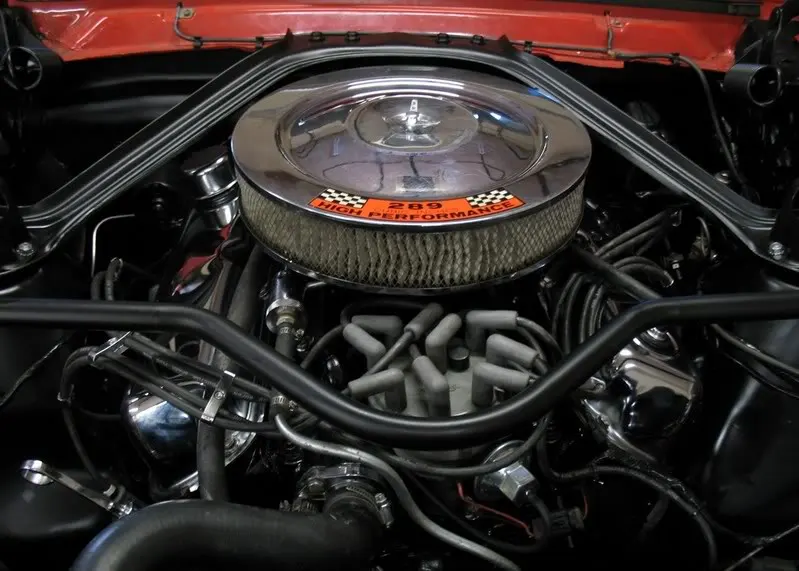

289 modified with Edelbrock RPM power package including aluminum heads, intake, hydraulic roller cam, new pushrods, new lifters, roller rockers, 750 CFM carburetor with electric choke. March Performance billet pulley under drive system, cool flex radiator hoses upper and lower. Accel coil high performance coil & points eliminator kit. New fuel pump, Russell fuel line, generator replaced with 80 amp alternator.
C4 automatic rebuilt by JPT transmissions 2000 stall converter all thrush washers replaced with needle bearings
8 inch rear end 3.80 limited slip differential
Lokar auto shifter with leather boot
total cotrol products power rack, coil over conversion and SSBC power disc brakes
thermostat housing
if you look in the first picture posted, the location of the thermostat housing neck is straight up into my monte carlo bar.....anybody have suggestions, with the serpentine setup and monte carlo bar in mind ( I can always just loose the monte carlo bar but I don't want to! hehe), as to what I can do to clear this? I really want to use the cool flex hose but don't think it will clear with the current setup. Thanks.
:shrug:
I can't move the bar due to the closeness of the A/C compressor. I would like to get a different housing but don't know of any that would fit. I even think the forty five straight forward T-stat will hit the bar for the alternator on the serpentine setup. I have been looking, not hard, but haven't seen any yet. Know of any multipositional ones?
