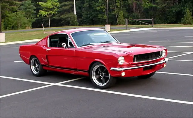

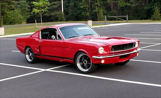

235/45-17 Falkens on 17 x 8 Raceline GT's with 5" backspace, 7/32" spacer on the fronts to clear upper ball joints, rolled fenders, 1" Shelby drop, Maier Racing "realigned" UCA's, progressive rate "one inch lowering" coil springs with about 1/2 coil cut, Maier 4.5 leafs.
