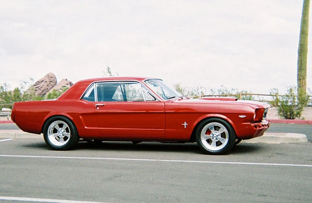

Your Stance!!
225/60/14 all around
No suspension mods (yet), just 40 year spring sag

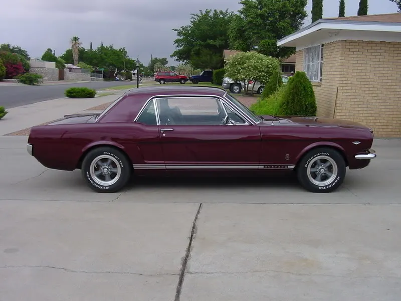

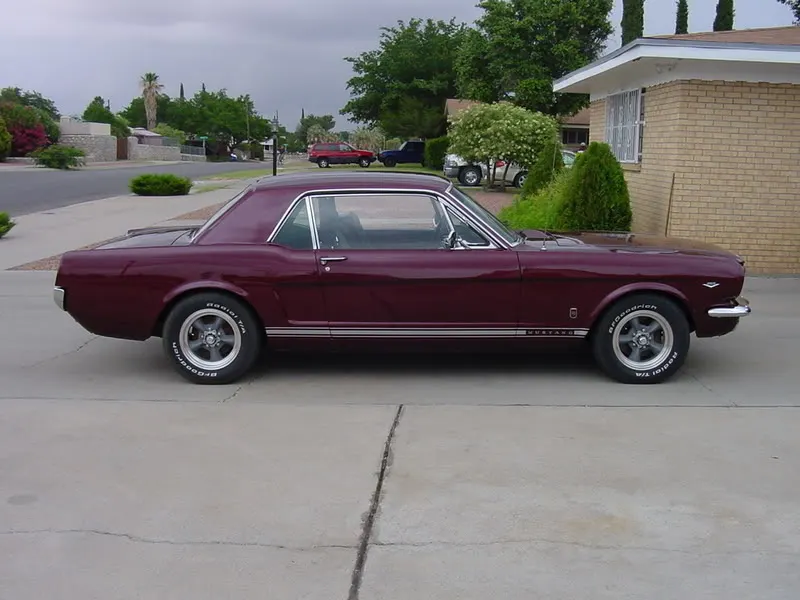

To: Z06killinSBF; dodgestang; iskwezm
- I noticed all you have 17x8 all around with a lowered ride. Do you guys have any rubbing issues? If not, what did you do to stay away from that?
Man my fronts rub before I even THINK about making a turn.:bang: I need to pound out my fenders cause I'm NOT changing my ride height. I actually need to lower the back some too.
They didnt rub when I had my 16x7's on there though.:shrug:
I know, I might actually have a chart somewhere or another that list out what people do (or don't do) to fit rims and tires on their mustangs complete with all their suspension and mod info. ;)
However I run 17x8 with 245 40 17 on the front with shelby dropped upper arms and 3 degrees neg camber. Before that I ran 234 45 17 on the same wheel with 1.5 degree negative camber. I have never rubbed and I do not have my fender lips rolled in the front.
