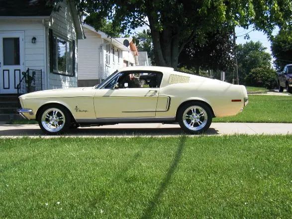

Here's mine. Front lowered 1.25", rear lowered 1". Tire size: 225 17's front, 255 17's rear. 331 stroker / modified C-4 / Currie 3.25 8" rear. Just finished it a month ago! :D

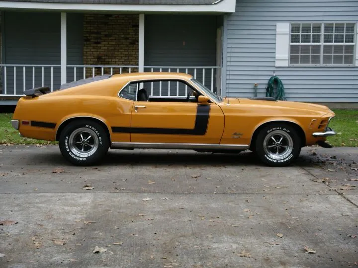

like this?
I'll look for a better shot

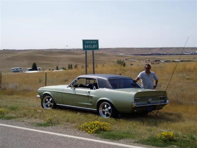

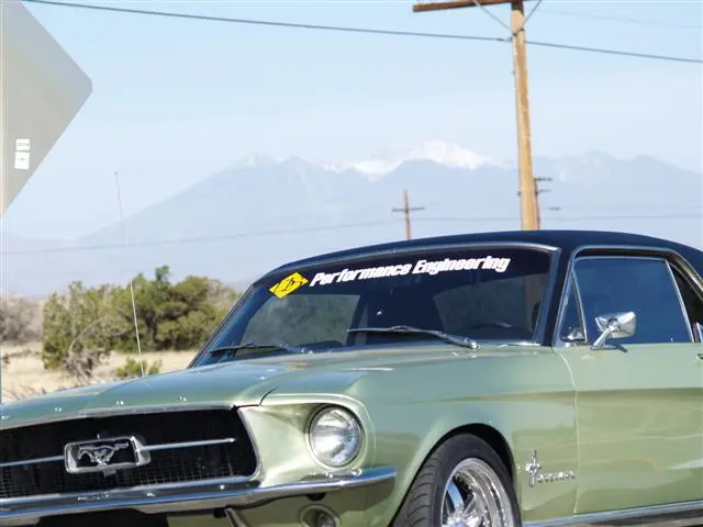

mustang's + kit, over 10+yrs!
620 coils, UCA drop, opentracker roller spring perches, 4 1/2 leaf mid eye, Edelbrock IAS shocks

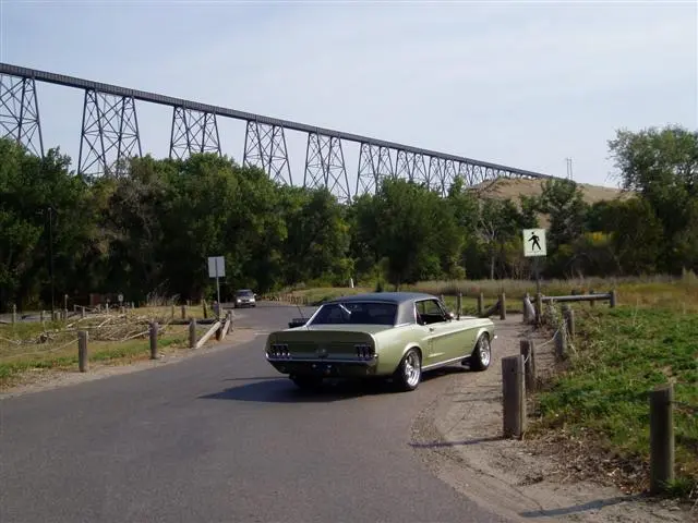

some more
trying to get a full side shot
these two are with the car loaded with gear.

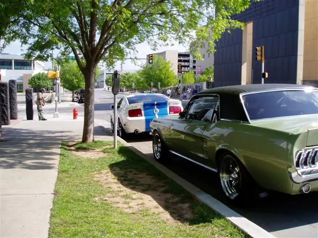

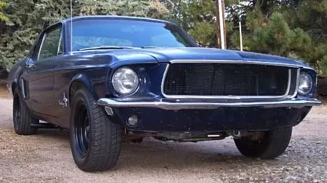

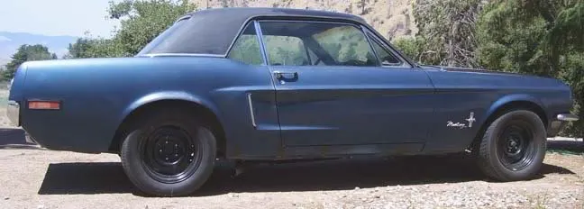

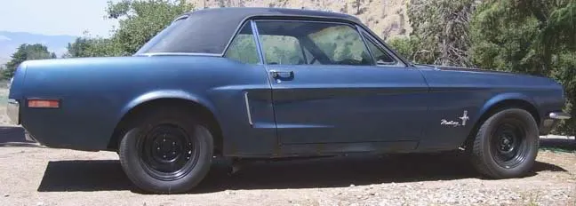

15x7 Mopar steels, 225-60-R15 tires, and worn out stock suspension and KYB Gas-A-Justs. This is before I put the narrower '57 9" rear under it:

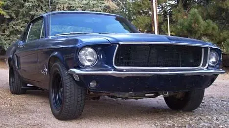

And this is after:
It's hard to tell from the side, but the rear wheels are about 3/4" further inboard than with the stock 8". I have some 620s for the front, but I'm waiting to get some roller perches and 4.5 leaf rears before I tear into it.
That looks like Baldy in the hazy background of the second pic....
