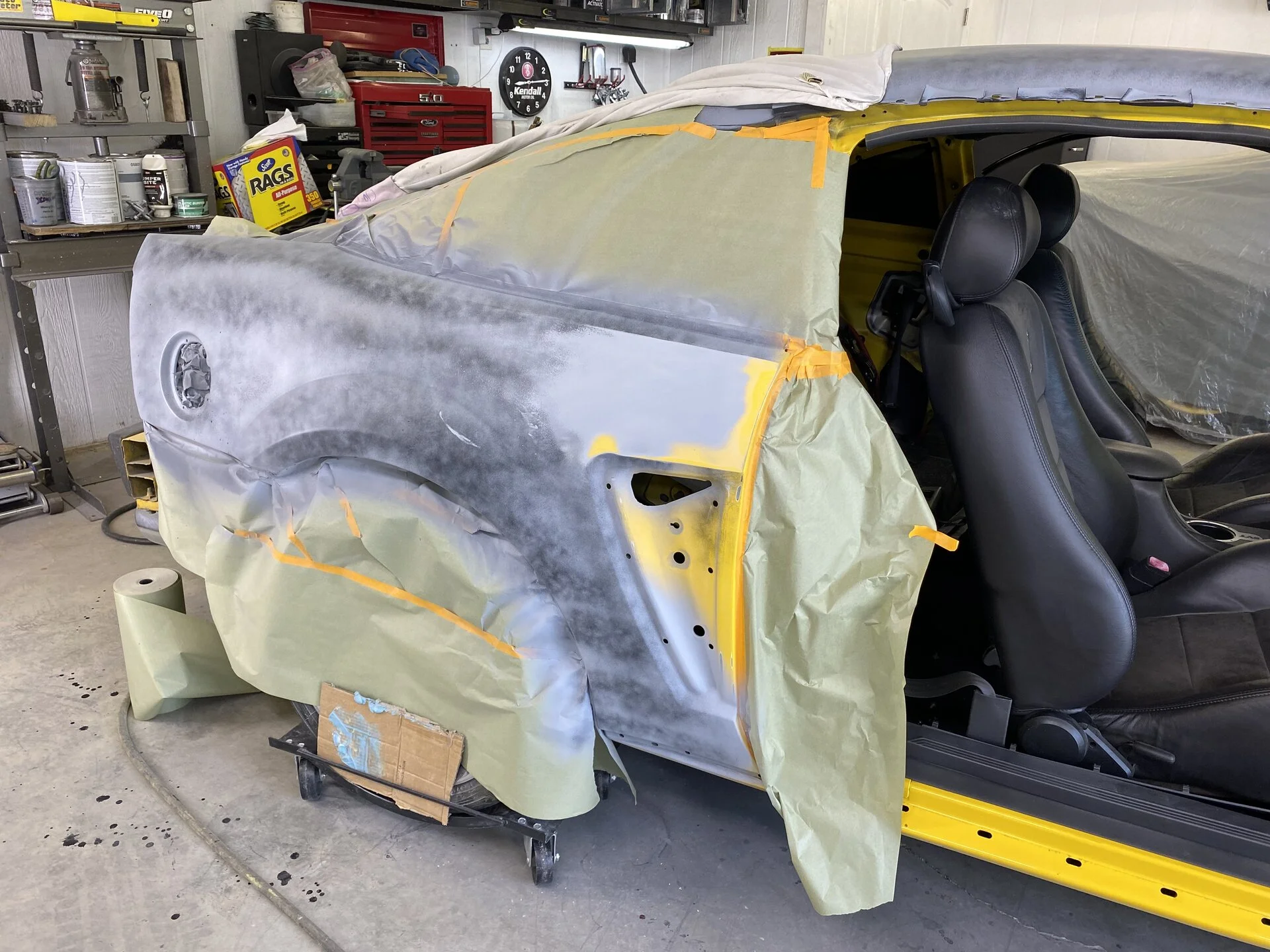

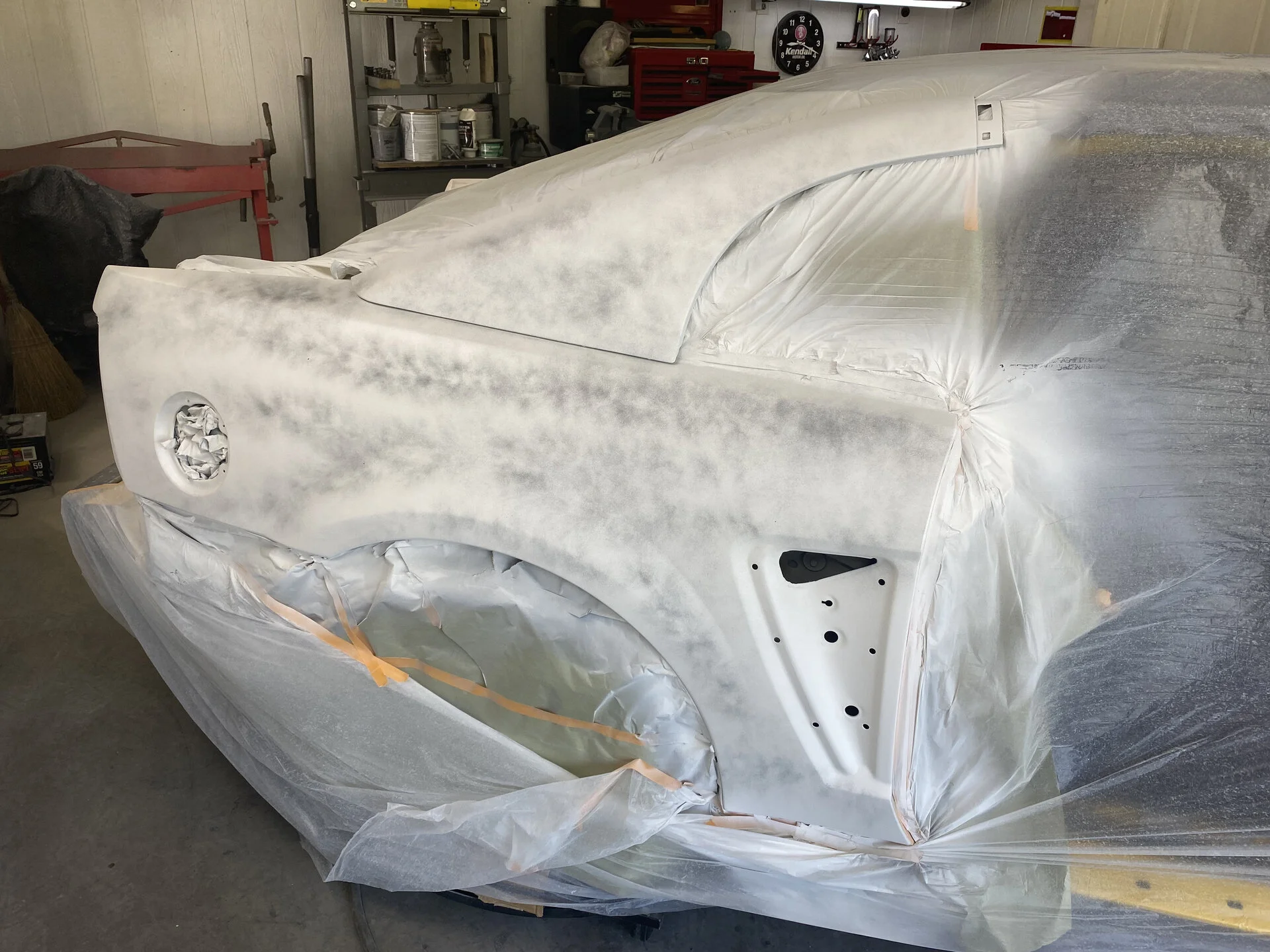

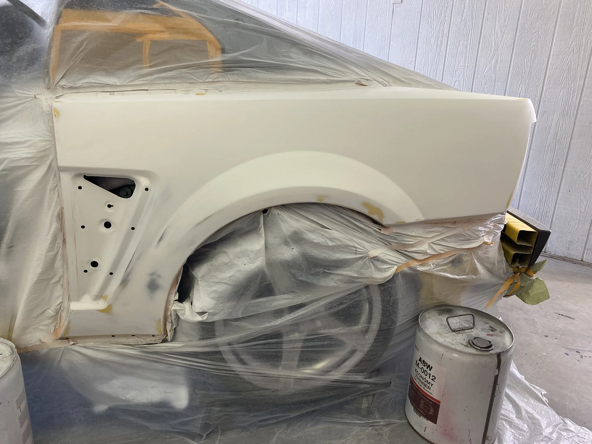

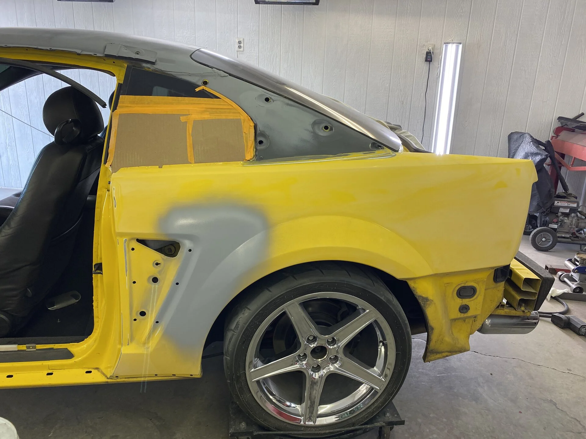

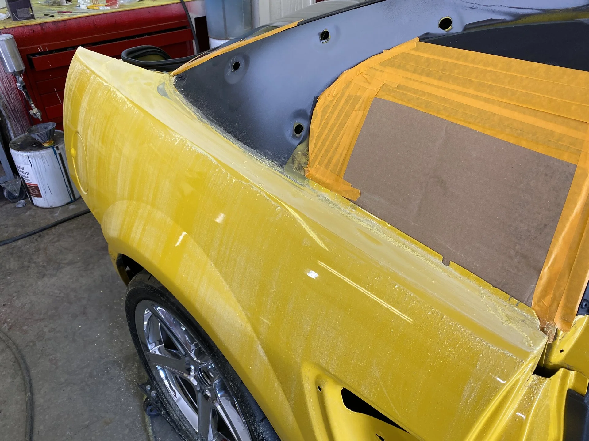

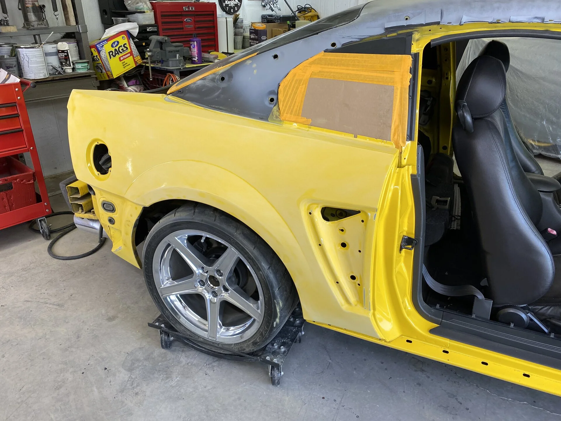

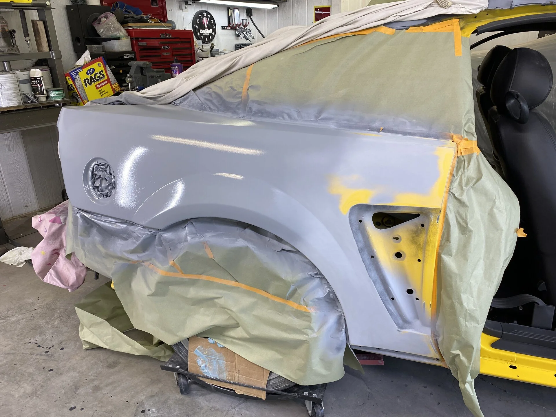

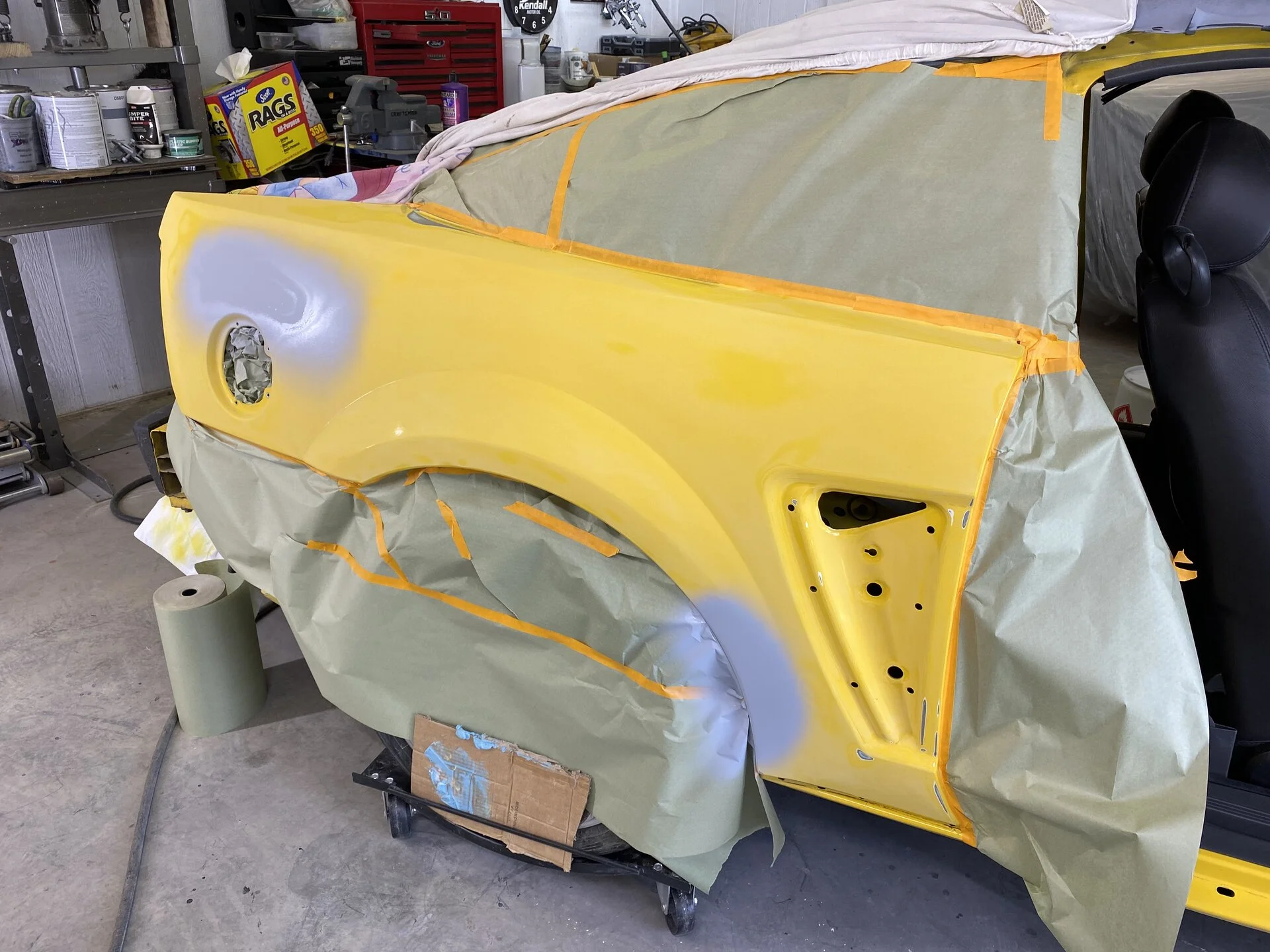

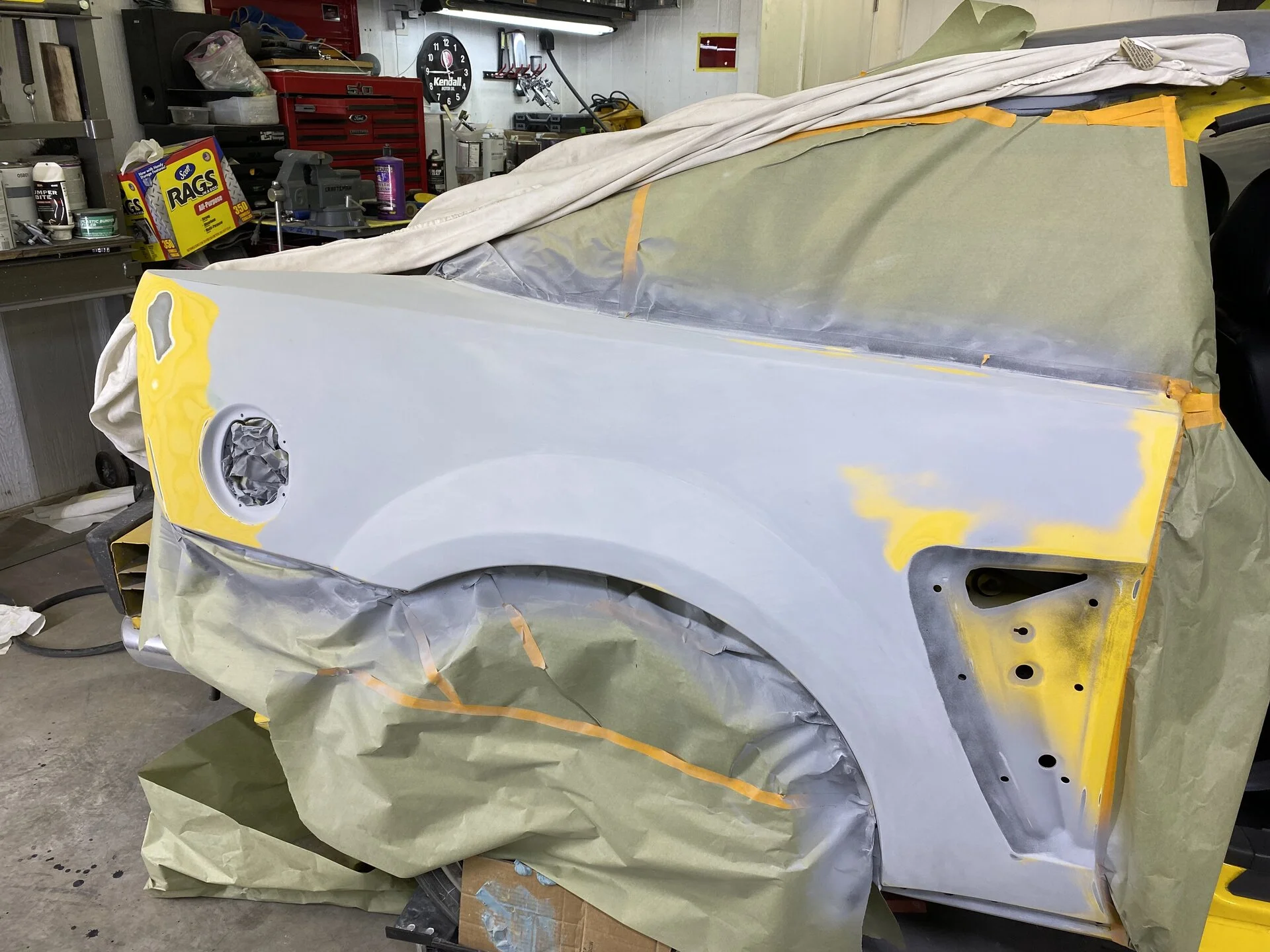

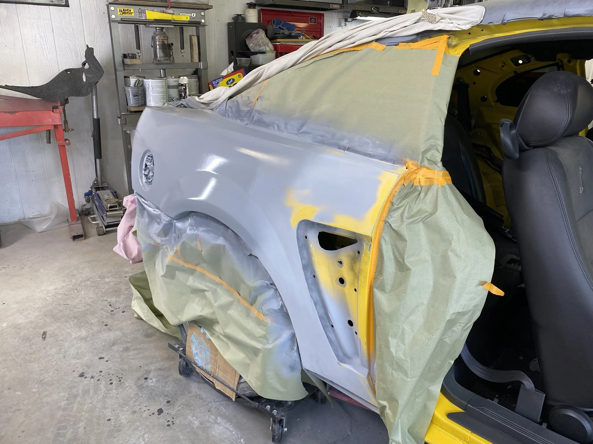

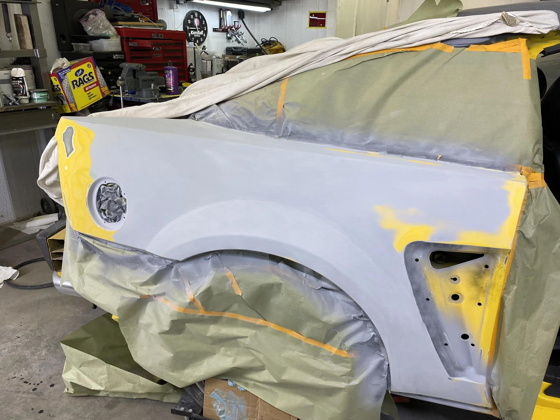

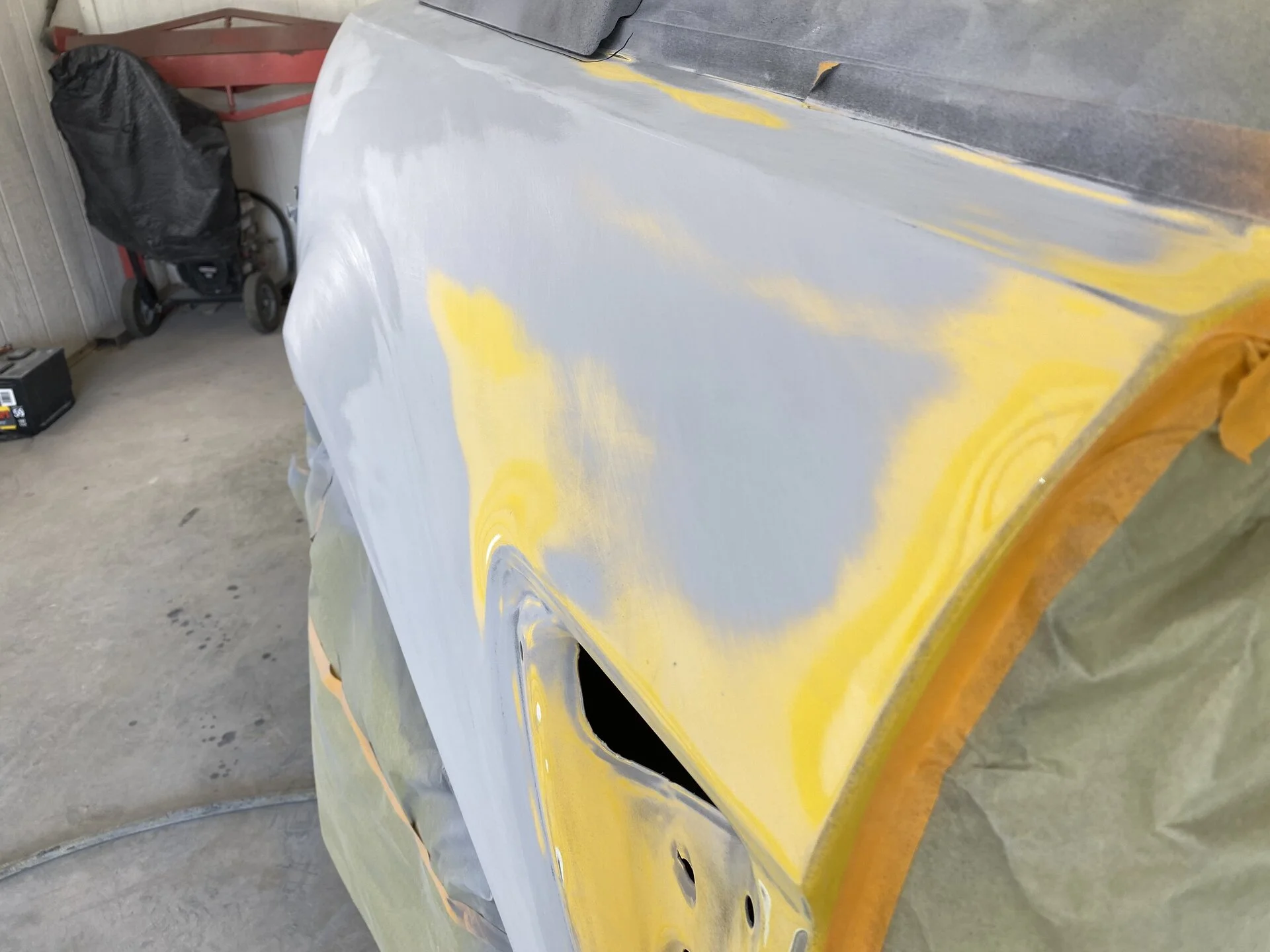

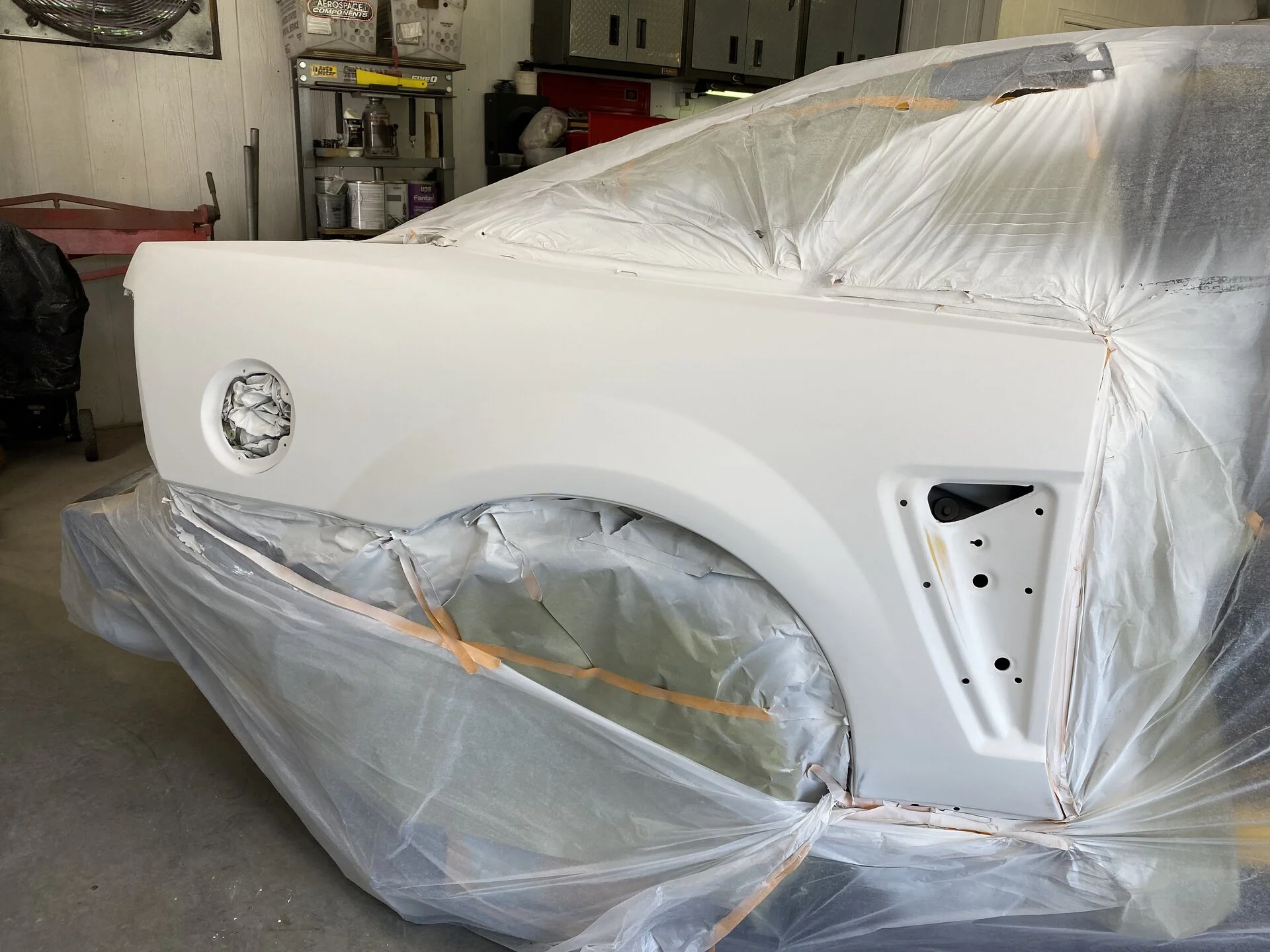

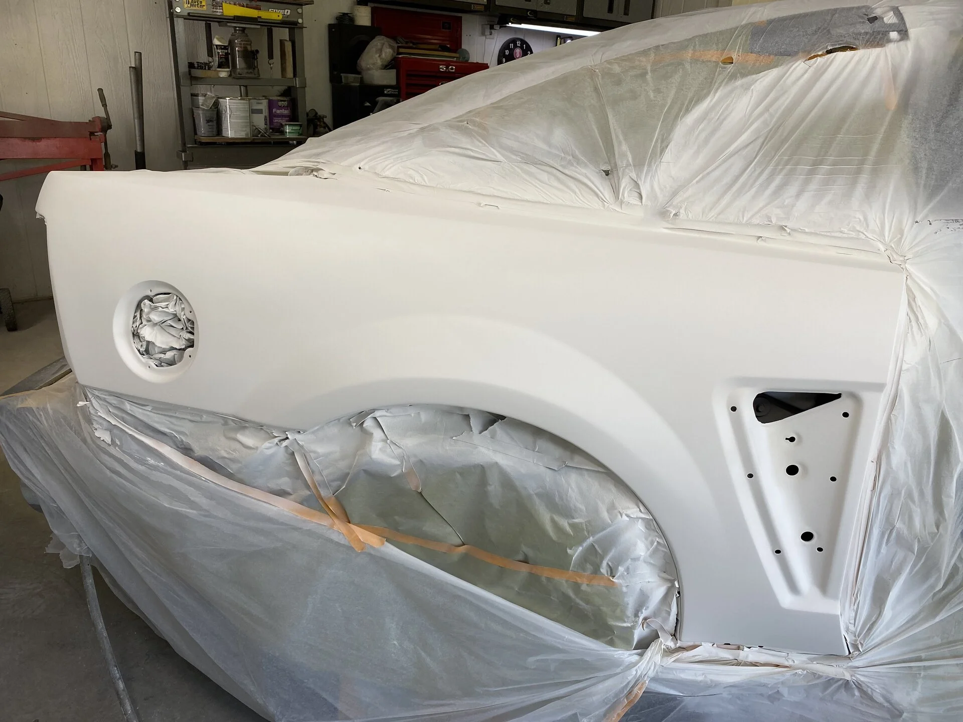

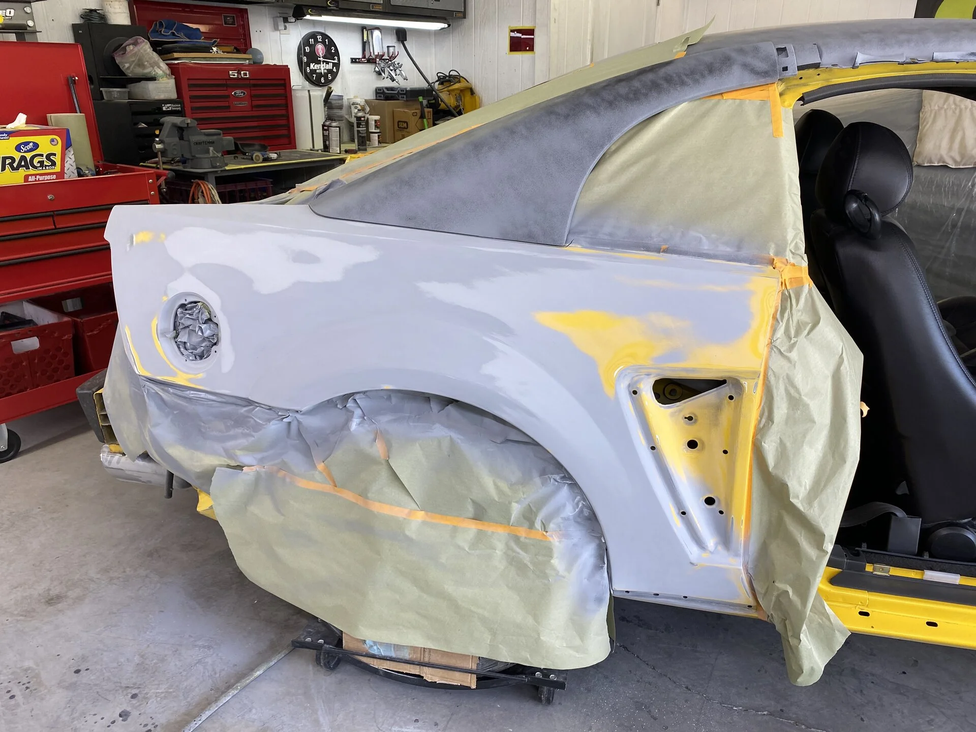

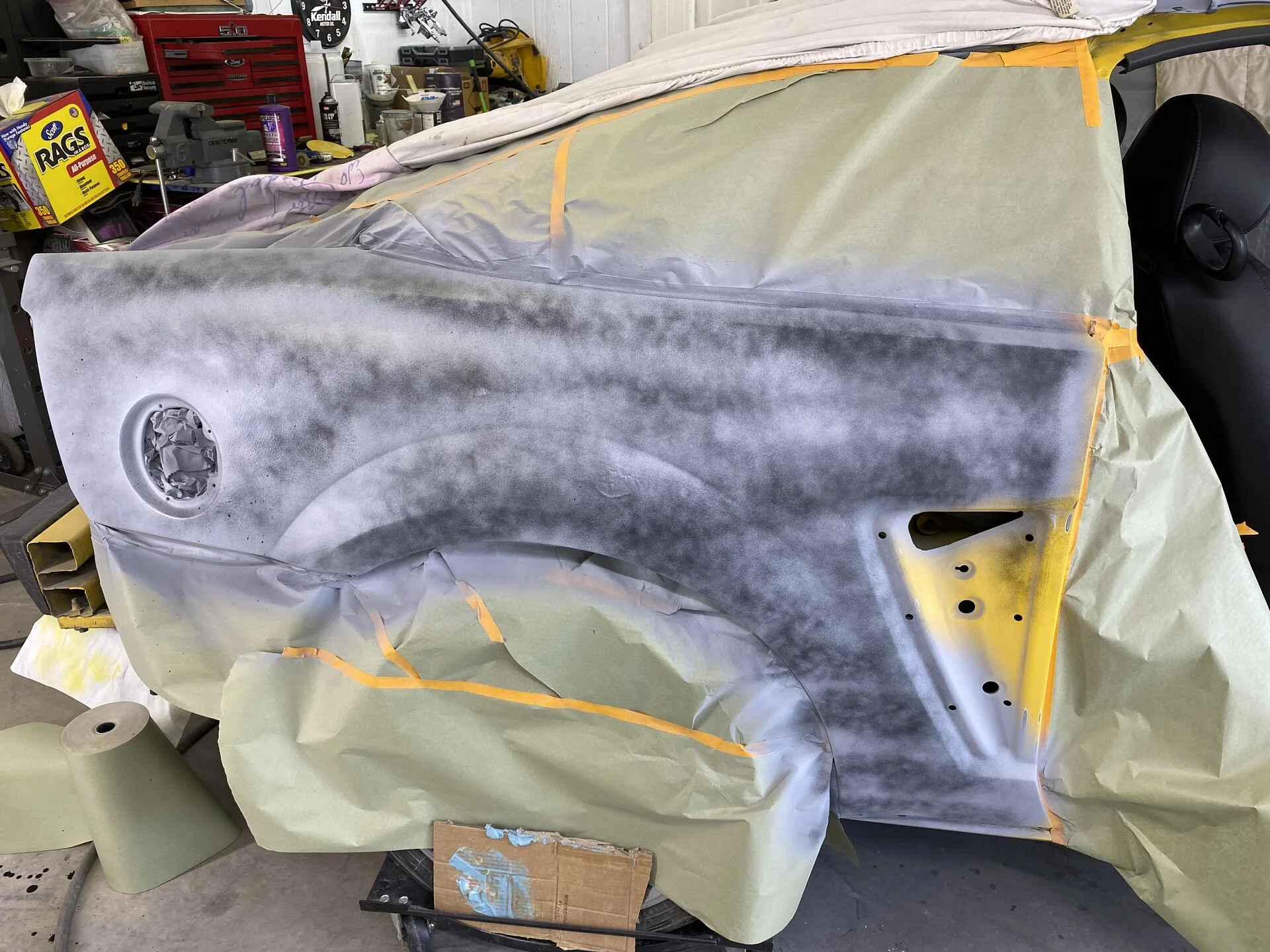

Moving to the quarters. The passenger side was in great shape. Never even a door ding but always have to address spots around panel stamping. IE: fuel filler and quarter scoop area.

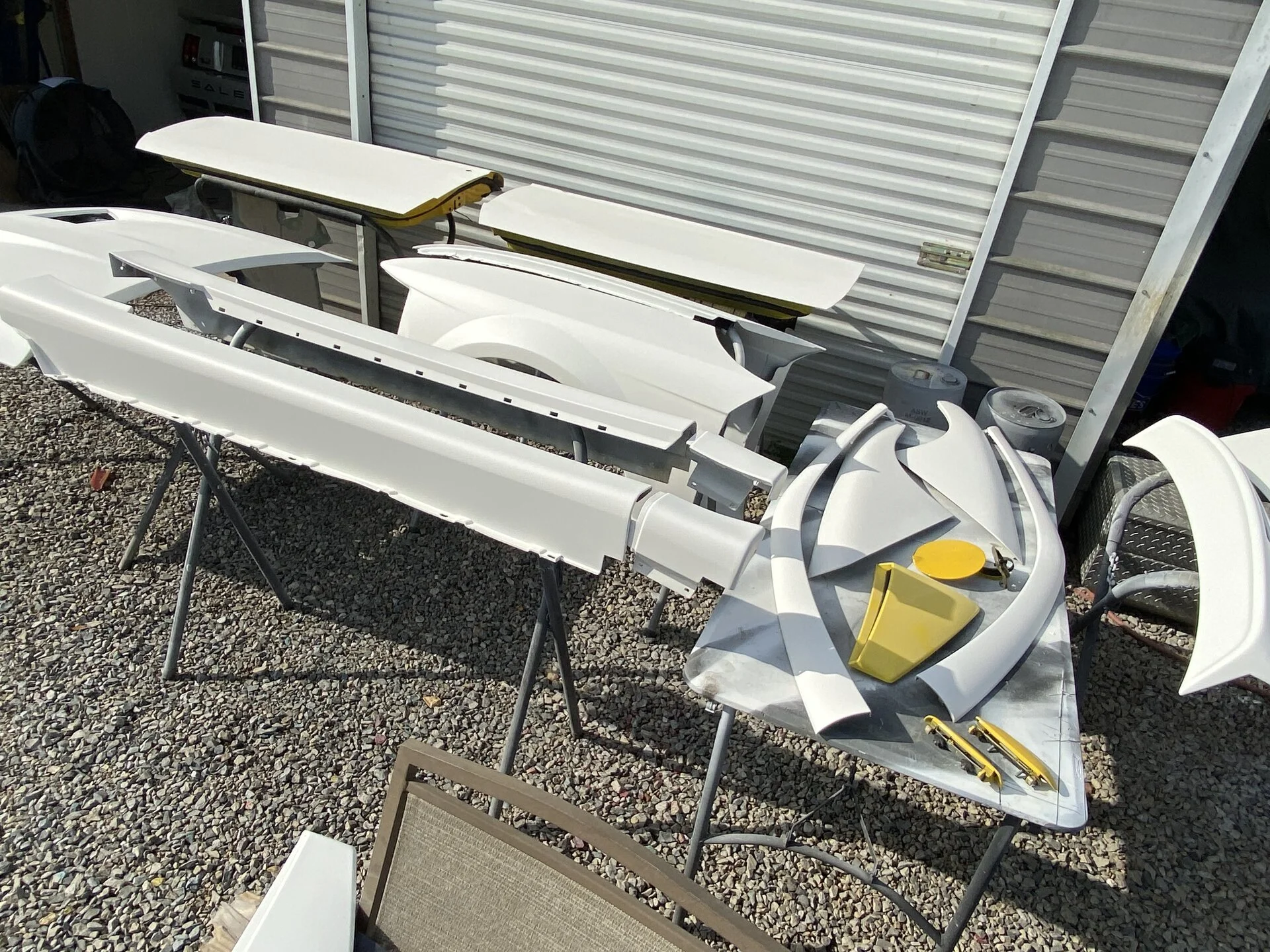

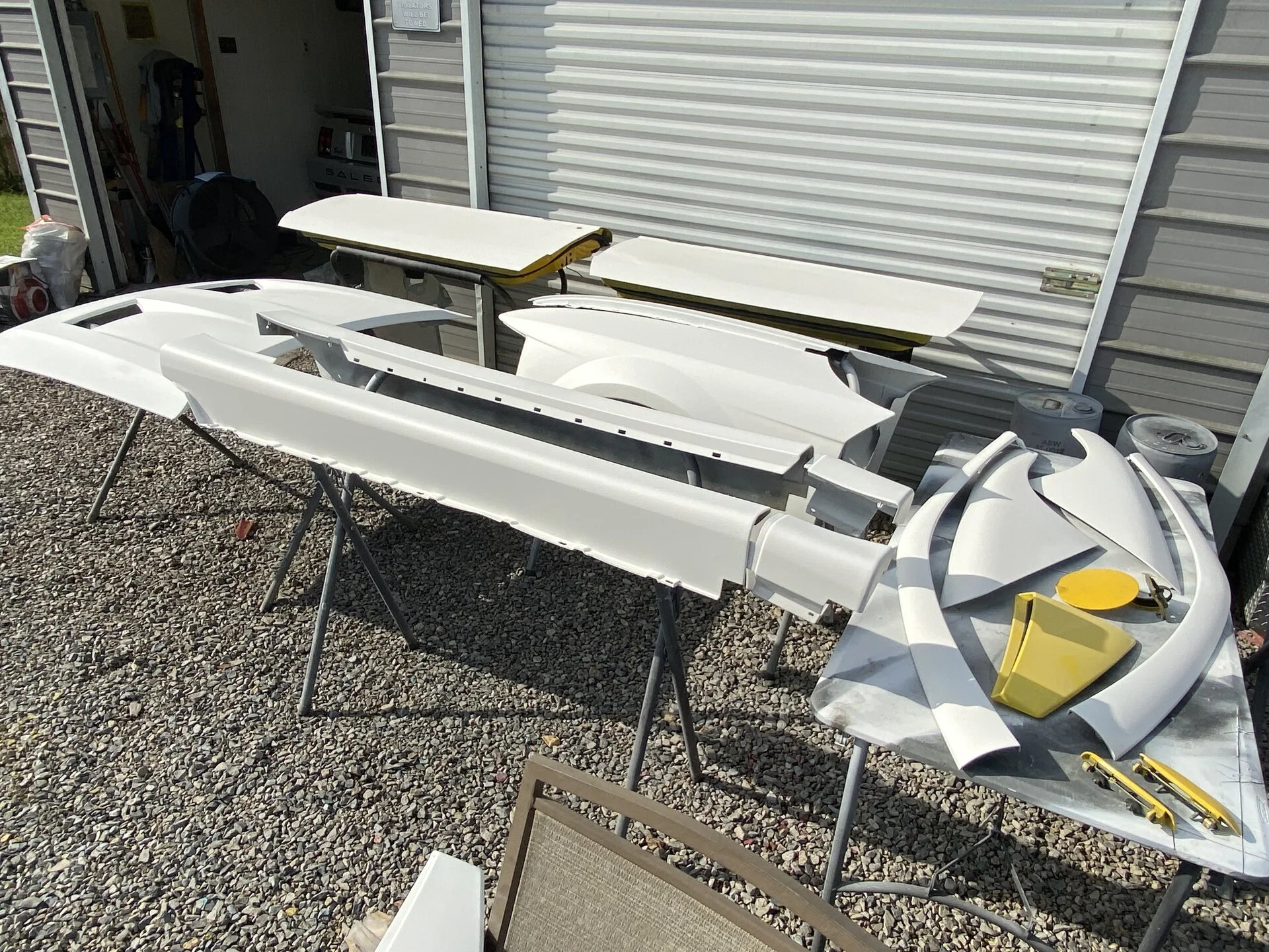

About 28 pieces and panels just to repaint one car. And each piece has to be perfected and looking like glass. Reassemble for mock up then tear back apart for paint. Then put back together without a chip or scratch. No wonder paint is so dang expensive.
