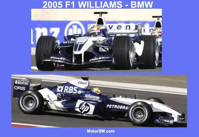

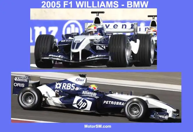

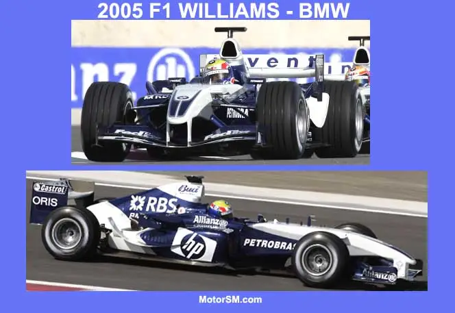

As you can see on a 2005 Williams the rear wing is mounted much lower than the top air intake, thus not in 'clean' air as you state.
A 68 Lotus F1 car, note the high rise wing just like the Charger.
Are you really this dense? The air over an F1 car travels over the pods and to the wing. TOTALLY different than A STREET CAR!!!!!!!!!!!!!!!!!!! Look at the pics of the F1 car in the wind tunnel I posted in a previous post. You will notice the flow being channeled around the cockpit and intake and to the wing. So, the wing IS in clean air.
