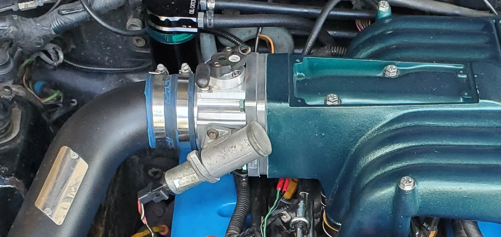

67mm opening on my explorer intake. Need an egr delete plate. Some folks use jb weld to plug holes. That's how mine was done on my 92 when I bought it. I didn't like the big egr spacer so I got rid of it. Had to use a spacer between upper and lower intake though as the throttle cable was thwarted by the coolant tube. Does clean up the look a bit though.
Also, the bigger throttle body isn't gonna do squat if you keep the egr spacer. Gonna bottleneck your air.

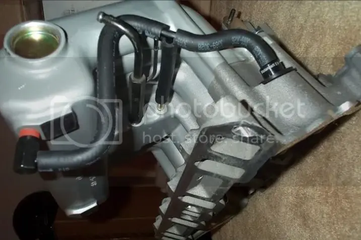

1:) Just need gaskets and hardware. The upper intake uses different bolts to connect to the lower. You will also need bolts for the TB as it doesn't use studs like the stock intake. Also, the vac hose configuration is also different. You will need to take the metal vac tube off the stock intake if it isn't on the cobra intake. Vac lines will route like this
The molded PCV vacuum lines are different than the stuff on the regular HO intake. Will the Explorer GT40 upper intake have the correct molded vacuum lines? If not, what is the best course of action to get the needed vacuum lines?
