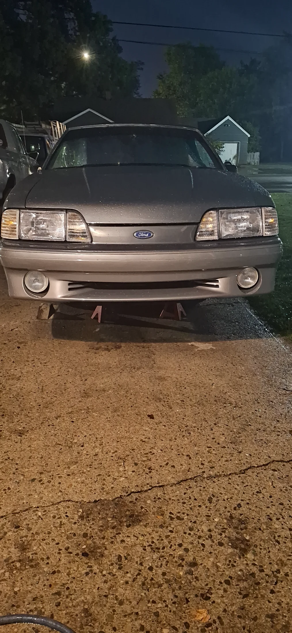

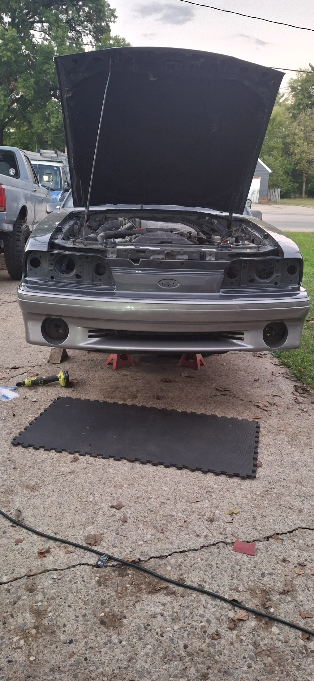

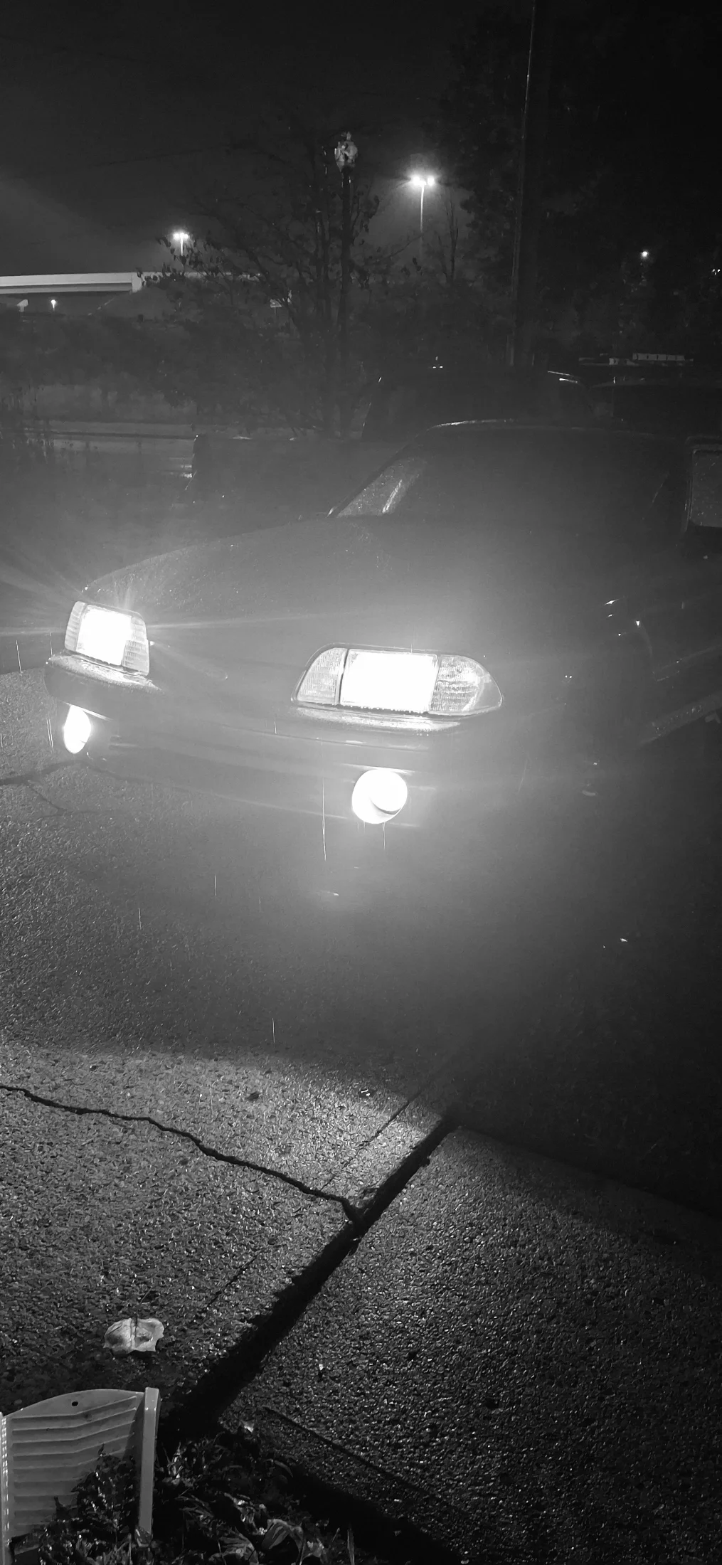

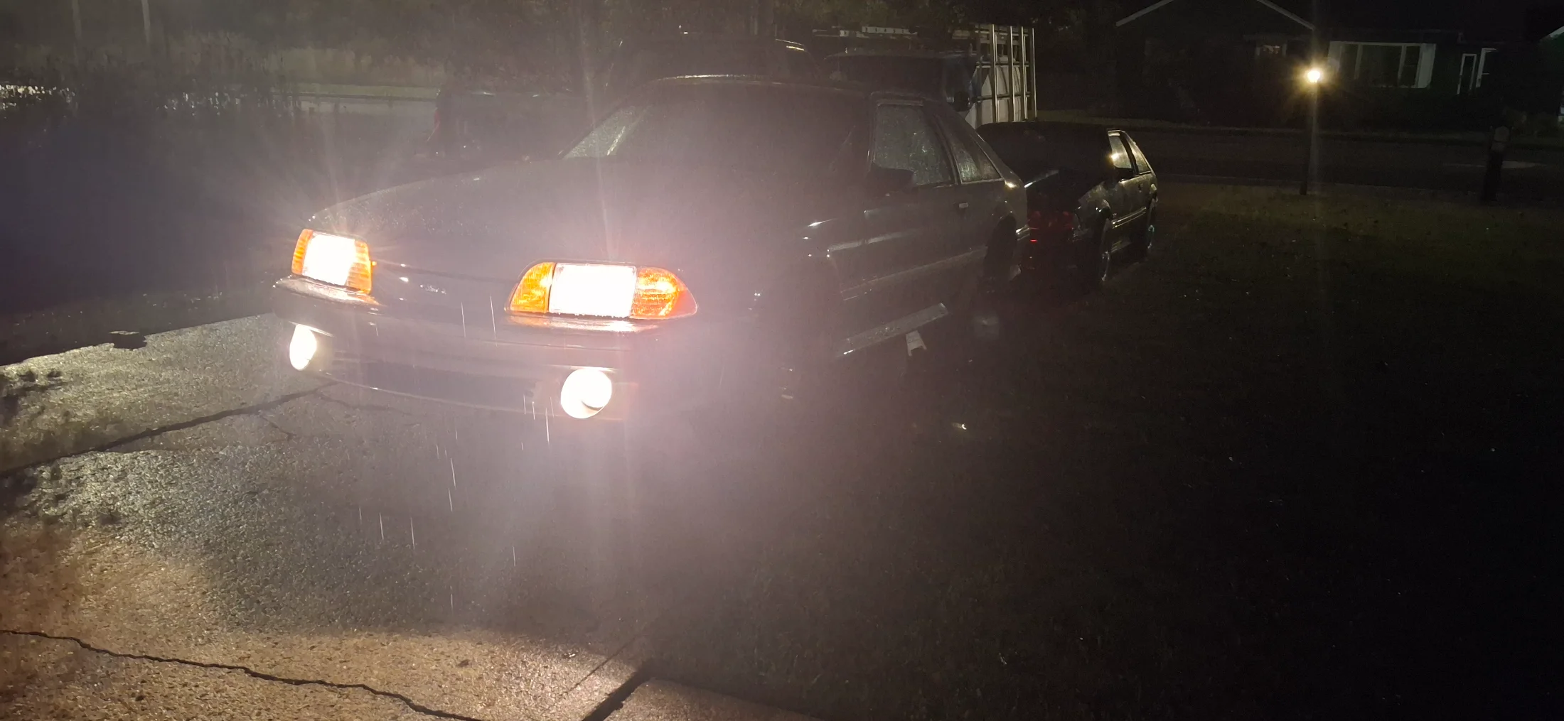

Monday night I installed the new headlight kit and re-installed the fog lights and put the Ford emblem back on the bumper. It is supposed to be getting a new windshield today. Today might be the day the wheels go back on and she can sit on the ground again.
