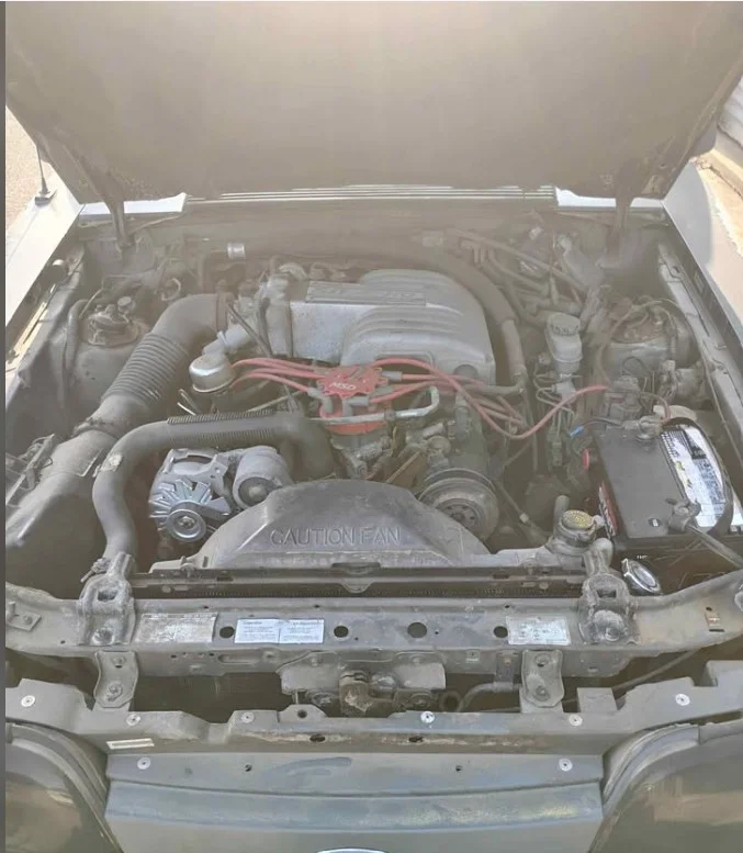

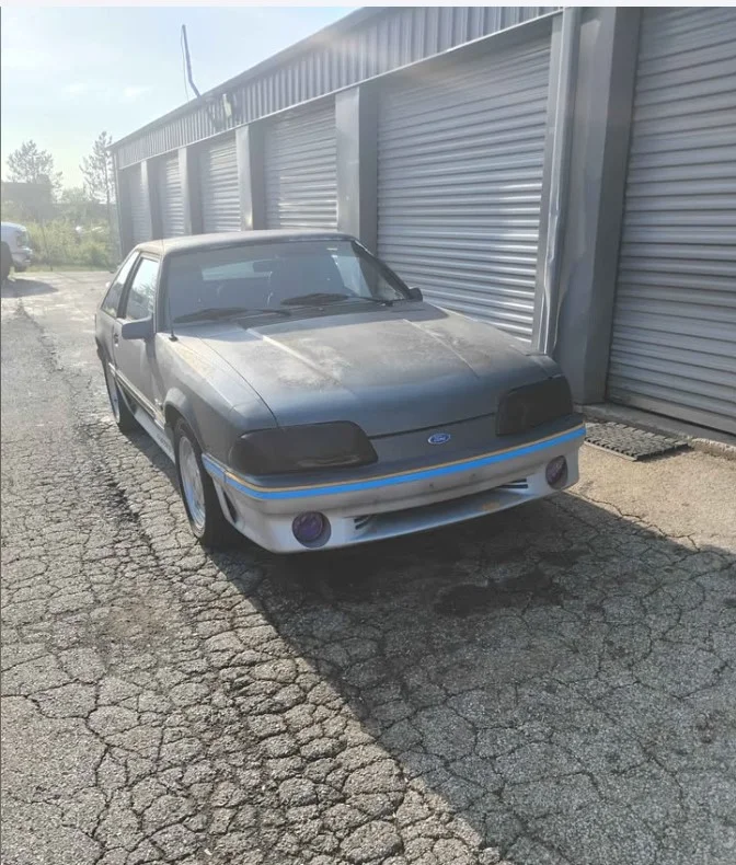

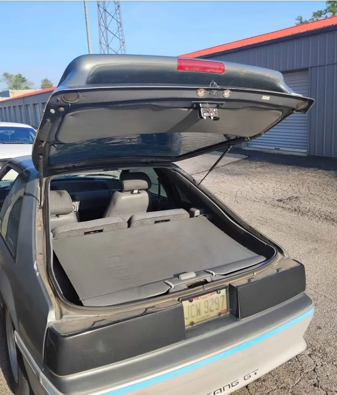

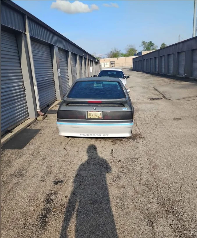

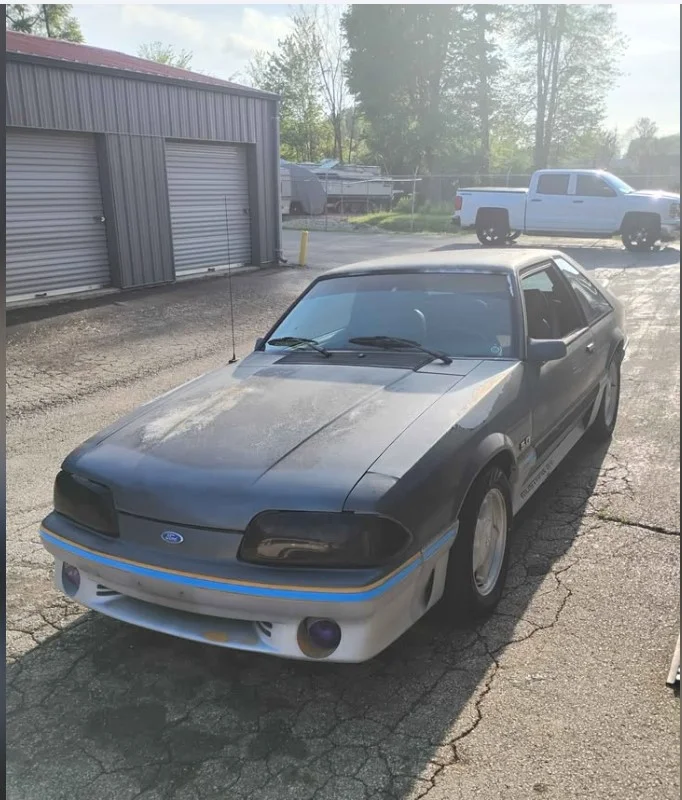

Sunday a friend of mine told me about an '88 GT. He said it was a "barn find" I went and looked at it. It is a diamond in the rough. The guy I bought it from bought it as a flip. He said it sat for at least 9 years. He got it running but it doesn't run well. I was able to drive it home but it definitely doesn't run right. It doesn't rev clean / hesitates, and occasionally backfires up through the air intake. When I rev it I can occasionally hear a pistion rattle. The car is pretty much stock from what I can see other than some questionable exhaust work.
The first thing I thought of was it had bad gas in it. The guy I got it from said that it ran out of gas on him and he put 10 gallons of fresh 93 octane in it. I was thinking maybe it has a bad or sticky injector. I was going to change the fuel filter, pull the spark plugs, look at the distributor cap and rotor. I cannot pull the codes because some DA put a 1990+ cluster in it and everything is jacked up relating to the cluster; I will make a separate thread on this.
What would you guys look at?

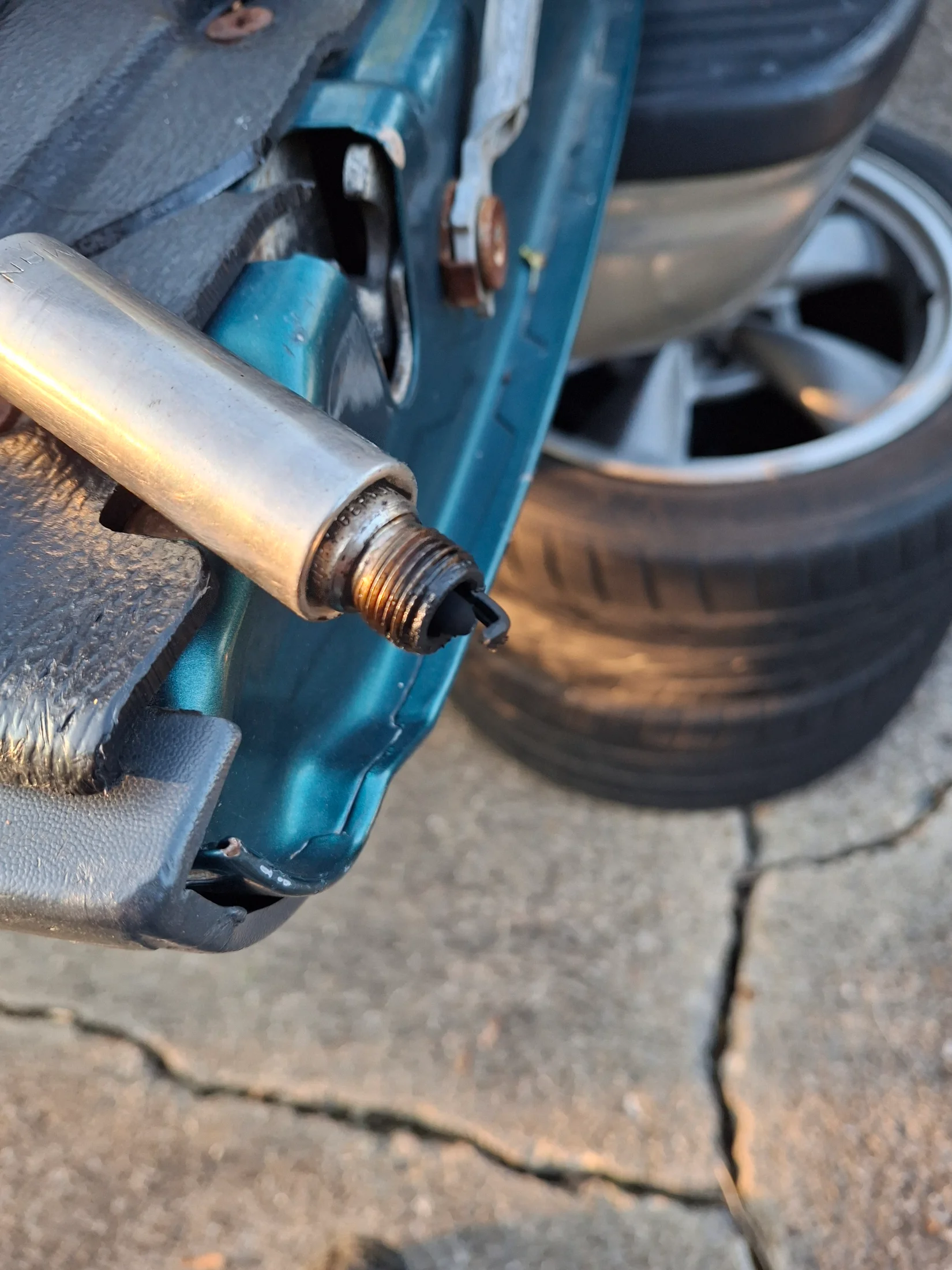

I bought a code scanner from Amazon, the one that displays the number of the code. I was getting ready to run the codes but I got to thinking about the timing. I cleaned the balancer, marked the 0 with a white paint pen and fired her up. I pulled the SPOUT chip and checked the timing. They had it at about 15* AFTER TDC! I changed it to about 10* BTDC and it's a night and day difference in idle quality and rev performance.
I also pulled spark plugs for cylinders 1, 4, 5, and 7. They were all pretty black, see pic. I didn't think to check the gap on 1 and 4 but I checked the gap on cylinders 5 and 7, there were at about .055

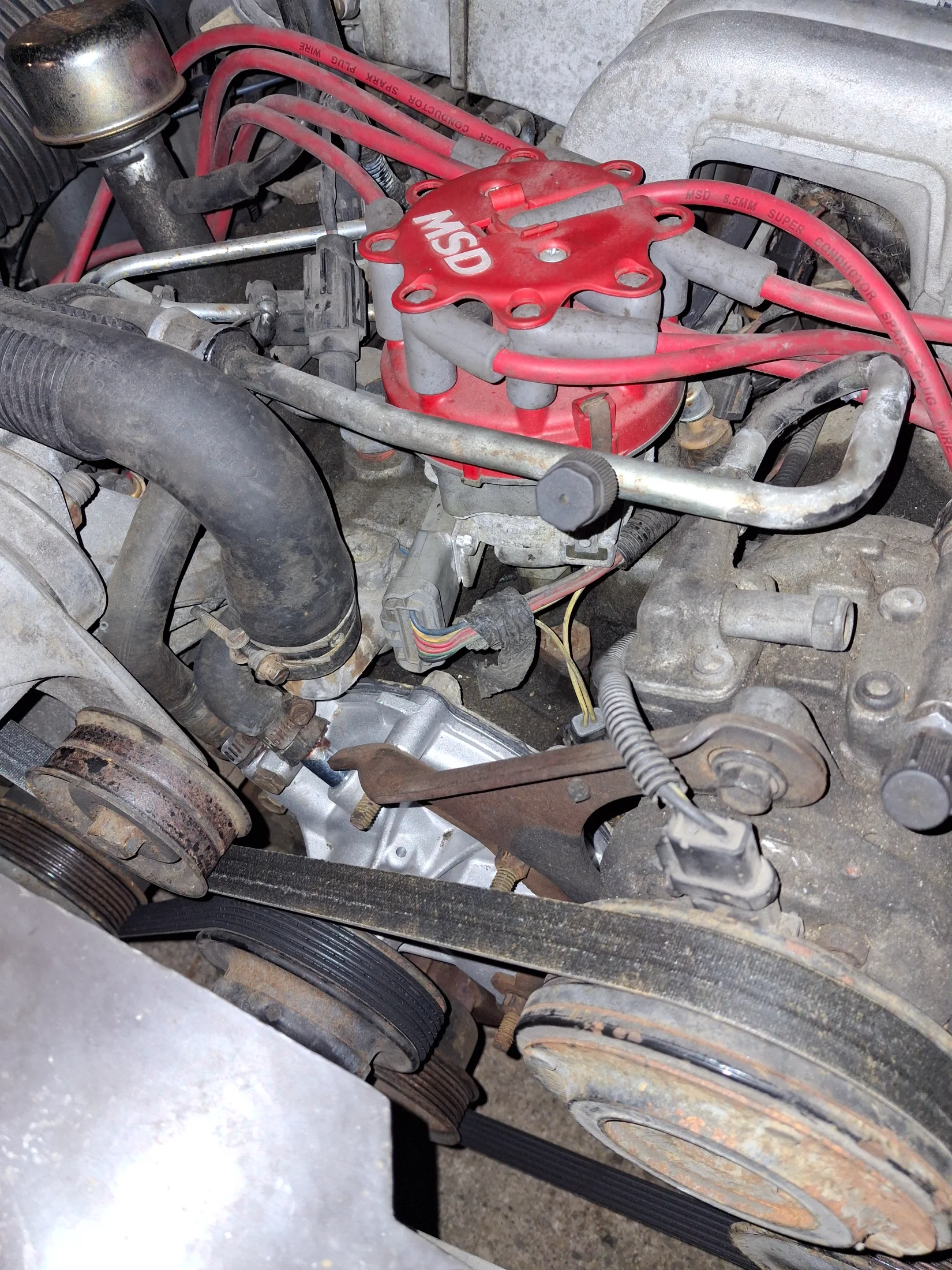

I do have a question about the distributor. I think it is a tooth off. I wanted to set the base timing at 14 degrees. It was tough to get it at 10 degrees. I think the wiring for the TFI is keeping the distributor body from turning far enough to get more than 10 degrees. I posted a picture of the placement of the distributor after I set it at 10* Does the picture tell you if it's a tooth off by where the TFI module is pointing? I think it is a tooth off and if I'm thinking properly it needs to be rotated one tooth counter-clockwise. What do you guys think?

Bring the motor up to TDC by confirming the piston is at TDC. You can do this by rolling the motor up to TDC according to the balancer and then backing it off 10 degrees or so. Put a small screw driver in the #1 spark plug hole and very slowly roll the motor to TDC. The piston will come up and stop then will stay there (dwell) for a couple of degrees and then start back down. Ideally would be to split the dwell degrees in half and that would be TDC.
At this point install the distributor where the rotor is pointing at the #1 spark plug wire post on the cap. I just mark where the #1 post is on the distributor cap adapter so the cap can be off when stabbing the distributor. You can position the distributor body as you see fit so that you can get enough adjustment for timing the motor.
