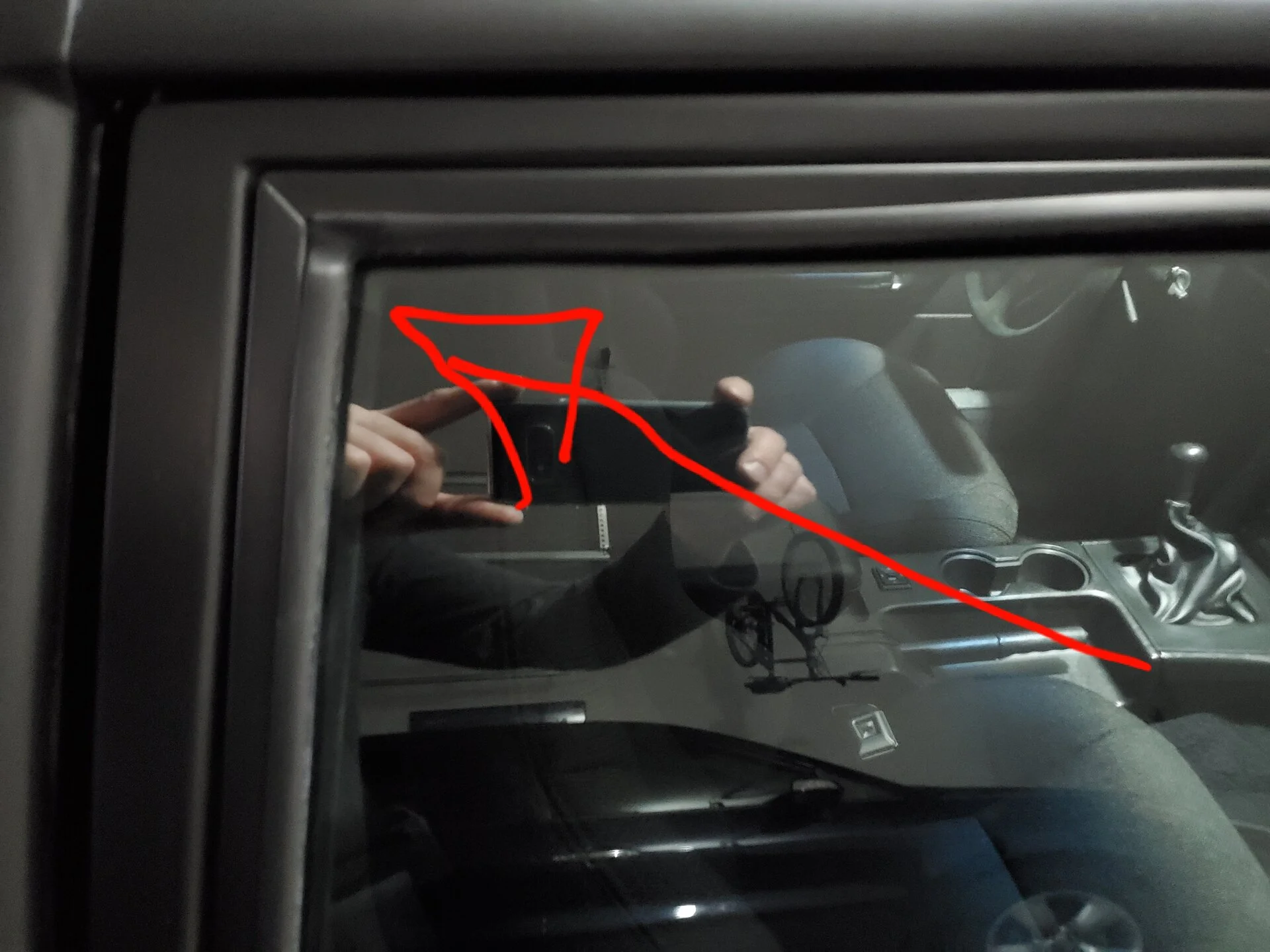

I went ahead and replaced the body to door weather stripping on both sides and the slight crack between the old weather stripping and window trim is now gone. But it appears I also had a second problem masked by the first. The passenger side window is slightly off kilter in the top left (when standing on the passenger side and looking at the window) which is causing wind noise at speed. My bushings and motor have both been replaced within the last year. Is this a simple fix by adjusting the prop rod and nut on the bottom of the door? Again, I have researched old posts, but no direct answer is given on this subject.
Is the problem the window is crooked in the frame?

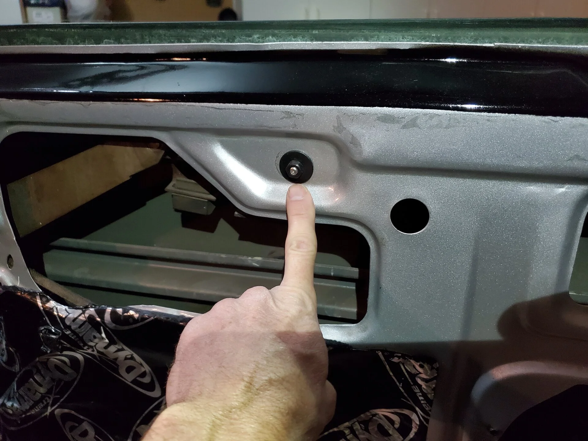

There are two adjustments on the coupe/hatchback models
Bracket assembly on the vertical rod that also is for front/back adjustment, not much to it.
There is a stabilizer assembly by the top of the rod that keeps the window from flopping when cycling up and down.

The window needs to move rearward by about a quarter of an inch in order to seal properly. The height of the window is fine.
Adjusted the window back by loosening the shown nut and moving it rearward about 1/4". No more air noise while responsibly traversing the death corridors of SoCal otherwise known as our freeways. Thanks again guys. I'm literally fixing minute, minute issues at this point.
