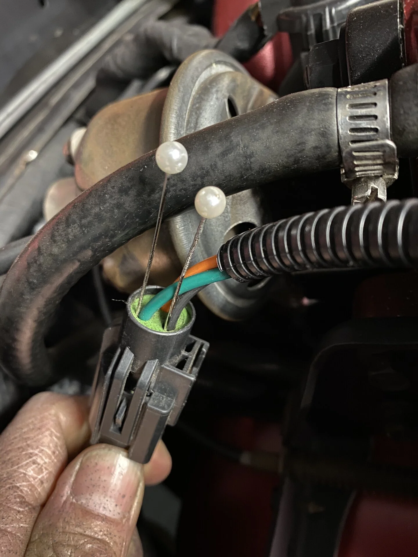

If you have a digital volt meter, it’s as easy as putting some pins into the wires, and then watching voltage as you move the the throttle blade.No, I definitely will. I'm just not skilled in TPS language and need to read up on it.

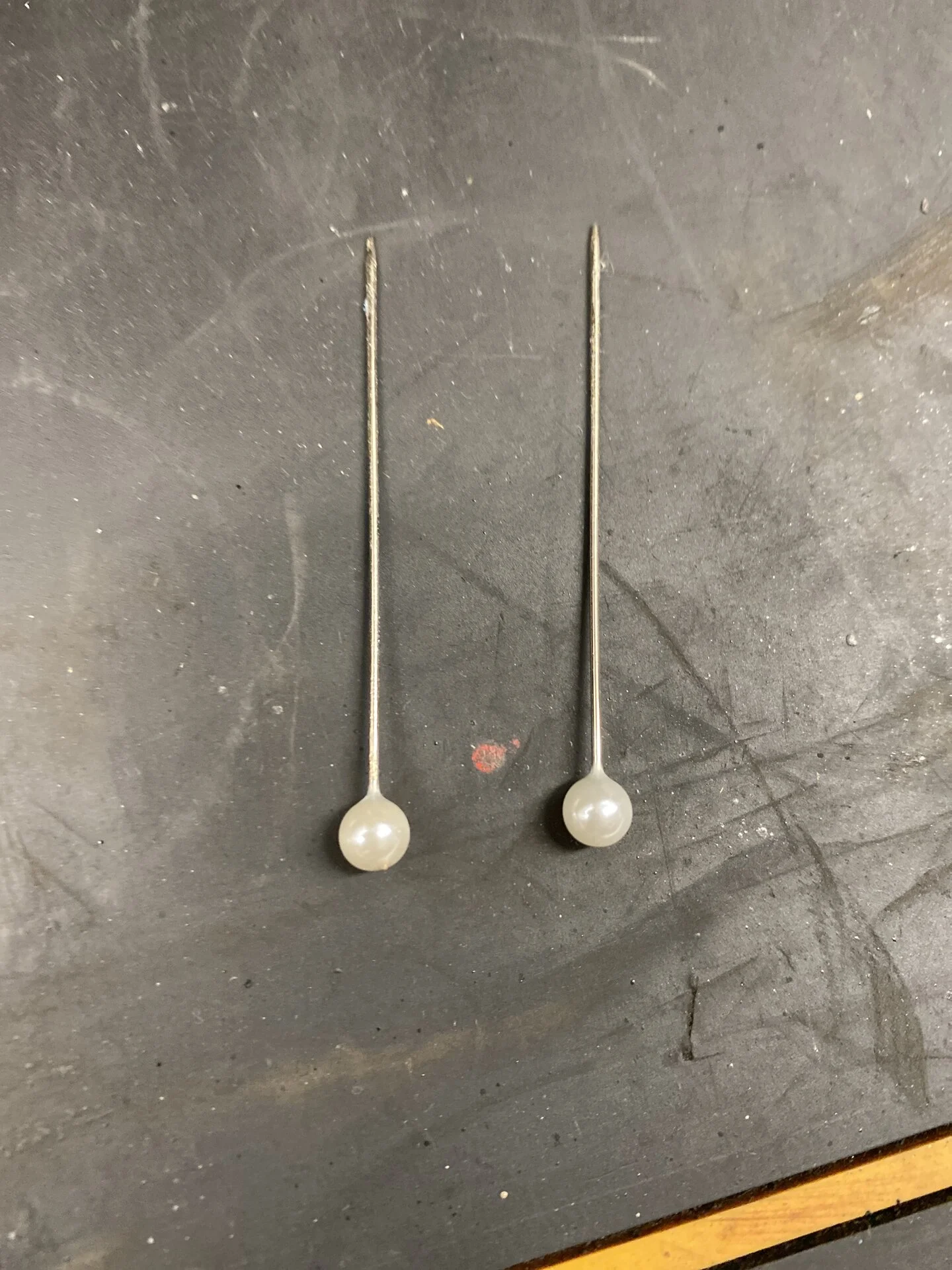

I use pins like these to put into the back of the plug, then touch my DVM probes to the pins.
