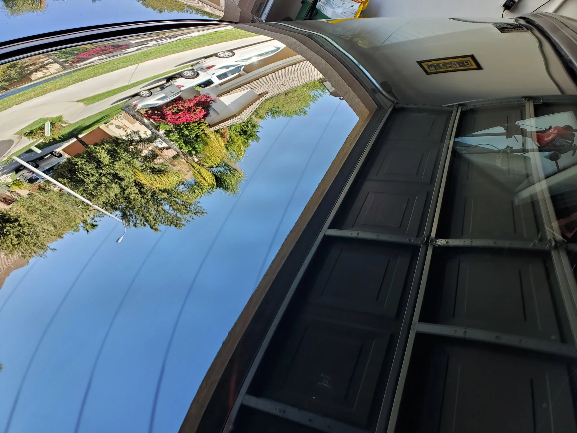

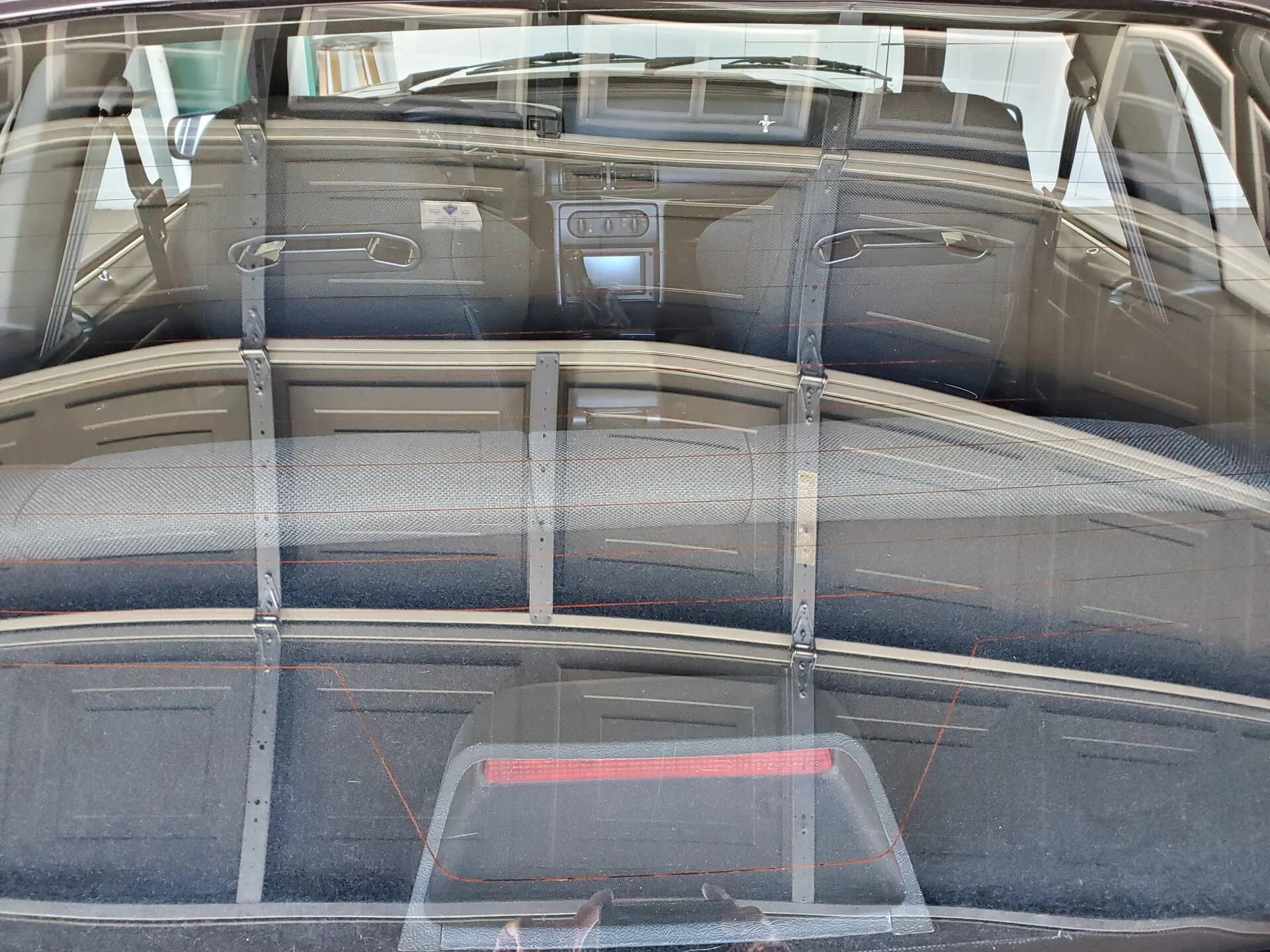

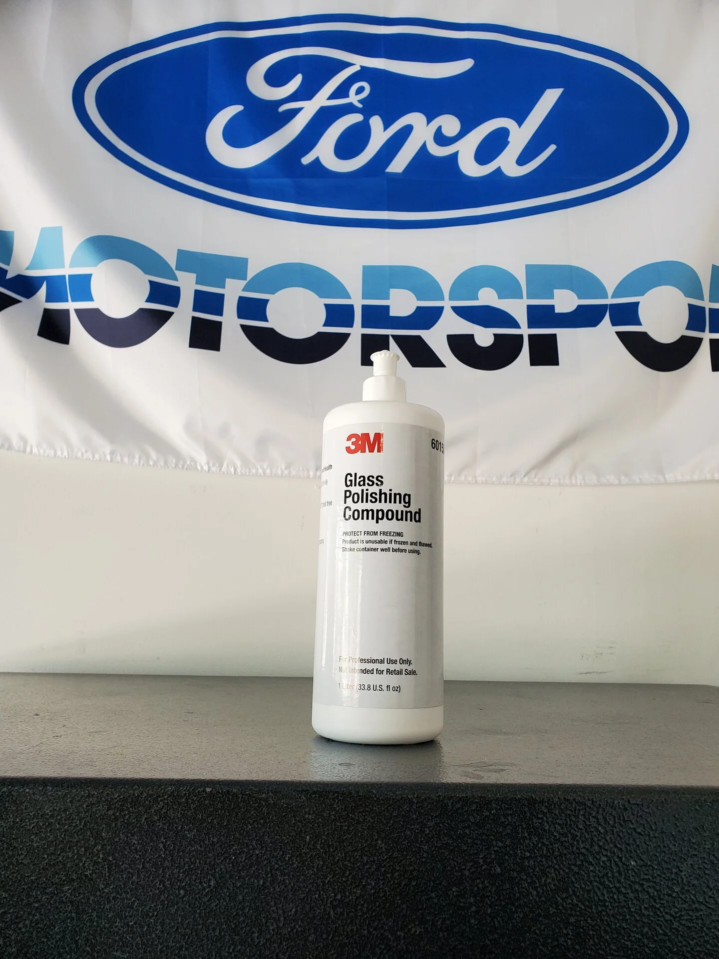

Decided to polish the exterior glass on my car because 30 years is a lot of abuse. Did my research and purchased 3M polishing compound. I'm very happy with the results. And by utilizing an orbital polisher it was actually very easy and straightforward.
