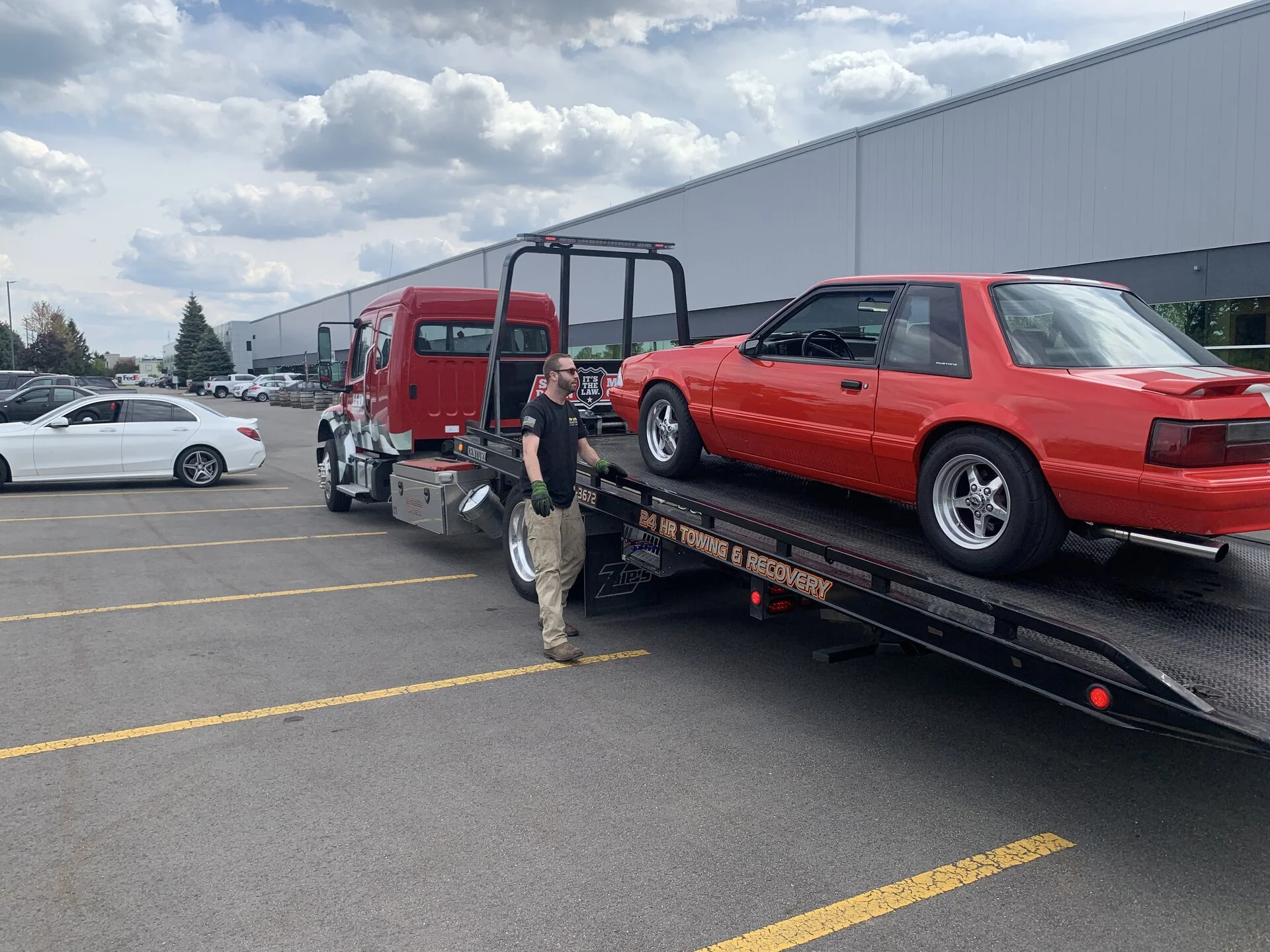

Got my car back today from the mechanic after swapping out the existing springs with upgraded Trick Flow dual valve springs. Turns out my longstanding two year problem WAS valve float. Car now pulls hard to 6250 rpm with no skipping or other engine drama. However, just 1.8 miles from my house my clutch pedal decided to go right to the floor. Not sure if I broke the cable or what happened. If it's not one thing it's another.
Sounds like my week! Same thing happened to my car with the clutch pedal. My car has the McLeod hydraulic clutch kit and there was a threaded braided line that just popped off, luckily fixed it in 10 mins once I got it home

Habu135 said:
Ya, I'm not really sure how that all happened.
Its those threaded rod adjustable clutch cables. They are only 3 layers thick and if you get any heat they separate from the inside out.
Do yourself a favor and get the one from MM that is made the same way as the original Ford.

Mstng93SSP said:
I am betting his long tube headers fried that thing.
Yes, I have long tube headers. I did notice a few months ago that the plastic had melted away where the cable nearly touches the exhaust header, but I wrapped it in some exhaust heat reflecting wrap. I suppose this was inevitable.
Thanks. I'll look into the MM cable.

Called MM today. They confirmed that the LMR clutch cable, which they identify as Taiwan made, are subgrade clutch cables and will fail in time with the proper amount of heat. I bought MM's universal Ford style clutch cable (MMCL-11) and the clutch cable spacer kit (MMCL-17) which purposely spaces the cable away from the bellhousing to ensure no unintended touching and heat transfer. I'll finish it off with a protective heat resistant sleeve and hopefully won't have to deal with this ever again.

I installed the MM clutch cable yesterday. You get what you pay for and the MM one is leaps ahead of the LMR clutch cable. It's good to have a road worthy car again.
