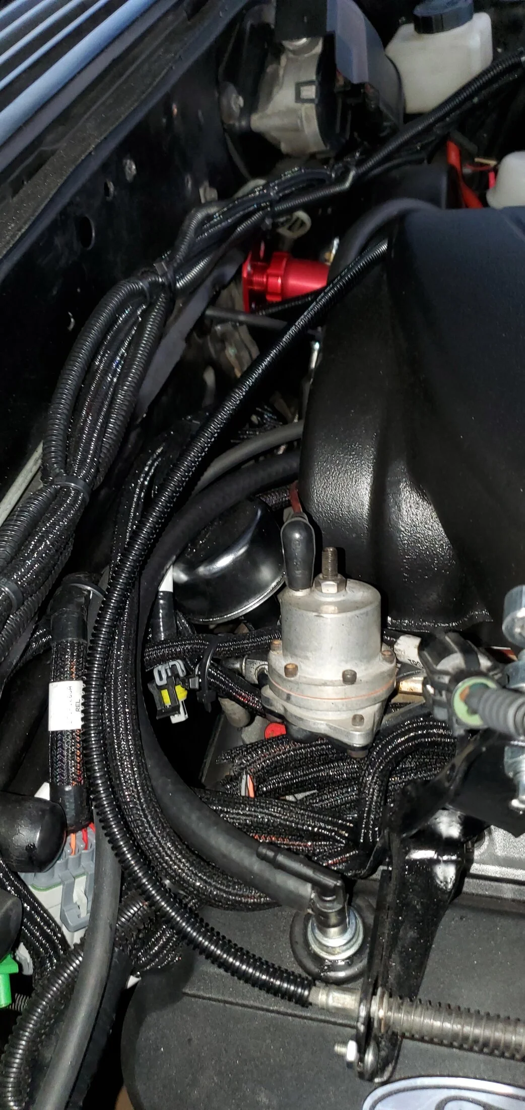

Ford Performance Z2363 engine and T-56 transmission are finally installed. Had the car tuned today. Made 375 hp and 357 torque and I suspect it has a bit more in it.
Overall the car hauls ass, BUT spews oil out the rear breather onto the trans and exhaust at high rpm. Not a sustainable predicament. So now I need to run some ventilation via a catch can. I was planning on running a line from the rear PVC behind the intake and from the top of one of the valve covers (two lines) to a catch can. Any suggestion on parts (90 degree elbow and catch can) from guys who have dealt with this situation?

I have a Ford Performance breather behind the intake in the traditional PCV location. It is a standalone with no line running from it. I also have a PCV in the passenger's side valve cover with a line that runs to the upper intake. See attached photo.

Naturally aspirated 363. PCV is operational and has the metal screen in the hole at the rear of the engine.
Please read what I wrote and view the photo. I spell out the problem pretty thoroughly. I'm sure someone here has experience with resolving this problem.

The PCV, which is located on the passenger's side, is running via a single hose to the port on the underside of the intake. I'm not sure what you mean when you say is the baffle intact. The only item venting preasure is the baffle in the . The PCV
General karthief said:
then you say:
this is my opinion but this is possibly the reason, unless you have an excessive amount of crankcase pressure or is adding to the problem.
Oil 'splash' traveling to the back of the lifter valley is being pushed out the breather, that said, is the PCV hose hooked up to vacuum by itself?
Is the oil baffle under the intake intact? Have you checked for excessive blow-by?
The PVC is hooked up to vacuum under the driver's side intake. The baffle toward the rear of the engine is intact, but the round shape style with numerous small holes underneath. I have not checked for excessive blow by as it's a new engine.
It seems the fix is to run a catch can with an unobstructed line from the rear of the engine and passenger's side PVC. I think I'll have to remove the existing set up and install a 90 degree bend or baffle with an exiting line to the catch can. This seems to be what most guys with the larger sized engines are running. Thoughts?

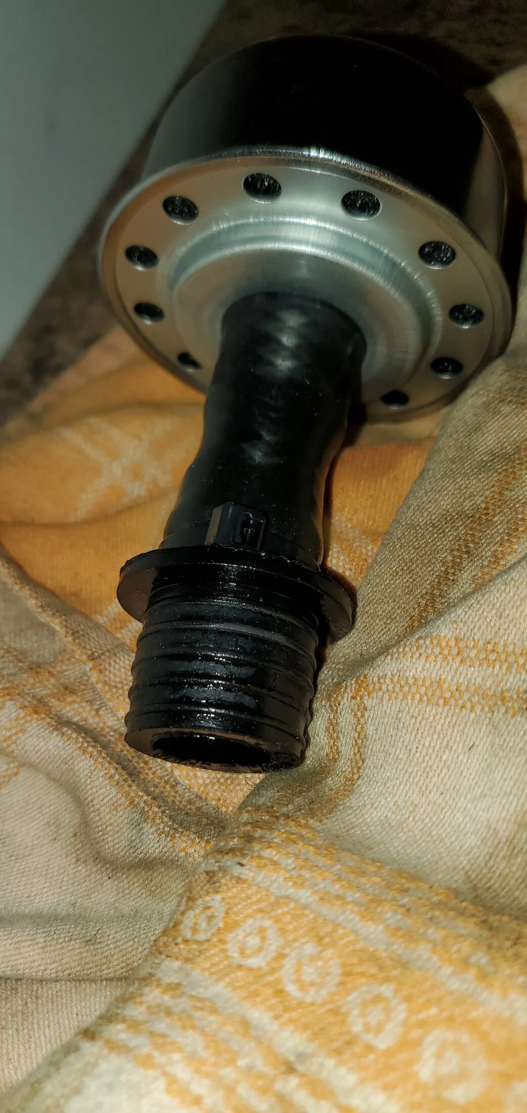

So, I checked and there is no metal screen and housing in the existing PCV port. I'll need to install that.
The current baffle I have, see attached photo, isn't giving the crank case pressure anywhere to go due to the small holes. This is what I had in the rear engine PCV hole and which was allowing oil to spit out onto the transmission and exhaust.

The pcv screen will help. The baffle is actually on the bottom of the lower intake and prevents oil from splashing up the pvc hole. Like I said earlier, running a normal pcv config may solve your issue. Then you potentially won’t need a catch can.
There’s a million ways to do this. The “correct” way is to run the pcv system as intended with a sealed catch can inline between the pcv valve and intake. Especially since you have a NA street car.
