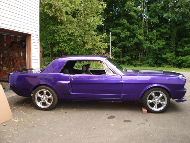

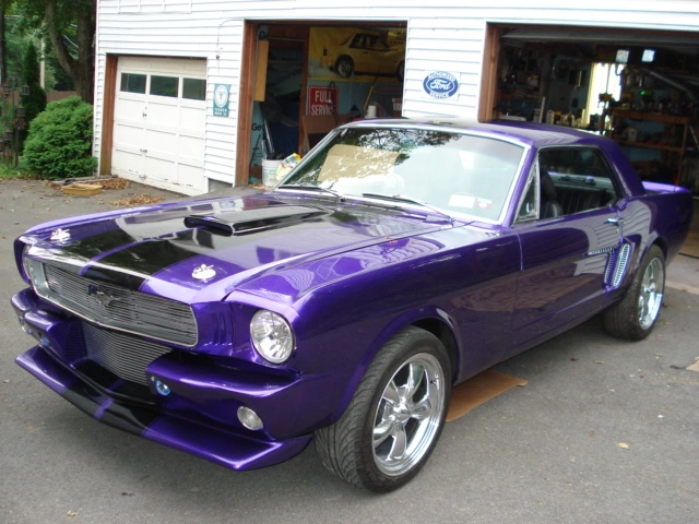

ok so i found another wheel fitment guide on mustang barn or something like that, but it states that the 17 x 8 with the 4.5 offset will actually fit, so i will be ordering the wheels i checked out tonight as soon as i get home from work.
ok so my wheels came in and so far so good. i ended up with the 17x8 up front and a 17x 9.5 in the back and looks good so far but i need to get some stock shakles for the rear since who ever had the car before me put some long 4x4 looking things with some ole jacked up air shocks for that 70s 50 series look on it but now i have a slight issue with just the front driver side tire rubs the fender slightly but i dont have that issue on the passenger side?

The 9.5 fit good with no rubbing but I will probably have to roll the fenders once I lower the car a ill more since it feels to high for me still. But as soon as I can figure out how to post pics from this Mac computer I will post some pics.

We haven't forgotten about you, Scrasauge. Still hoping to see pictures. And curious to see how well the 9.5s look and fit back there.
I have 17 inch with 4 1/2 backspacing and only had to cut a small piece out of the bottom of the front fender since they rubbed when I turned. The back one fit great.
