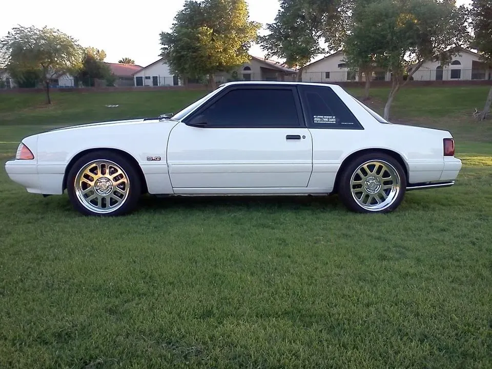

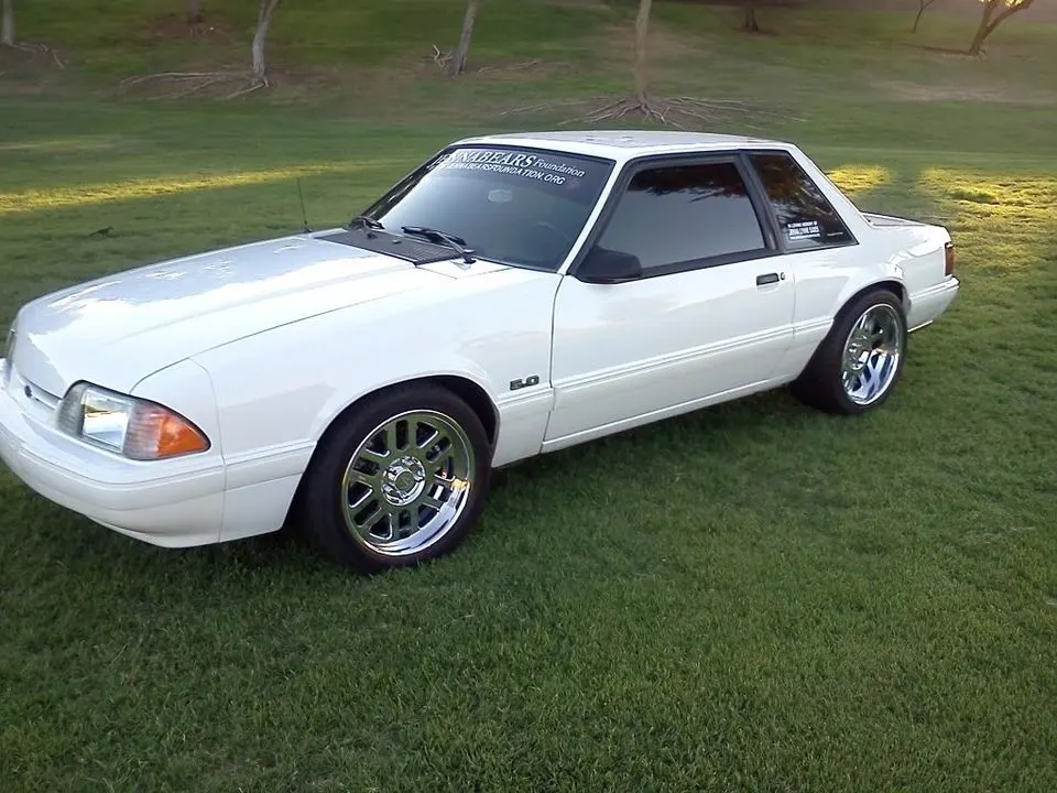

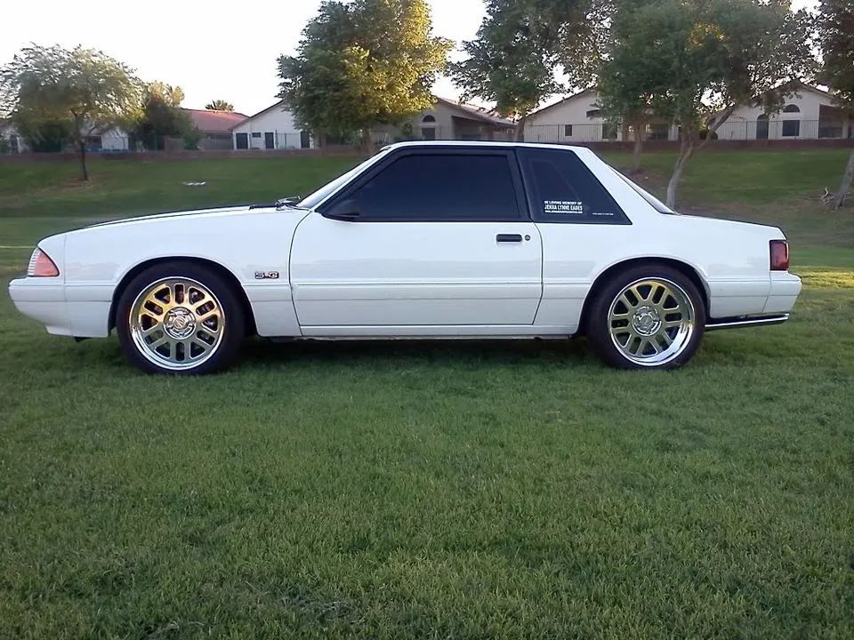

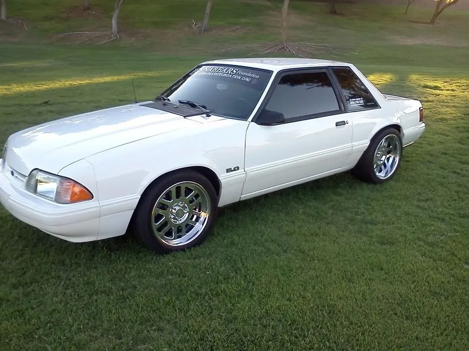

Not everyone's style, but I am glad to see a DIFFERENT wheel on a mustang.
Bogart Eliminator's-6061 Billet Aluminum
18x8 255/35's
18x10 285/35's

Looks good. Very unique. Any fitments problems? Did you need to get the BFH out to clearance anything out back? Any rubbing up front? What’s the offset and/or back spacing of the wheels?
I don't normally like the look, but I think in this case you're going to need a set of clear corners to go along with those new shiney wheels. A pair would really set them off. :nice:
Thanks guys!
No rubbing, but the quads are gone, and fender lips rolled.
5.68 if I recall correctly is the front BS (have to look on the paperwork)
6.50 bs on the back
These are the first set for a Mustang, my car was used for measurments.
Hmm, maybe it needs a little more tire to fill the wheel wells, not sure. Definitely some very nice wheels though. Any pics from the back and/or pics on concrete/asphalt?

Thanks guys!
NikwoaC, what size tire do you think? I got these tires used just to get me rolling and do plan to get new ones when funds permit, although not sure how much more I could do w/o rubbing and fitment issues.
I will get some pics from the rear soon
Bogart said these wheels in this size will go for 2300 a set....thank goodness I only paid a lil over material cost since this was the test bed car...otherwise that is far to rich for my blood!

My wife asked for the biggest lip possible, and since it's her car she got it. I love the stagger'd look personally.

Little too much bling for me, but they look ok.
You probably aren't going to find a solution for the tires on the rear.
This is why i tell people not to use 10 inch wide rear wheels.
You need like 315's to properly fill up the whole rim, unfortunately they don't fit all too well on a fox.
absolutely PERFECT! love the wheels! its a great look and a refreshing change from " the norm". ive tried many combinations of different looks on my coupe before deciding on the ones i currently have. if these go into production i would ABSOLUTELY be first in line for a set!.......or second in line obviously!
