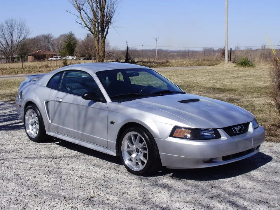

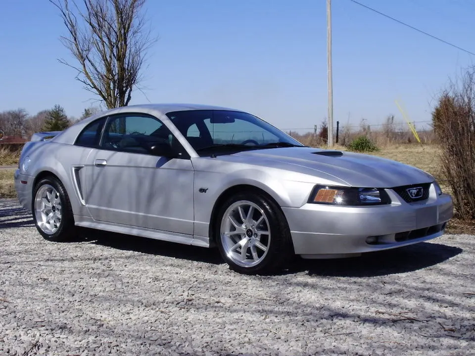

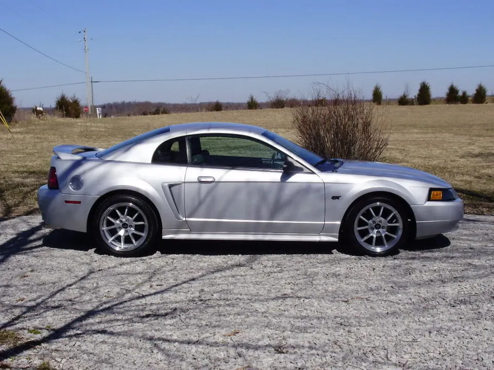

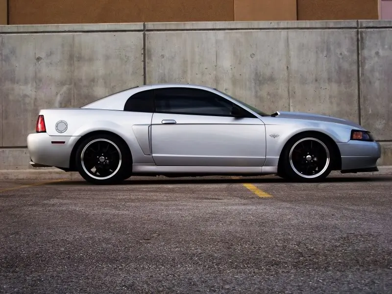

Eibach Pro Kit here with Saleen 18x9/10's. BFG KDW2's 255/40/18 front & 295/35/18 with 0 issues rubbing. I went with the 255 front as opposed to 265's because a narrower tire is less likely to "railroad" down the road. The 255's follow the road ruts pretty good every now and again. It screws with me on occasion if I haven't driven the stang in a while.
Here were my 17 Cobra R's for comparison. Can hardly tell any difference.
