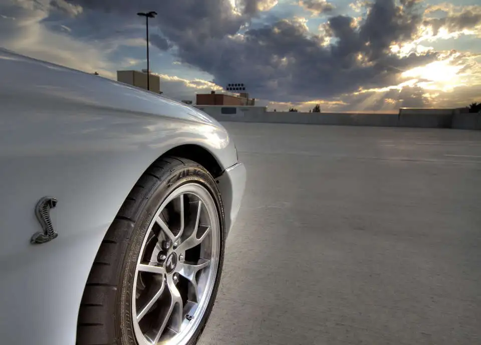

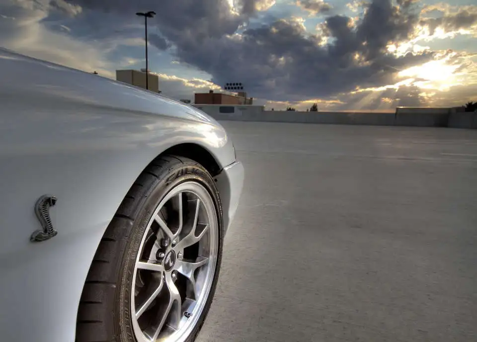

I'm running 275/35/18's up front with ZERO issues, and its been lowered almost 2.5"
Here's a pic for those that think they bulge....

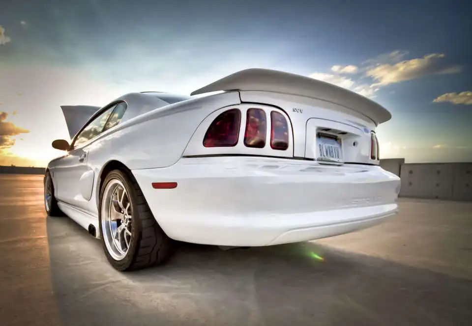

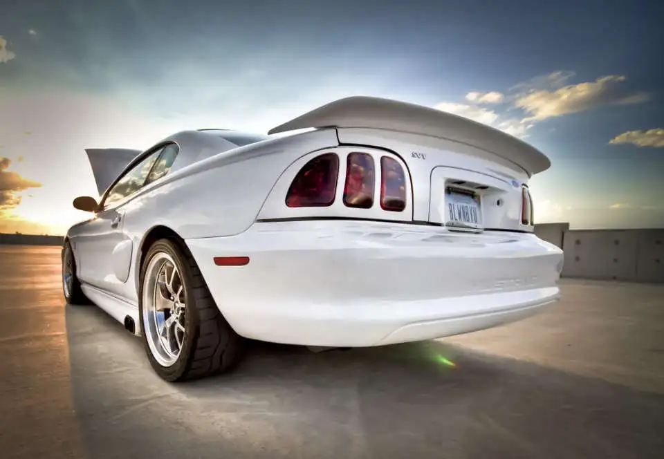

I'm running 315/30/18's in the rear and wouldn't want any other size either on a 10" rim..
