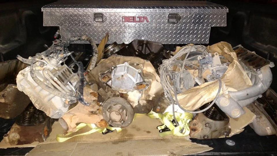

I had a 289 when I was a teenage so I would love to find one. Same 302 parts will fit and it is more of a nostalgia thing for me. The issue is, every 289 I have found seems to be expensive as they came from a K code mustang that must be the only one of its kind due to the price. Fast forward to a few weeks ago and I found a 351W from a 1996 Bronco. It had hydro locked and bent two rods. One of the piston skirts might have kissed the crank but I don't see much damage. For a complete engine intake to oil pan, minus accessories drives, I paid $50. Now I know I will have some shop time into this motor but I feel I can have it up and running in a shorter time span and a lot easier as well.

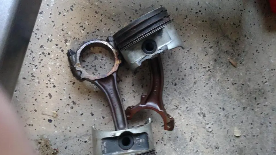

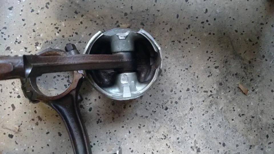

Assessing the motor:
Bent rods
broken piston skirt
Cylinder and crank where piston skirt kissed the crank and broke. Crank looks fine.
These will all go to the machine shop to get checked out and I will freshen it all up. I plan on setting it in the bay at least so I can build the motor mounts.

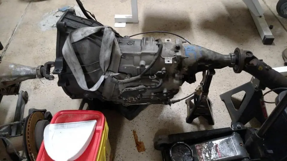

Came with torque converter and a yoke out of a wrecked '02 vert with front end damage. I took the engine plate and it matched all the bolt holes and it is a two bolt starter (thanks 95bluestallion.) They have to drain all the fluids from the cars so, unfortunately, their method for doing this is to just drill a hole in the pan and let drain that way. I am letting it all drain out now (as seen in the photo) but I will pull the pan and see if I can plug weld it. I need to get the motor mounts for the motor and tranny before I start to make the mounting brackets. I want to use the stock rubber mounts and build from that to the frame and cradle.
