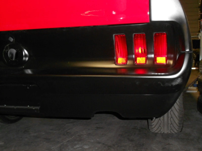

I got a new set of taillights installed. After a lot of trimming on the new rubber taillight to body seal they finally fit.

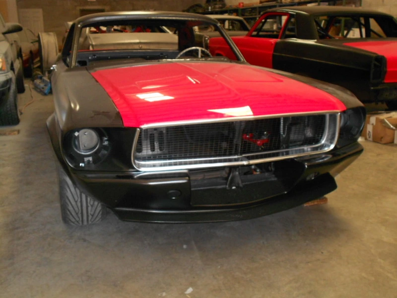

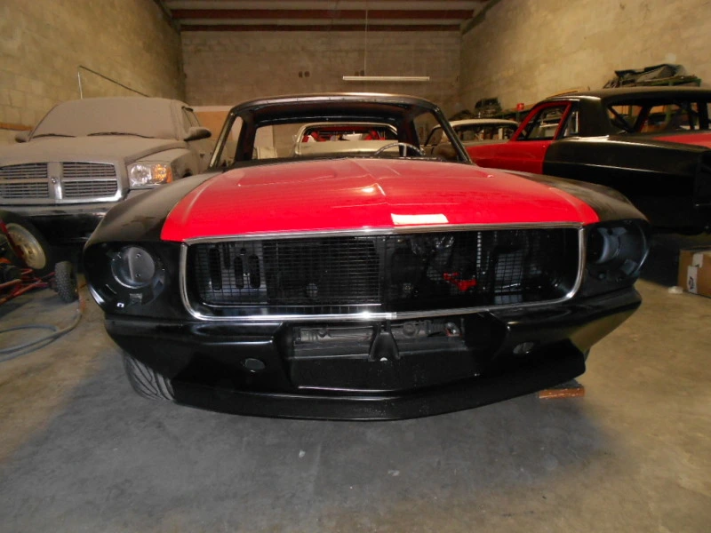

YES, the black looks great!:nice: What did you do to trim the rectangular spots that the grill chrome studs go through, or did that Dynacorn grill not have them? What was your source for the grill?

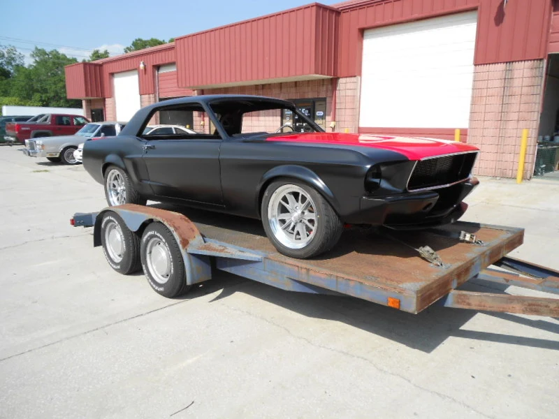

We are now a Dynacorn dealer so I order a 67 grille and Brian drilled out the spot welds that held the braces shown on the page before.

You beat me to it!:D Upon some research, I was guessing you started with a 67, not 68, grill. Very COOL! That's very close to what I'm looking for, except I want to use the 68 horse & corral, without the larger chrome surround. When I have the $$$, I'll order that grill and any other Dynacorn stuff I need through you, unless that's a pain for you. I assume you don't stock much of their stuff, but if I order from you, they simply drop ship to me? Again, any chance of pics of that Shelby? Sorry to be a pain, but that car would be MINE, in a different life.:banana:
