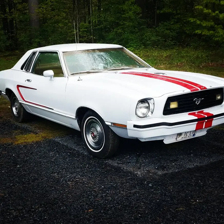

Hey all.New, old mustang owner, picked up a 78 a few weeks ago and have been slowly getting her road worthy again.
Has the V6 in it and have been toying with putting a bigger engine in. No idea where to start, what to look for in a new one. Can anyone start to point me in the right direction? Thank you!

Kgeek, That looks like a very clean 78. You should have no trouble finding a 302 and a C4 for it. Easy swap after that. Buy a rebuilt duraspark distributor from checker pep zone for a 78 cobra then you can use just about any older 302 for the swap. Personally I think the 2.8's were cool. Only thing that ever went wrong with them was the timing gears and the waterpump. OEM cam gear was phenolic and problematic at best. Free flowing motor not much trouble to fix.
