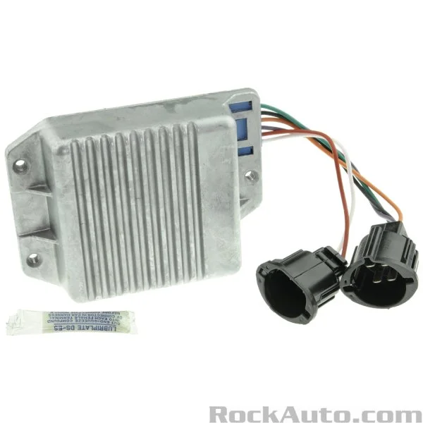

One thing I'm still unsure about is, if this will work with what you have. Because as far as I understand this D4028 is without points (you asked explicit for points in the beginning) and will need the control module in your car. If you still have the stock setup it will work. You can identify if there is this plug with 3(4?) wires in your car and some of them should be connected to a control module which looks like this:

I'm all kinds of confused - is this thread is about an engine swap but also about points for the 2.8L? :) If your distributor has points, then it's been swapped in from a 74. Anything from 75-78 uses the Duraspark ignition and you'll find the boxy-looking module @extra_stout has posted above mounted on the driver-side inner fender with a set of wires (3 I believe) going to the distributor.
The points distributor has only the ground-wire coming from it and going to the coil - the connector plug looks similar to the one in the picture above but it only contains one wire. If you just need new points, get them for the '74, RockAuto has them for about $5.
