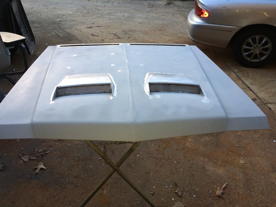

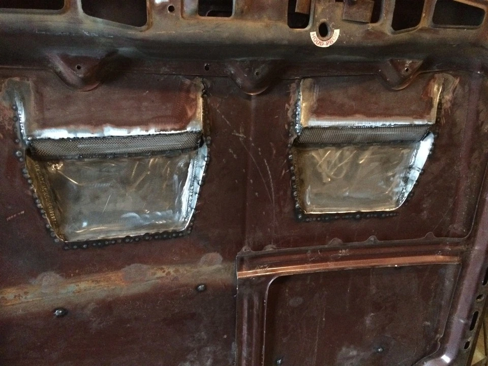

Whether or not you are a fan of the "steel clams" that are the latest revision for the hood scoops, today they became reality.
There is still some welding left to do, but they are permanent as of this update.

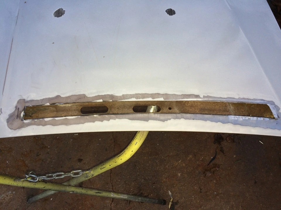

They are indeed open. Water and air will get in. The holes you see at the back of the hood are carry overs from Gila hood V1.0. I figure if I'm letting air into the engine compartment (that isn't necessarily going through the radiator, coolers, and condenser), it will benefit me to have a way for all that hot assed air to get out.
When you cut this part of the hood and expose the outer frame it becomes apparent that this part rusts because it cant be painted. Now that it's open i'll attempt to rectify that.
Now I know you're thinkin......Mike, what about cold water getting on red hot glowing turbo components? To which I'd say I know that's a potential problem. But,......The hood scoop opening is well in front of the turbo, and that rear mounted vent,(while directly over the down pipe) will get blocked so air can get out but drain water will divert to the driver side of the hood. The primary design consideration is to help the thing to run cooler when it's 98 degrees outside, and 85% humidity (typical Alabama Summer). If I get caught out in the rain, I'll be one of those guys sitting under an interstate bridge until it stops.
So,, if you were a fan of the old school Cyclone style scoops,..I hate it for you.
Now that I see both scoops on the hood, I like them better. It's a good look, Mike.
Well see there you go,..... One poor little clam by himself gets boo'd,... Add his fraternal twin brother to the room,...and we got a party.
It may be time for a turbo blanket to cover the hot turbo section...
That would at least protect the turbo itself from the rain.

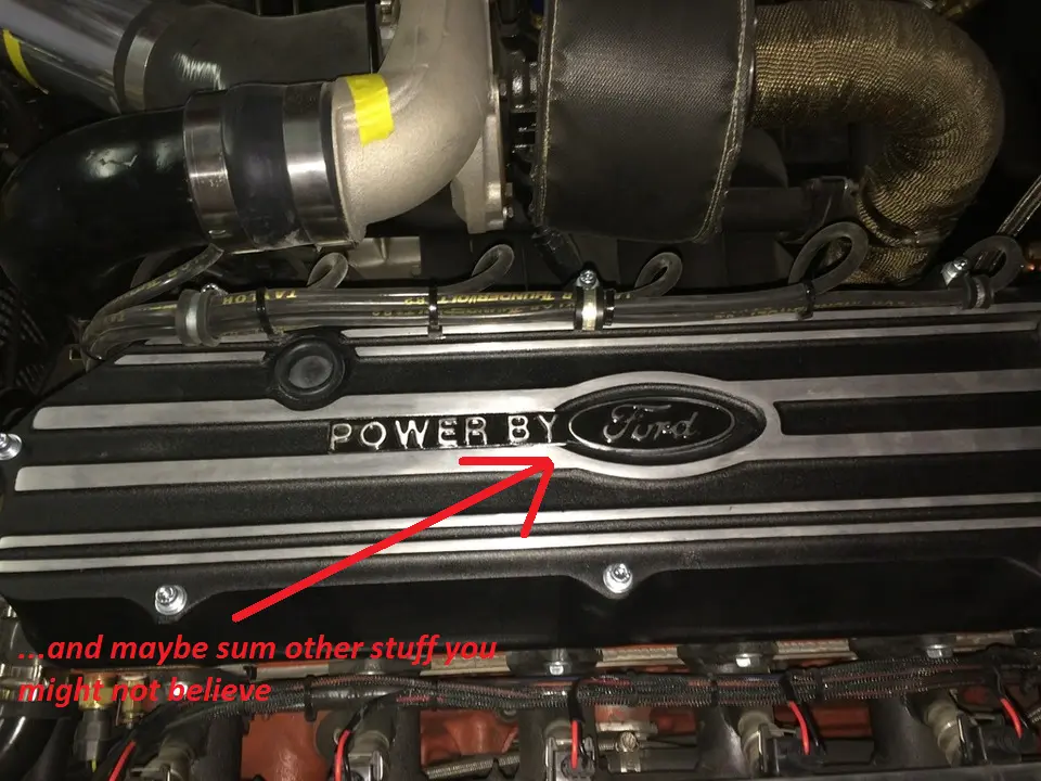

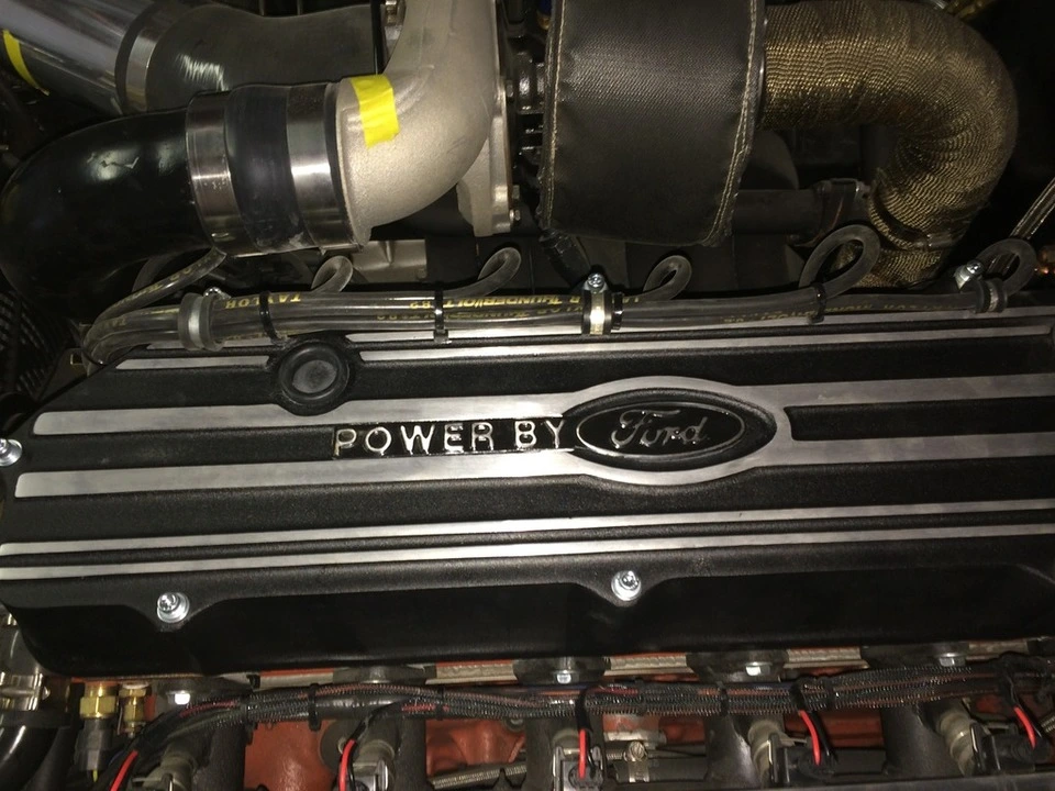

Can we get a "Mike" logo to replace the Ford logo? Power by Mike would be much more appropriate in my opinion :cheers:
I share a similar sentiment, While I don't like the new scoops as much as the prior scoops they do look far better commingling among themselves as opposed to being left out in the cold all alone.
Maybe if I had them wrapped in green metallic?
No,....I have truly bitten off more custom work than I can chew already.
