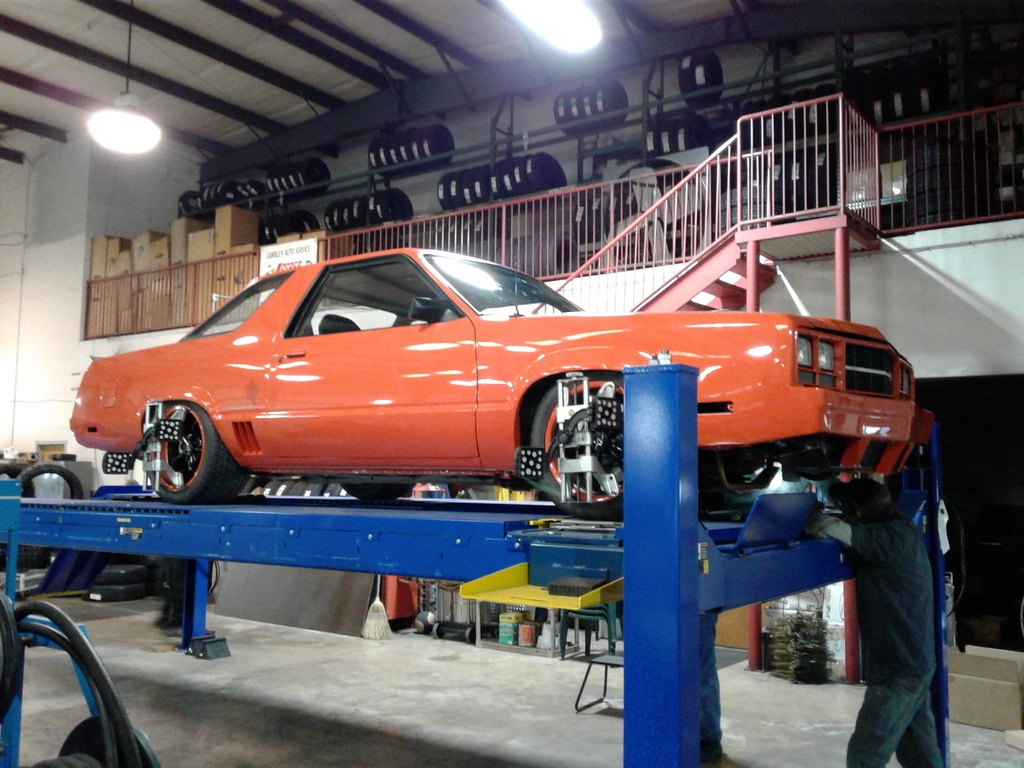

Well hell. Took the car to have it aligned, had to pay 80 bucks.
For the guy to tell me that I was almost dead on.
Perfect. Nothing like throwing away 80.00. So gentlemen, for future reference, a string pulled tight from front to back, a torpedo level on the rotor after you've jacked up LCA, and two guys passing a tape measure between the front and back of the front tire will get you so close you don't need to spend the money.
The toe was a little off, but the camber was at negative 1.4 degrees........ on both sides. It was like I planned it that way.
The alignment guy asked if I wanted to leave it that way, and since I am entertaining the notion of maybe taking the car to the track one day, I told him to leave it. Besides, the total mileage that the car will see will probably be under 7500 annually, so I'm not too worried about wearing the tires out.
