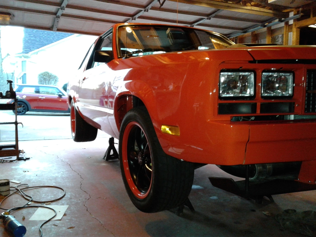

Dammit, man! That sucks about the tranny, but damn that is one freaking cool angle of the Monster. Those back tires look like steamrollers up in the air!! That wheel color treatment is really starting to grow on me too!

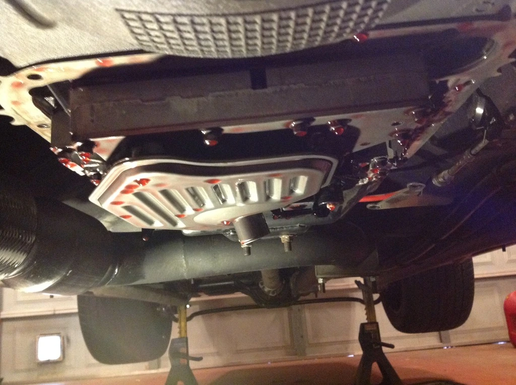

I'm at step #6. The solenoids all "click" like they're supposed to....
Only I ain't dropping this thing till more of that red sht drips off...

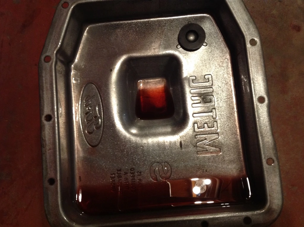

The pan was remarkably free of crap,....guess that's a good thing..
Granted,..the transmission only has 70-80 miles on it (if that). The magnet in the upper corner was coated in black film,....I know that was/is some of the friction material,..but again it was only a film,....so,........so far, so good.
