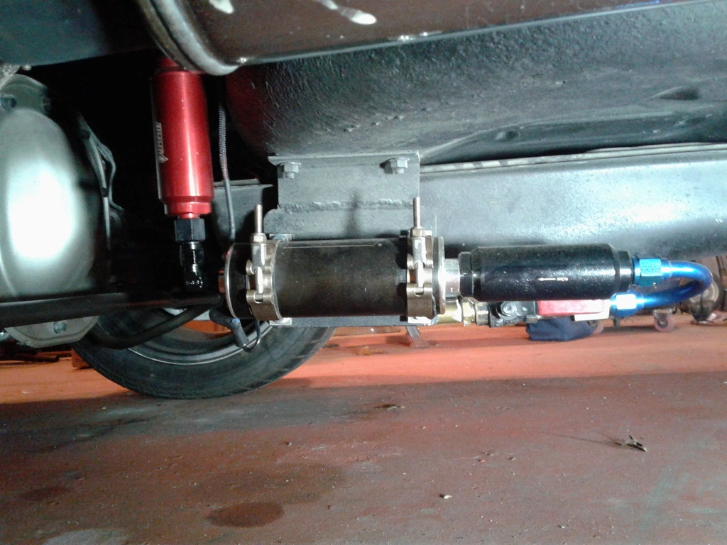

Does the problem occur when you have full tank of fuel?
If not, then the lack of baffles or their lack of effectiveness may contribute to your problem
You have a sump, but what keeps it full of fuel during acceleration and braking?
How many baffles do you have to keep the fuel from sloshing around when you don't have a full tank of fuel?
Air in the pump lines would probably cause an increase in the noise level, and a problem with baffles or their absence could contribute to that increase in noise.
The key clue is that you say the car must be driven for more than 20 minutes before the fuel pump starts to make noise. That may be an indication that the returned fuel is boiling in the tank from the engine heat it picks up. The pump is designed to pump liquid and not a mixture of fuel and vapor. When you pressurize the fuel, the vapor problem goes away because pressure increases the boiling point of any liquid. The engine gets liquid fuel which is good, but the pump is sucking vapor and liquid and complaining while it is pressuring the rest of the fuel system..

Well, that's not unlike what the tech was telling me about a restrictive fuel system causing cavitation.Cavitation adding to the heat of the recirculated system, and w/i a certain time frame,..the pump starts complaining.
There are no baffles in the tank,..It's stock. But the noise happens regardless of whether the tank is full or not. The sump is on the side, and in the middle of the tank at it's lowest point. (the rear of the tank angles up dramatically, i'm guessing to increase up hill ground clearance).
I can't mess with it anytime soon,..But I can stuff the tank w/ fuel cell foam to give it a baffle. I can move the red filter forward onto the frame rail and orient it horizontally,...I can re-configure the pump mounting to eliminate the hard 90 that has to turn 180 before it goes into the prefilter, and I can "soften" the 90 that has to turn vertically where the red filter used to be..

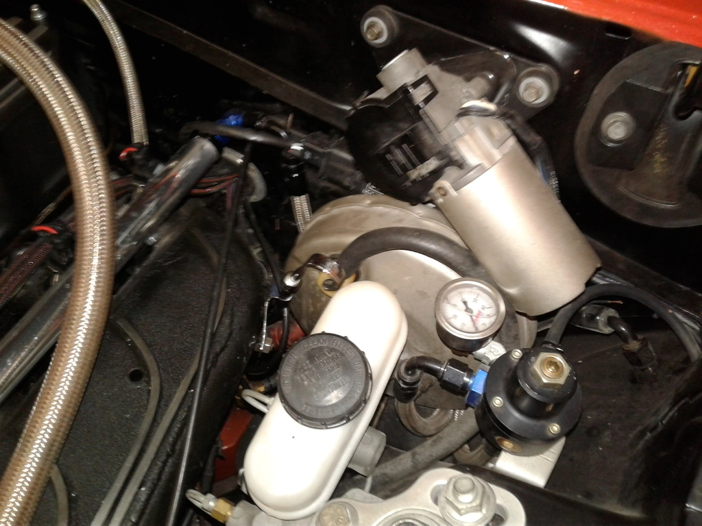

I can do all these things to try and make the fuel system less restrictive. but I can't do jack at the fuel rail...It's a fraction of an inch from the firewall where the turn is. The only thing that could be done there would be to shorten the rail a bit and have a soft(er) nipple welded onto it.
The pump may be sucking in a mix of liquid and vapor due to the heat in the tank from the recirculated fuel and any slosh that is occurring.
It's all the plumbing before the pump that is the likely cause of problems. Try fixing that as a first step.

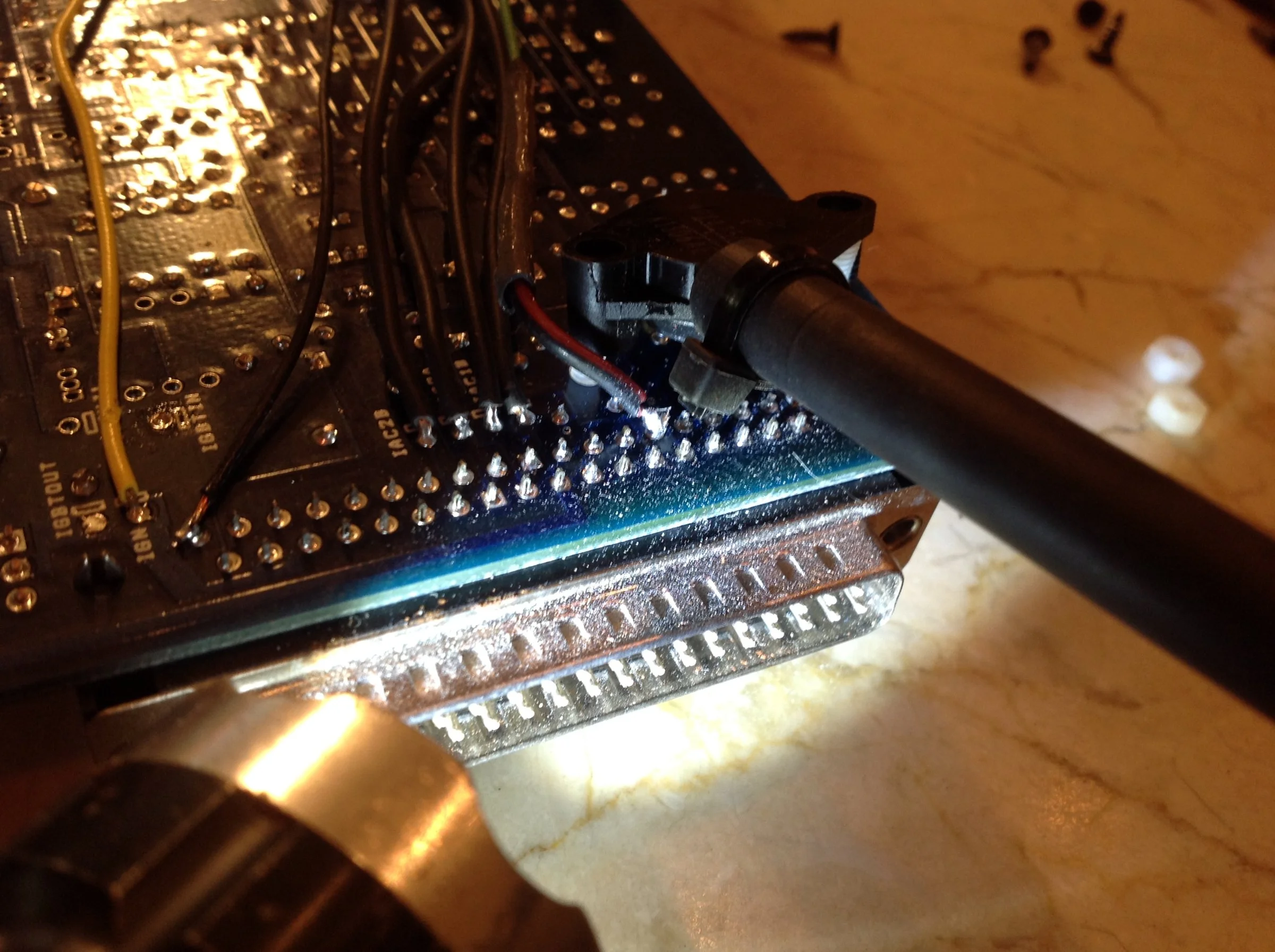

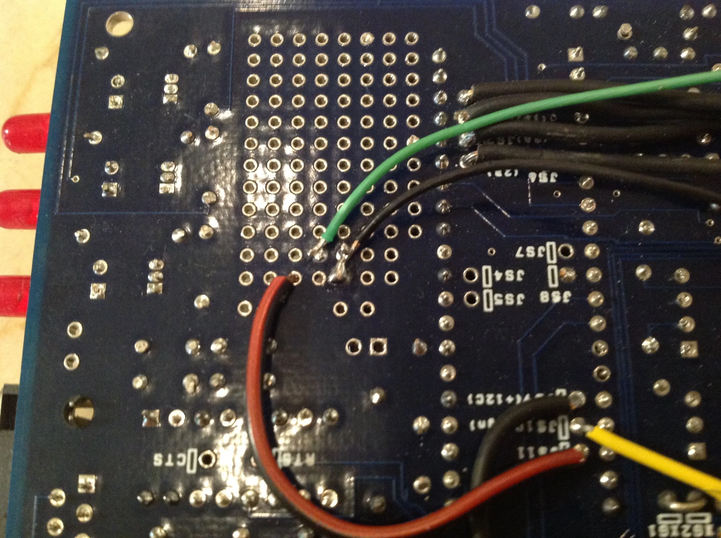

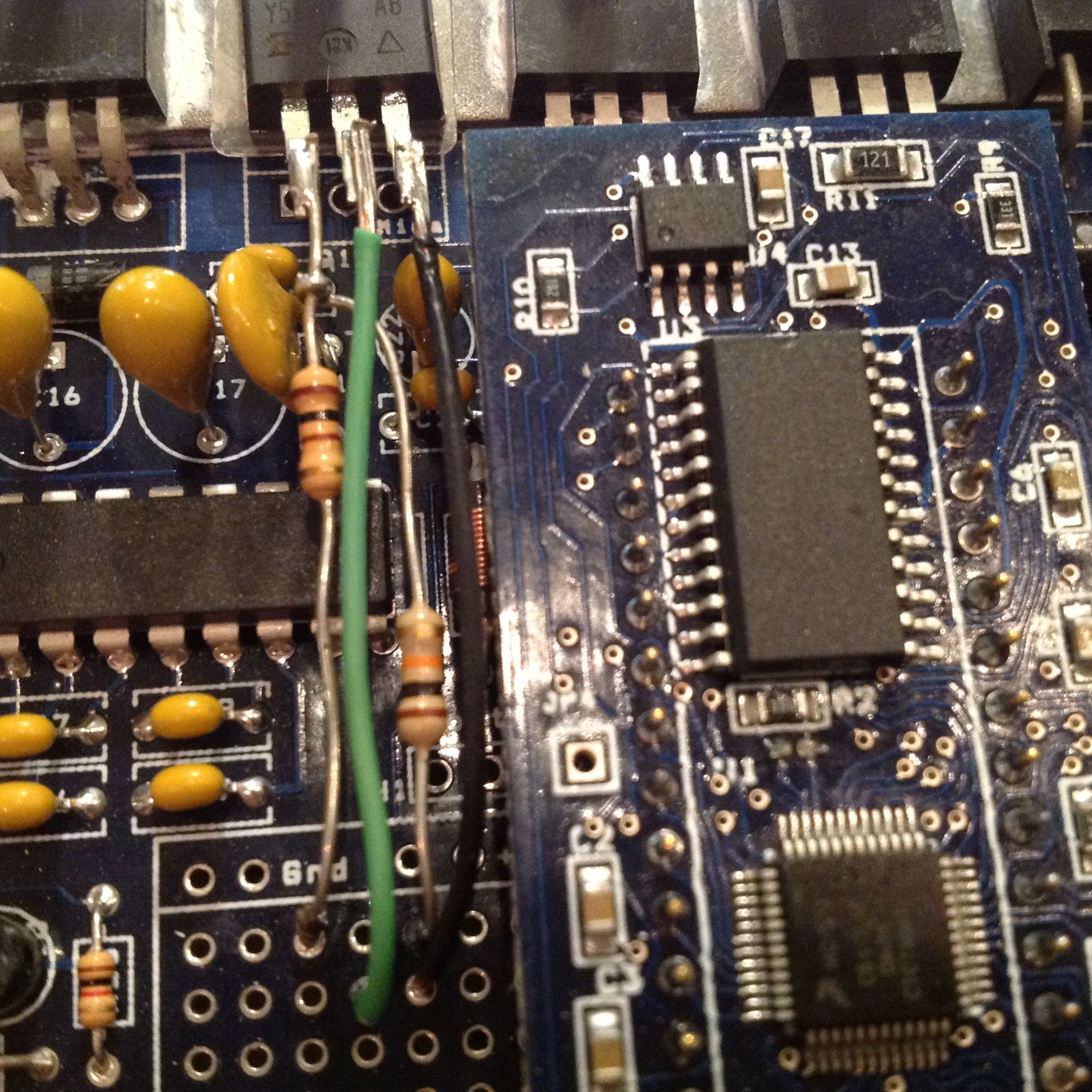

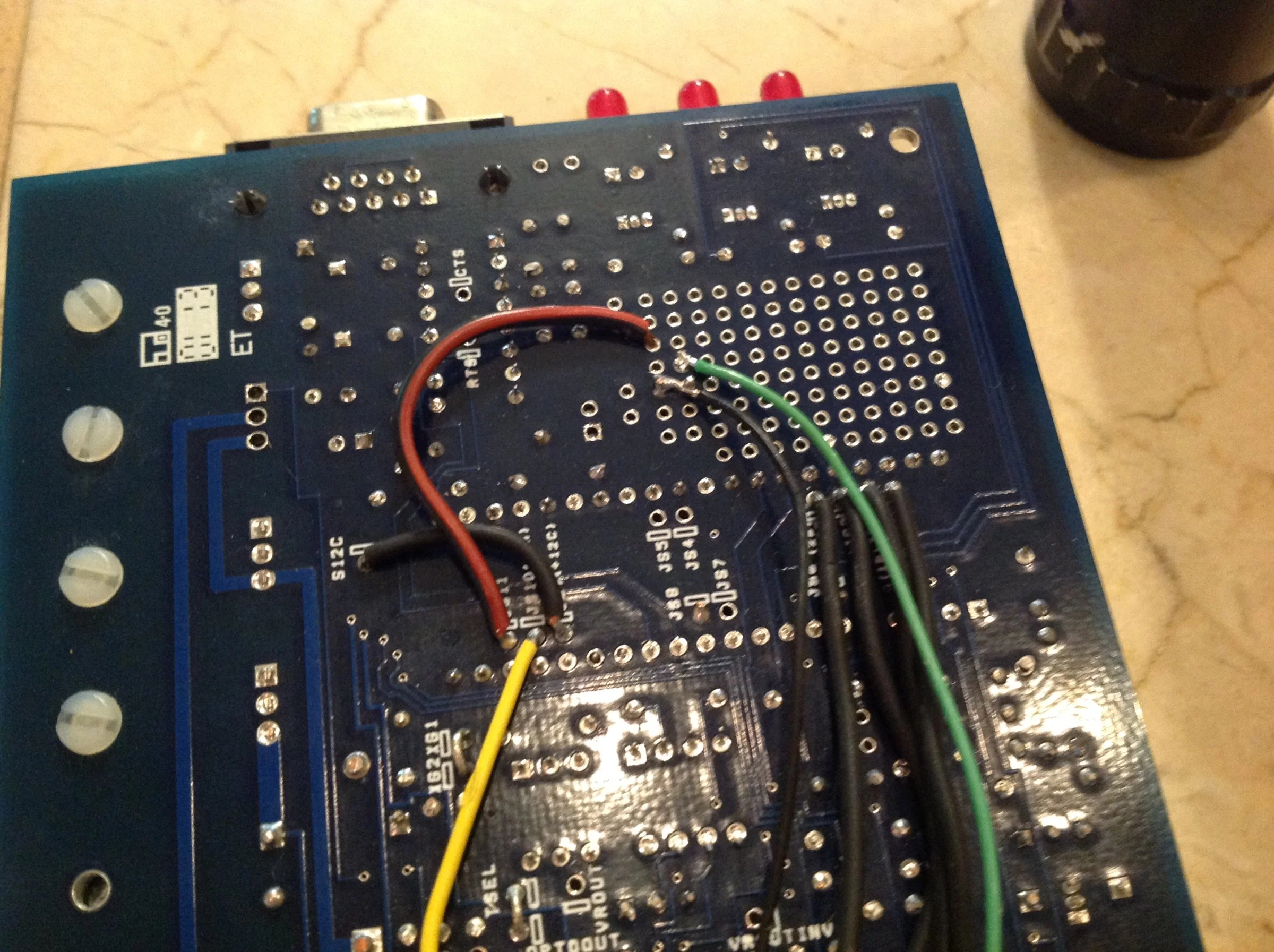

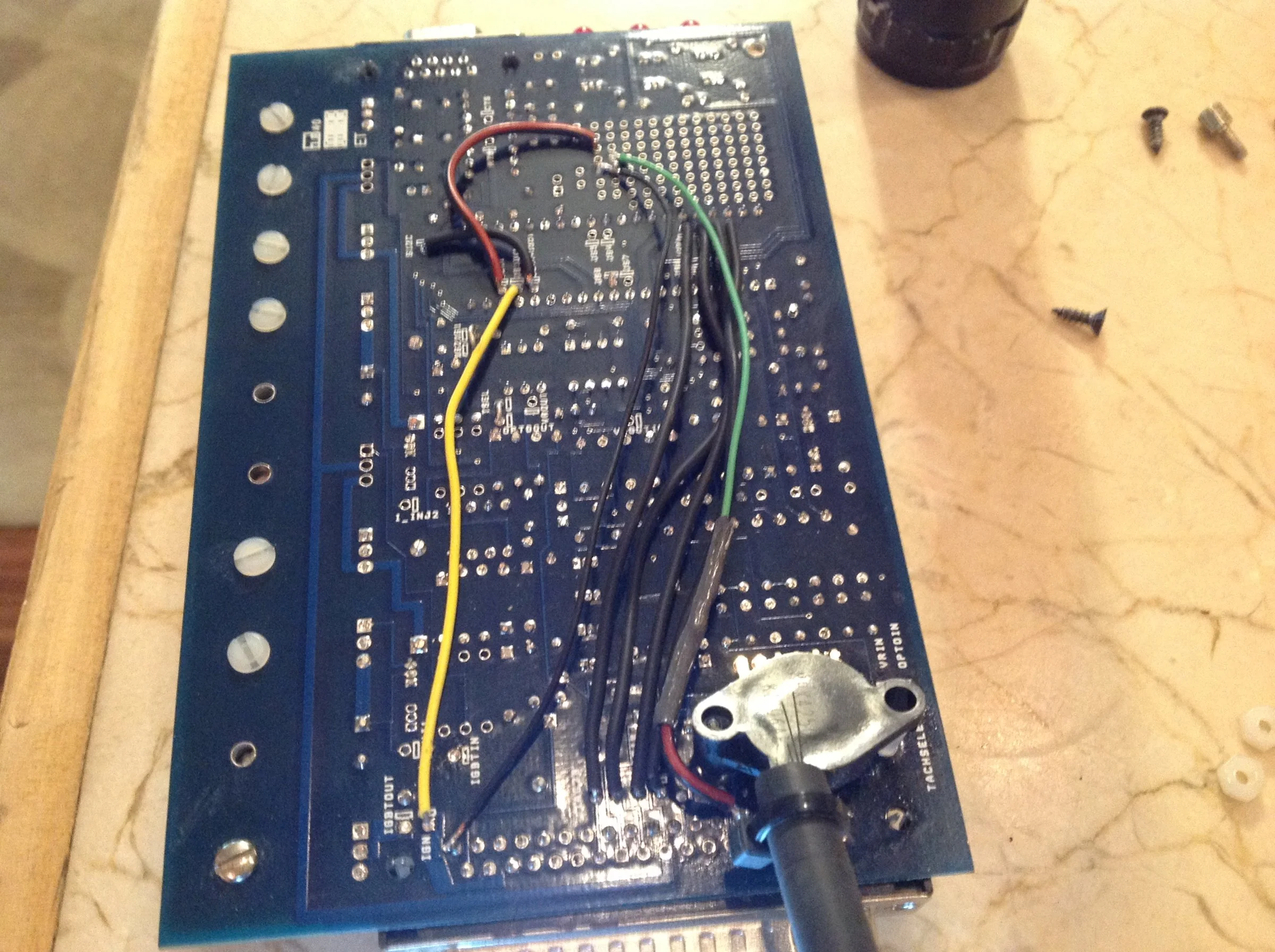

Simple you say?
I think it's far from simple. ( and BTW, I used that schematic when I added this stupid circuit.)
This is my ecu
Looks pretty good from the outside huh?
No so good when you open it up though.
The ground, and the one leg of the 10k resistor are blobbed together on the other side of the proto area, and one wire runs to what I was told/read was a ground on the board. The signal apparently is coming from JS 11, and the output goes to a pin 14 pins over as you go right from left ( I put it on whatever pin was supposedly a spare, unused pin IIRC).
On the other end, it comes off the relay board, and goes to spr4 ( again, IIRC). There is switched 12v going to one leg of that solenoid, and the output from spr4 (that should provide the gnd signal).
That's all I can tell ya.

Tonight's top story though revolves around my noisy assed pump, and the measures I took to change that.
Firstly,....a humble admission...:oops:

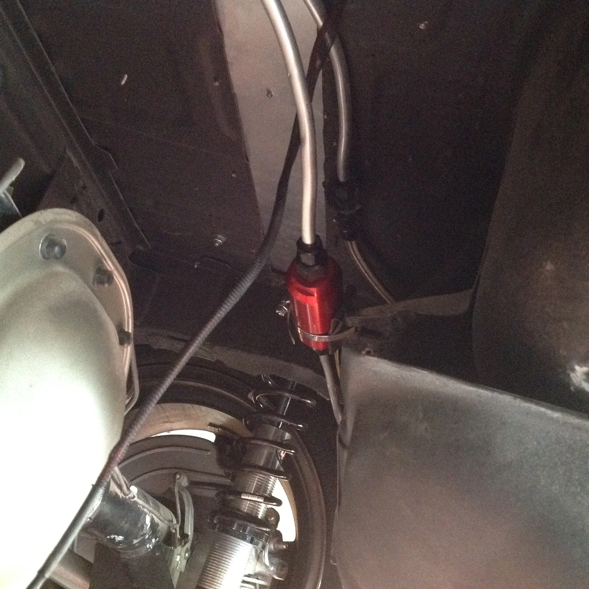

The filters were pretty dirty. The inlet filter STILL had a few small chunks of that red junk that was left in the tank, as well as a significant amount of metal filings ( probably as a result of some left over remnants of when I cut the top of the tank open to pull that afterbirth looking red junk out of the tank).
The post filter was so dirty you couldn't blow through it. ( not easily anyway)
I cleaned both of those filters thoroughly first and put the filter housings back together.

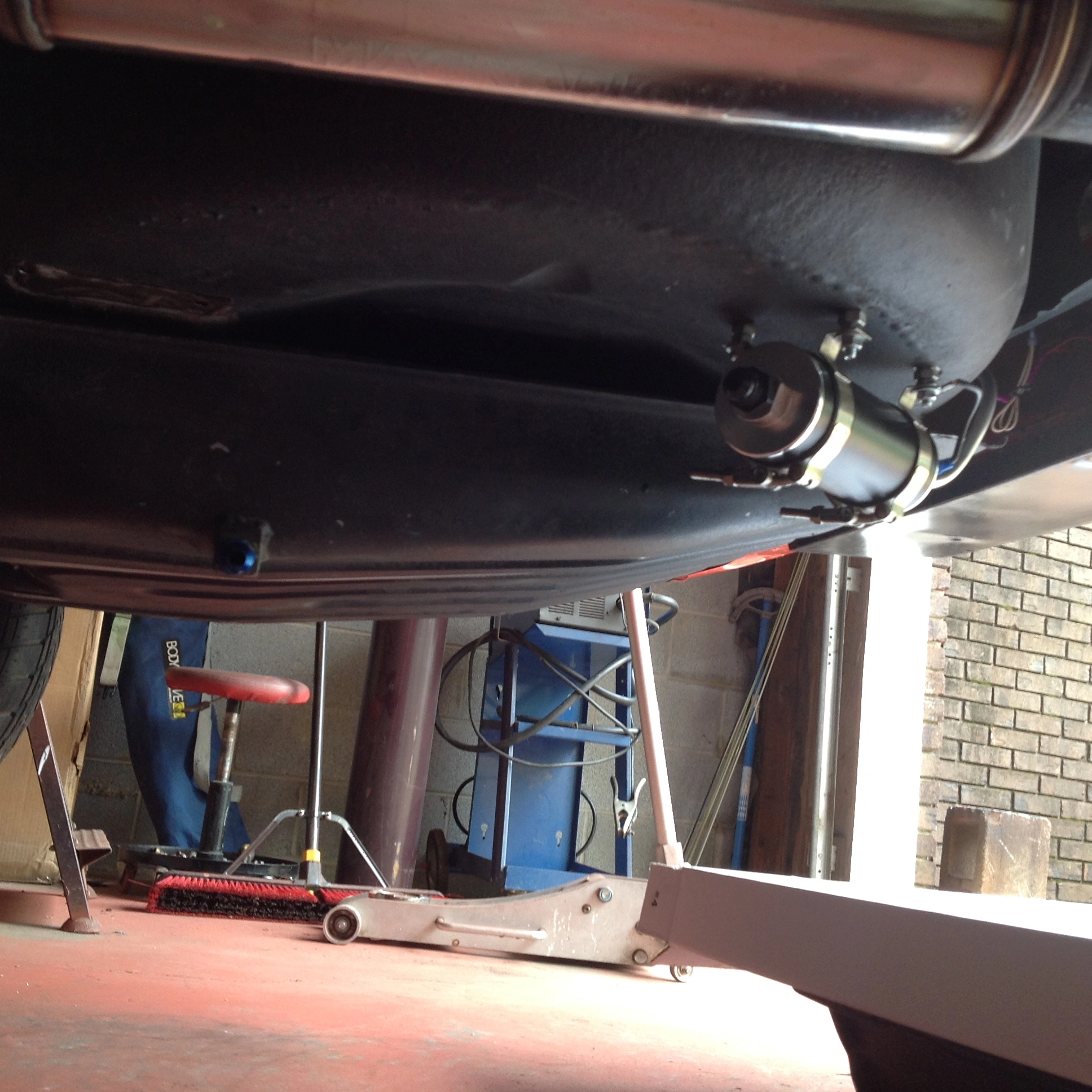

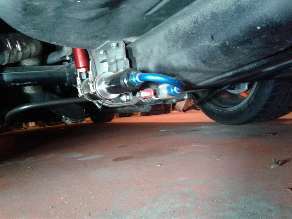

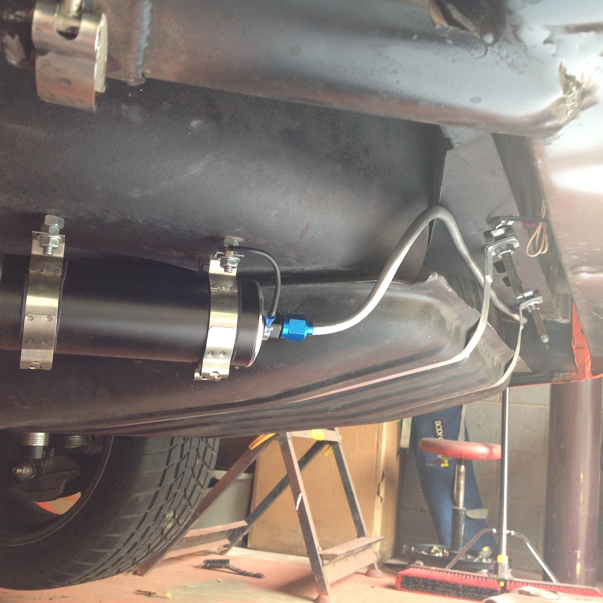

Next, I repositioned the pump, and oriented it facing rearward.
It now looks like this:
I didn't have the -8 tube nuts and sleeves to make the lines to go from the tank to the pump, but they'll be here tomorrow. The plan is to make a soft turn (45degree) that goes into the pre filter, and exit out and turn another 45 degrees into the pump. Doing it this way I'll lose 3 hard 90 degree turns, and a full 180. It should be the fix.
From the pump the line goes around the tank
And comes back around to where the existing hard line was ( now holding the post filter, oriented horizontally)

Ok Mike as far as I see that thing should work.
Now to test it, wire the solenoid up and feed it air. From the output of the solenoid (going to wastegate) you should get an increasing amount of air as you give it gas.
I will help you set up the settings in TS.
Of course leave things "open" in case changes need to be made.
Feel free to call me to get this working
