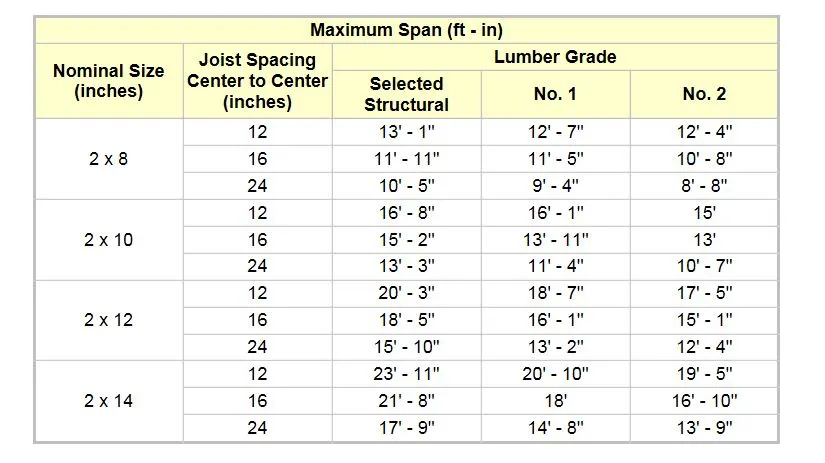

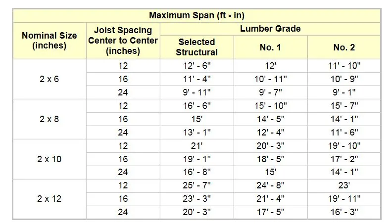

Before you get too far, check out the span tables for flooring. Too much unsupported span will bring the house down upon your head.
Copied from http://www.engineeringtoolbox.com/floor-joists-span-d_1479.html
Floor joists - maximum unsupported span
Max. Live Load 30 lbs/ft2 (1436 N/m2)
Max. Live Load 60 lbs/ft2 (2873 N/m2)
See https://www.google.com/?gws_rd=ssl#q=max+unsupported+span&spf=1498172344885 for more information.
Personally, I would first build a new wall where you want it and then take down the old wall while still keeping the span table data in mind.

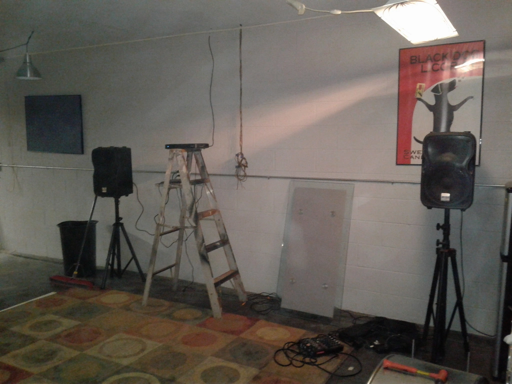

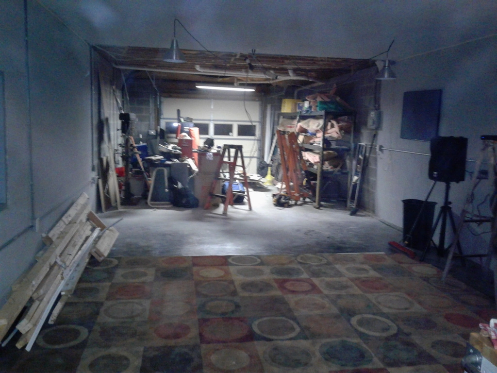

Alrighty then,...It's past the point of no return.
First to address the few that have concerns that I will bring the bedroom above falling down on my head.
This was a basement before it was a garage. The previous owner added the partition wall to divide the space so that her son could have a dedicated space to live in while he went to college..She created a living space, added a bathroom,..and a Mitsubishi room AC/Heat pump.
Now I don't know what kind of car ol dude parked in that single garage while he was going to college, but I can tell you this:
It wasn't the Monster.
When you put the Monster in there, there maybe an extra foot front to back....
But that was before 7:30 PM June 22, 2017.
Now,...it's a little longer.
Now I'm not sure what I want to do here,..I can either put up another wall deeper in, or I can just make the work and storage benches be the dividing partition. The garage door is insulated, so it really doesn't get hot down there....(when the garage door is closed) But it'll be a beast down there if I was to open the door and work in/out like I typically do. However, If I give myself enough room to work inside,.....I won't need to open the damn door.
The rest of the space is typical man cave.
Big ten inch 2 way pro audio speakers w/ built in 600 watt class D amplification, ( they play Gilbert O sullivan very loudly)..A 46" UHD TV, A small refrigerator/freezer for libation storage,..All that's missing is a couch, and my Herman Miller Eames lounge chair..
(look that one up and see what it is)
So whadya think?..... a wall or a bench?
Damn, you're not the next star of Renovation Reality. So, I would put a wall with a door. If you grind/weld/paint/spill gas or oil, you'll probably want a little separation. If you need some kind a HVAC movement you can have the door open. If you need to close off the man cave from fumes while lounging in the Eames you can close it. Just googled Eames lounge chair. You know they 'spensive when the WalMart copy is $500.

Bench, nothing says,"Mancave" like a Monster as the center point.

After sleeping on it I've decided to leave the space open, because I agree......
I could put all of the typical man cave art, posters, and neon down there, and nothing would compete with the Monster if he was visible.
The Guardian shelving units that are on the right in the picture are going under the knife. I'm cutting them down to half size and making them benches. At 6' high, that'll mean that they end up at 36" high (perfect counter height). I'm going down there right now to cut one of them, before I go into work.
