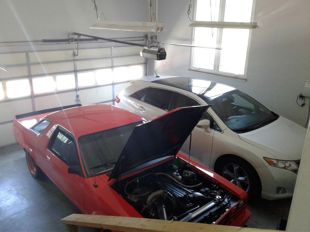

Obviously, I got home,....the engine idled perfectly when I pulled it into the stupid 2 car garage where it is still temporarily housed...
I wiped it down,...dabbed the water off of the intake manifold where the one scoop had been allowing it in,...and went back into the house..
Oh,...and I made the wife move closest to the wall.
Maybe you should back in on her side, put the PS of your car against the wall. Then she will have more room to maybe not hit your car with her door???
That's a great 'aerial' shot of the Monster. Maybe you should get some Fog X and coat the inside of the windows. I had an old 70 Chevy SWB PU once that didn't have a/c. It too fogged like San Francisco at the slightest mention of rain. I used Fog X and it worked great. It occasionally fogged up but I bet it took care of 90% of it.

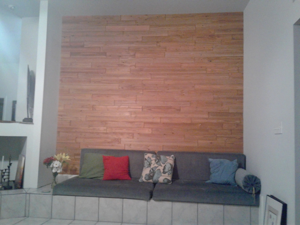

The wall in the front den is done,... it turned out great.
(you'll have to settle for crappy cell phone pics,..I'm drinkin' and I don't care).

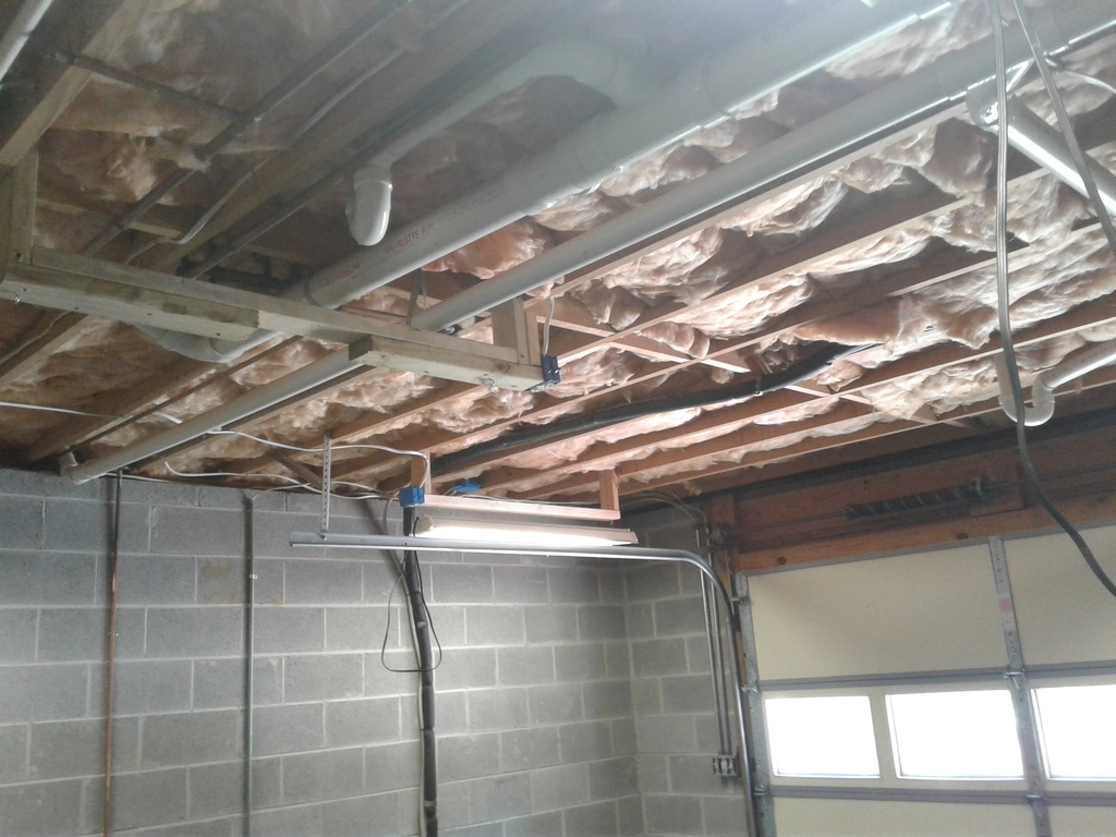

This is what I started with.
Plumbing hanging down below 8' ceiling height,..raggedy insulation threatening to drop a whole bunch of "what th' hells' this sht's?" into future paint work,...all with a minimal budget to cover it up with..

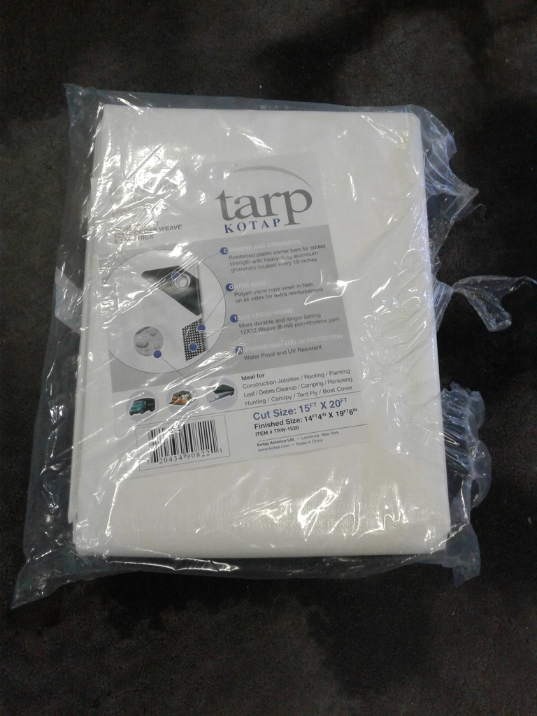

Budget?....
This only costs 30 bucks...
Yep,...a tarp.

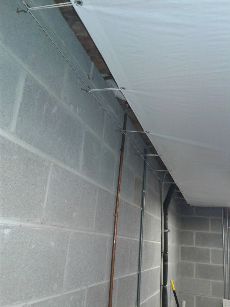

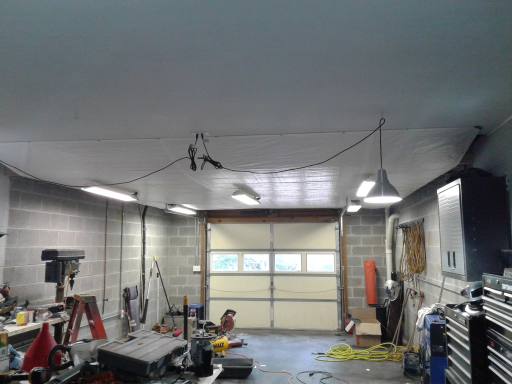

Like a boss.
Believe me when I tell you that this was a btch from hell. To get the eyes to stretch evenly, I had to drill a hole 7" down from the top, in a cement block wall w/ varying distances from each other.
And the stretch I needed required I revisit me pirate sailor knot trainin' from me olden days....
So,..it works....for now.
It's about 7.5'.....soft. If a cherry picker happens to bump into it,..it'll push it up to about 8'.
It'll keep the heat from rising, and the cool from being wasted into a wasted space. If something goes wrong above, It's a simple loosening of some knots and the thing drops....
I'm considering this a success.
I still have some hanging and organizing to do to even have a prayer of getting some semblance of order in there,...but it's getting there.
