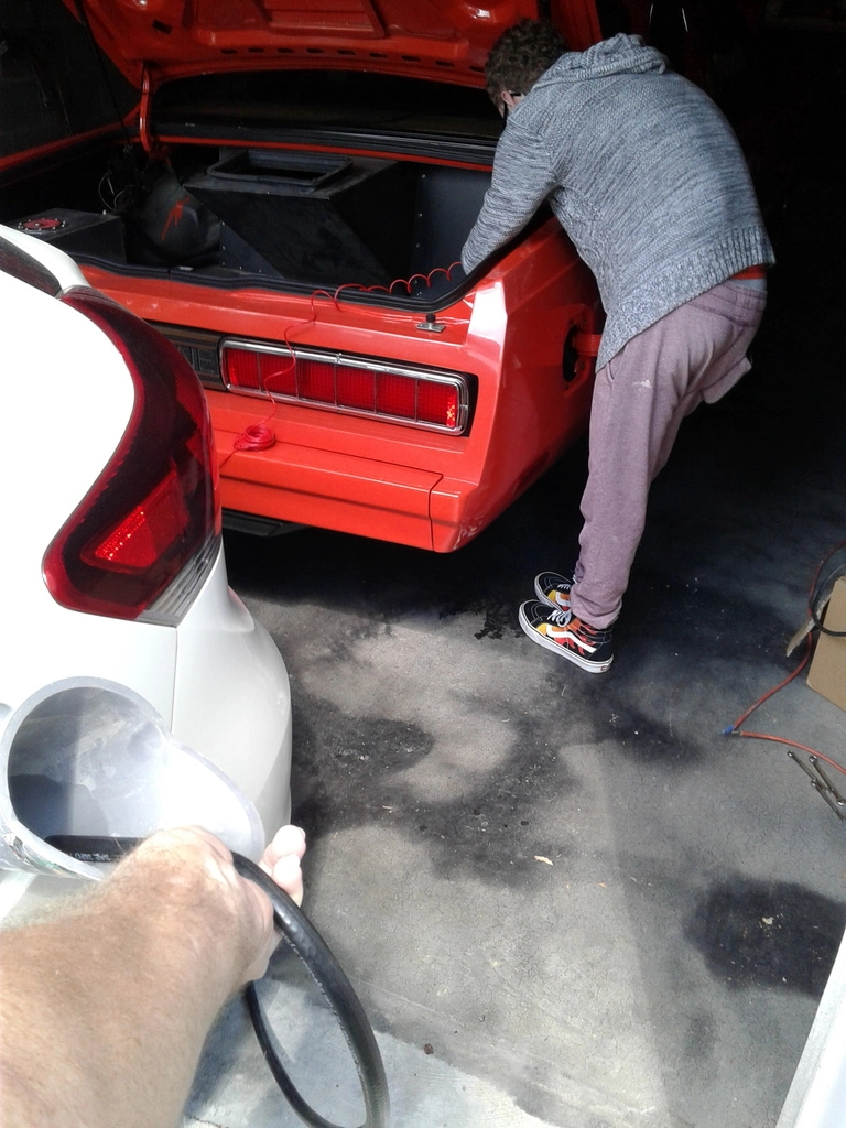

Here's me an #2 force feedin the wife's Venza 15 gallons of "Way more than what that car will ever need"....took about 5, maybe 7 minutes.....clearly, while its cool, that pump is more than capable of moving some gas.

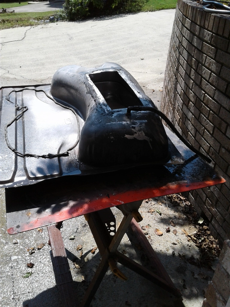

Once done with that, I figure what the hell,...my knees are stiff as boards already, may as well push forward....I dropped the tank.
Here is the ugly little bastard, with the previous hacked together cover plate removed. The new hole will be bigger than this, but will have a welded base that will be drilled and tapped to allow for an 1/8" thick cover plate made out of aluminum. In this pic, I've flushed it w/ water, and gave the inside a quick washout w/ royal purple HD cleaner.....tomorrow, I'll go to the metal supermarket ( yes, that's it's real name) and get my steel/ aluminum to put this thing back together again.

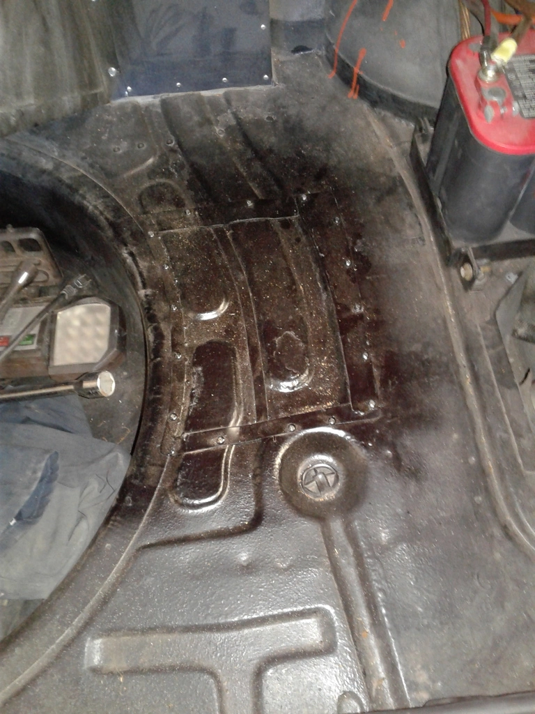

I'll go to the metal supermarket, and get the metal I need to seal the gas tank, and build the cover plate for the trunk floor. Herein lies the dilemma, and the reason for editing my thread title tonight.
