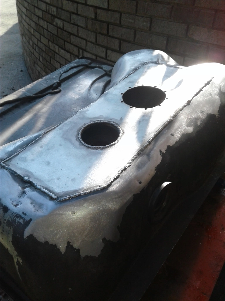

Basically, the only purpose of the welded ring is to allow you to tap holes for bolts. I say make that hole a rectangle. Take the top plate and clamp it to that ring. Drill and tap your holes. Mark the tank and drill matching holes to the top cover. Use tank repair goop ( or a magnet )to hold that ring inside the tank. Then seal and bolt the top plate on.
See, easy peasy.... You could even leave the magnets in the tank. They can't hurt nuffin'. :shrug:
No welding at all. Very little rust. Almost no room for error....unless you just want to do it again.

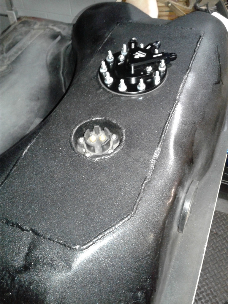

I clean the tank,..and drill the holes for the pump and sender. I finish by tacking the plate on top of the tank......And it starts to rain.

So,...I forced myself down to the Monster manor...and started working on the tank.
In a couple of hours,....I had this.
It just takes a bagillion years when you are welding stuff that is as thin as a gas tank. Add to that that it is galvanized, and mig welding this thing requires a certain level of Oh-Bi-Wan Kenobi kinda skill.
I just happen to have that.;)

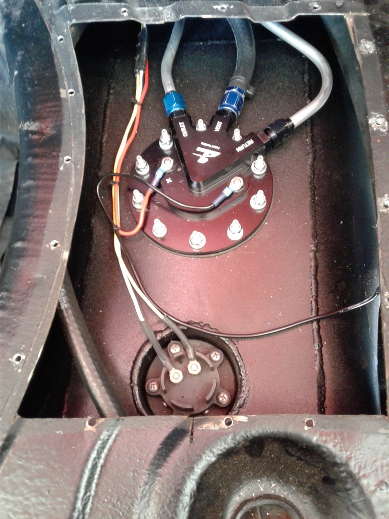

After that, I cleaned the pss outta the inside of the tank. Hosin' and Scrubbin' as best I could, followed by a couple of vacuum sessions and I was satisfied.
This kit has a foam bladder that acts as a baffle. There is also a fuel pump strainer attached to the bottom of what appeared to be a Walbro pump The bladder I'd imagine will also act as a "filter" of sorts,...but there isn't any junk left inside for me to worry about getting sucked up by the pump.
You have to cut that yellow foam 1" higher than your tank, and then jam that into a hole that's about 2" smaller in diameter.
The pump hangs in the middle of that cone,...the fact that it's wedged against the top and floor of the tank, and now held that way by the pump should keep it in place....(I hope)
When you finish, This is what you get.

The best part of all of this is obvious,.....I don't have to cut the trunk floor. ( any more that is) Everything is accessible once the cover plate is removed.
So,.....yeah.
Now,.....how much better is it than the previous system?
So far,...having only started the car....night and day.
The engine had to crank several times before starting with the old system,....It's almost like you could hear the fuel foaming when the system primed.
With the new system,...the engine starts when you turn the key. You can barely hear the new system,...you could always hear the old one.

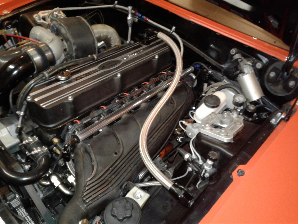

My well received " other" thread where I asked for input on breather tanks offered little help, w/ Noobz' exception (Thanks Noobz)@Noobz347.
It makes sense that if I've got enough velocity of air movement through a -12 that's it's able to move wet oil,..I've gotta lot of blow by. Placing a second -12 in the front of the VC and routing to a second tank would effectively open the hole to -24......(I'd have a collective 2" hole in the top of my valve cover)
The benefit to which, ( also directly quoting the Noobz) is that opening the flow restriction lowers the air pressure to the collection vessels....better ventilation = better sealing, less baby puke in the breather tanks,..happier Mike.
The problem for me is......symmetry ....I don't like lopsided lookin anything, and I want those tanks in a more servicible location....where would I put them?
Maybe,....get two slimline tall boy lookin alum ones, and put them side by side where the existing -12 passes through? Then fab up a quick release so that I can just pull a pin,...loosen the fitting,....and dump whatever is inside?

At teh risk of being the stickler for obvious details:
Remember that both PCV system capacities need to be port to port. What I mean, using the same vac source/orifice to run both systems won't net the increased volume.
I'm sure you know this already but didn't see where either of us emphasised it.
