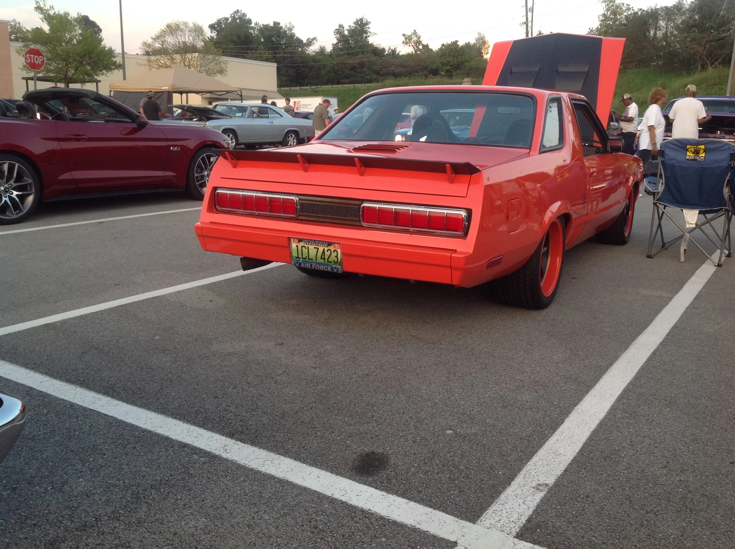

I liked that exhaust tip. And I don't think the shape of the exit is gonna effect the oil dots on the back, and I hope that this new exhaust exit is at least oval shaped and centered. Maybe a inline duel can cantraption where what the first can don't catch the second does before being suck into the intake, I admit I know little about boosted engines, all this oil mist and blow by can't be the sign of a good ring seal, but I could be wrong, way off base or just the ramblings of a guy that drinks too much coffee.
Well,..I made it.
It's gotta be placebo effect, but I'd swear that it runs smoother.
The exhaust tip has a distinct sound now,..and bumbling along at 2800 RPM, I can definitely hear it loudly purring back there.

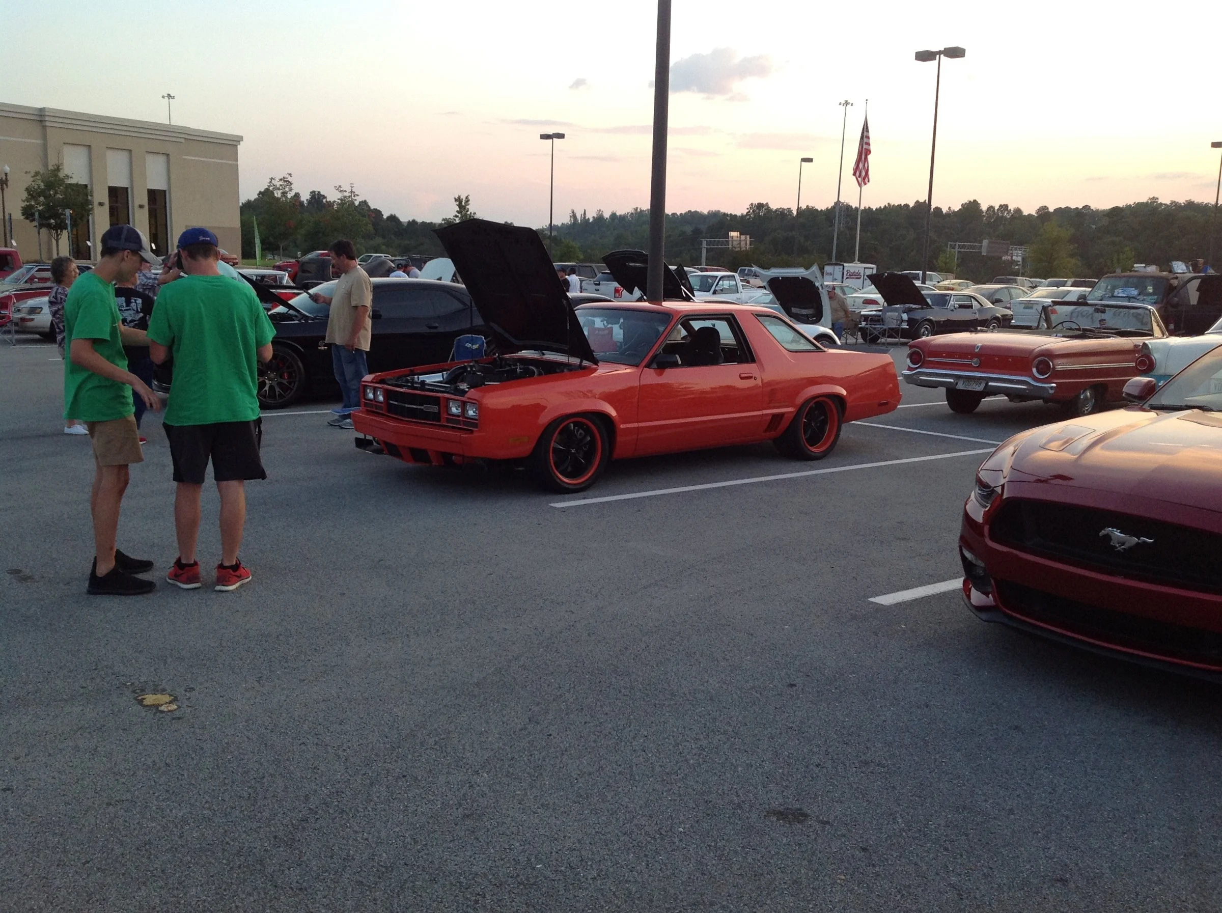

You can tell the cruise-in season is winding down,..there was only about half as many cars as is typical for this venue,..but still about 50 cars,..maybe more.

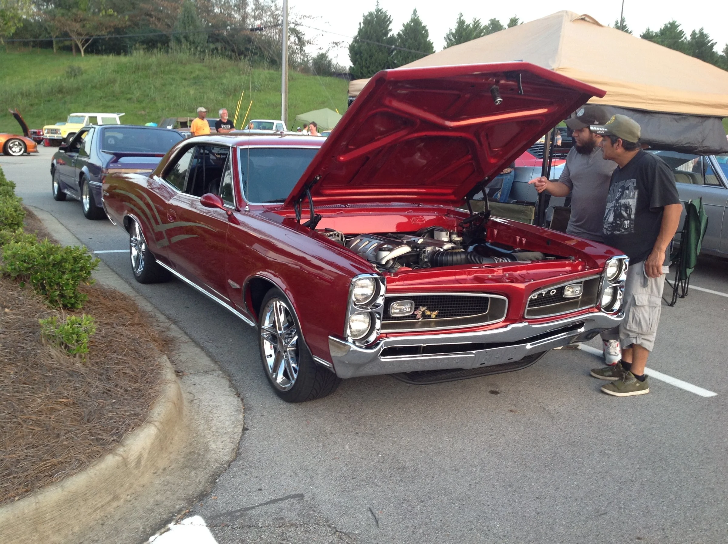

This guy takes a 67 GTO, and completely transplants a 2006 GTO into the shell.
Even the interior looks like the newer car...so freakin cool.

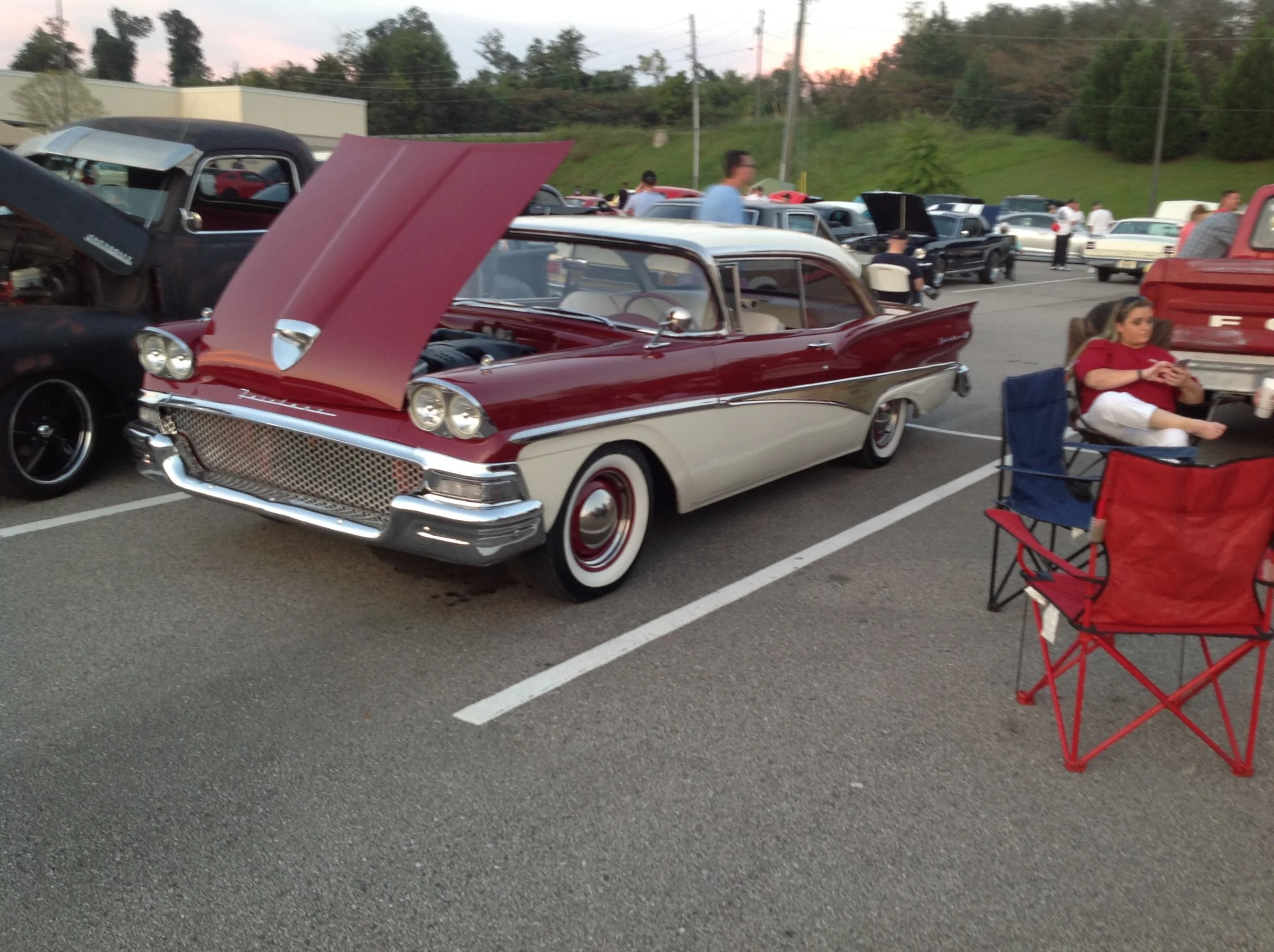

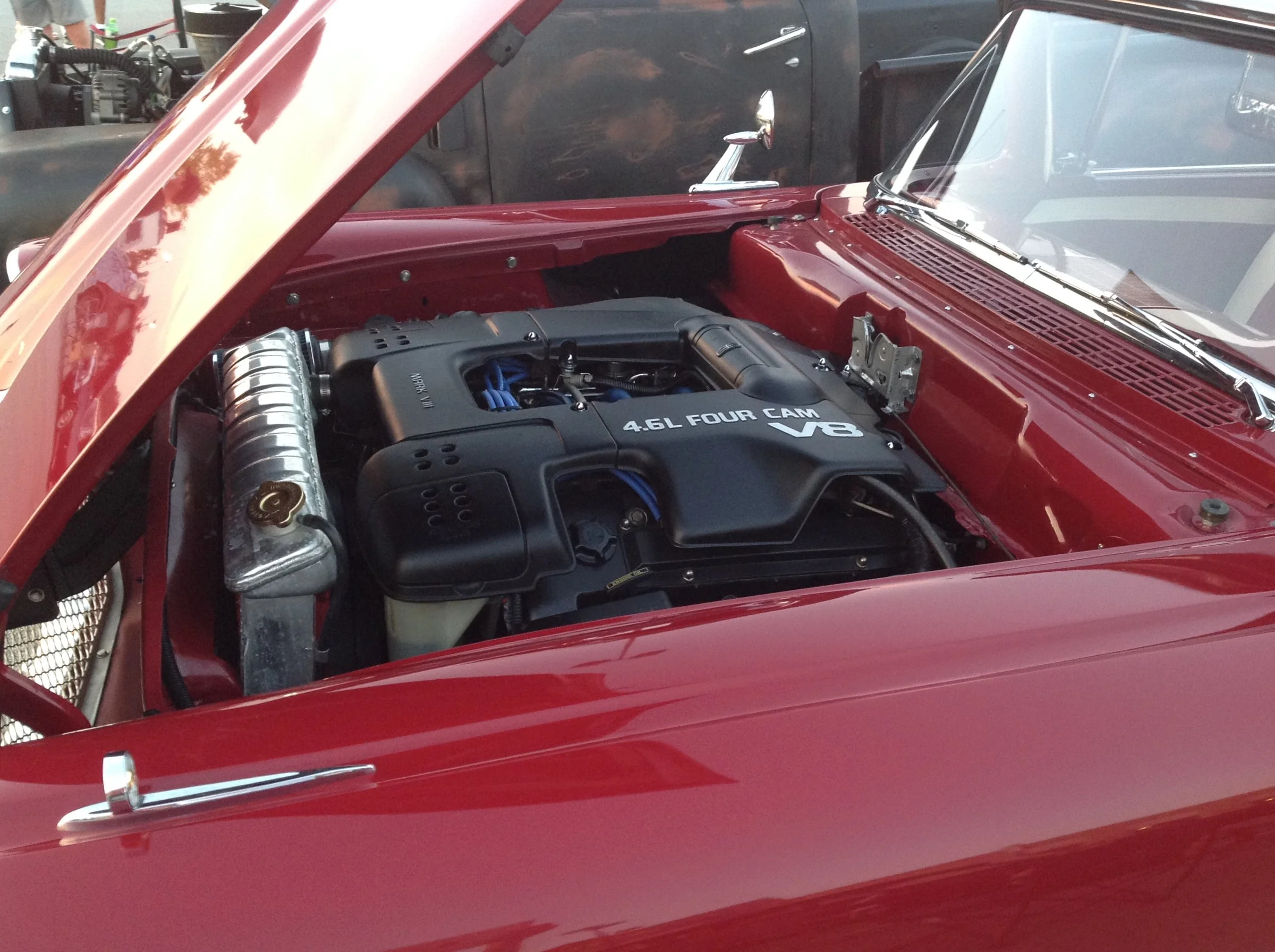

The Monster's grandfather was there,....
Sportin' newer Lincoln DOHC running gear.

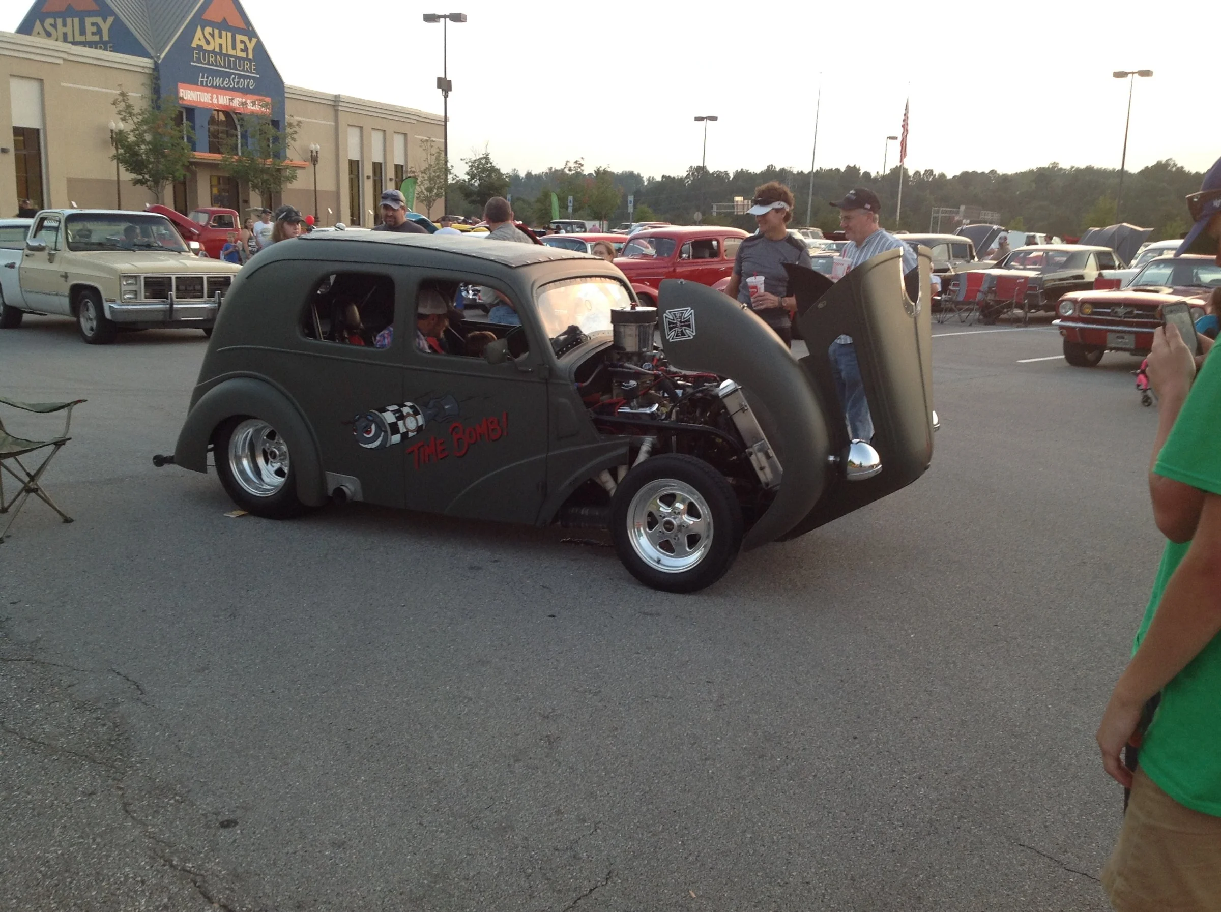

This guy is always there...48 Anglia with a 484 c.i. Cadillac engine...he says it's scary to drive...I'll bet it is.

All by myself w/ my single tail pipe self..
I don't think it matters one little bit that the old tail is gone,...MOF, I think the rear looks cleaner w/o the old tail pipe.
Now,...is it any cleaner....we'll have to wait till I go back down there,...my knees are screaming at me,...I'm done standing today.
I really dig that GTO!
The monster’s butt looks cleaner without that big old thing dangling off of it in my opinion too.
There you go,...I agree. It lowered the rear facade when the tail pipe was there,..now it's just cleaner. And I looked,..it's much cleaner on the rear of the car. The new tp is angled away enough to get the exhaust out of that vortex behind the car.
