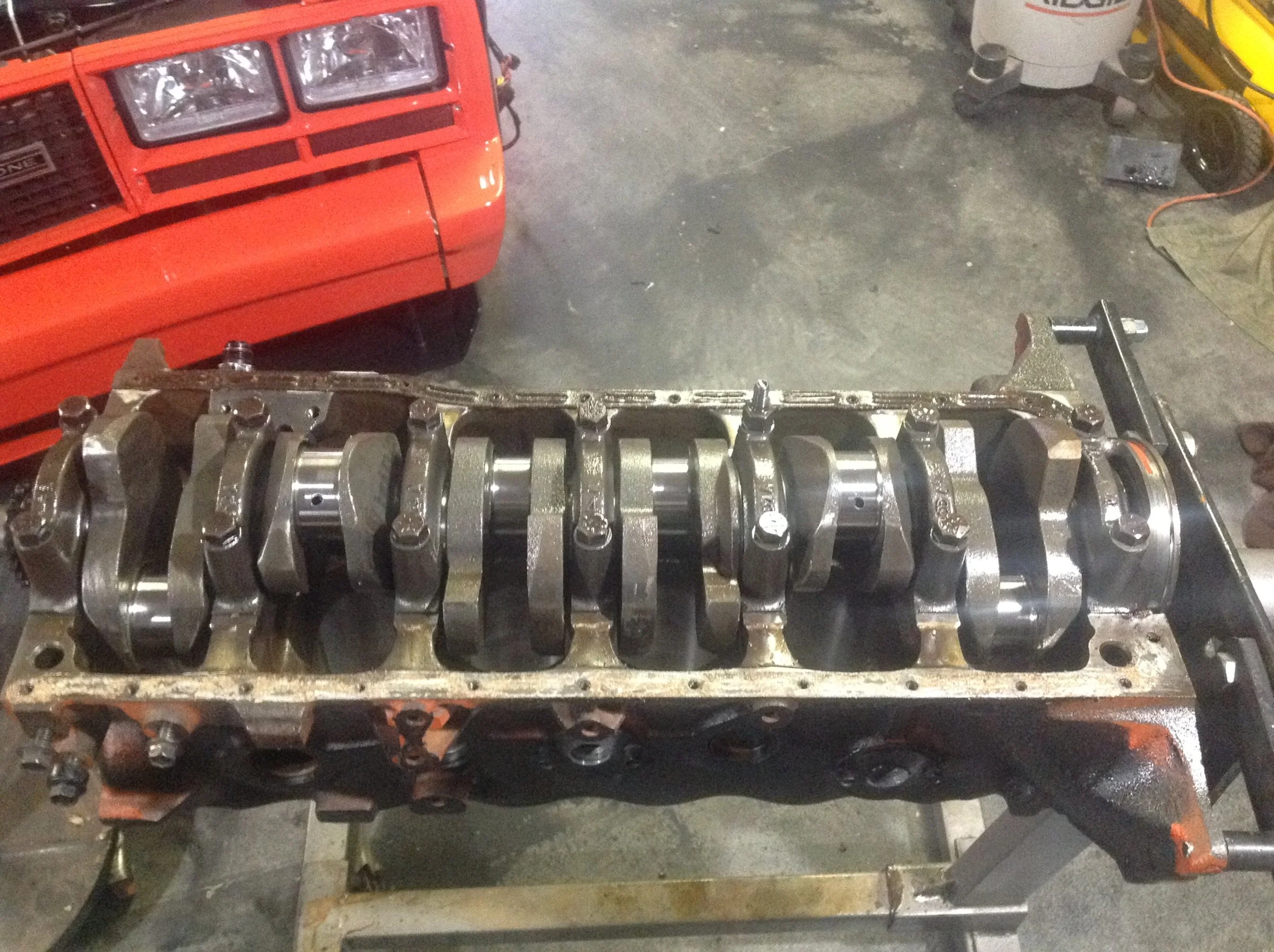

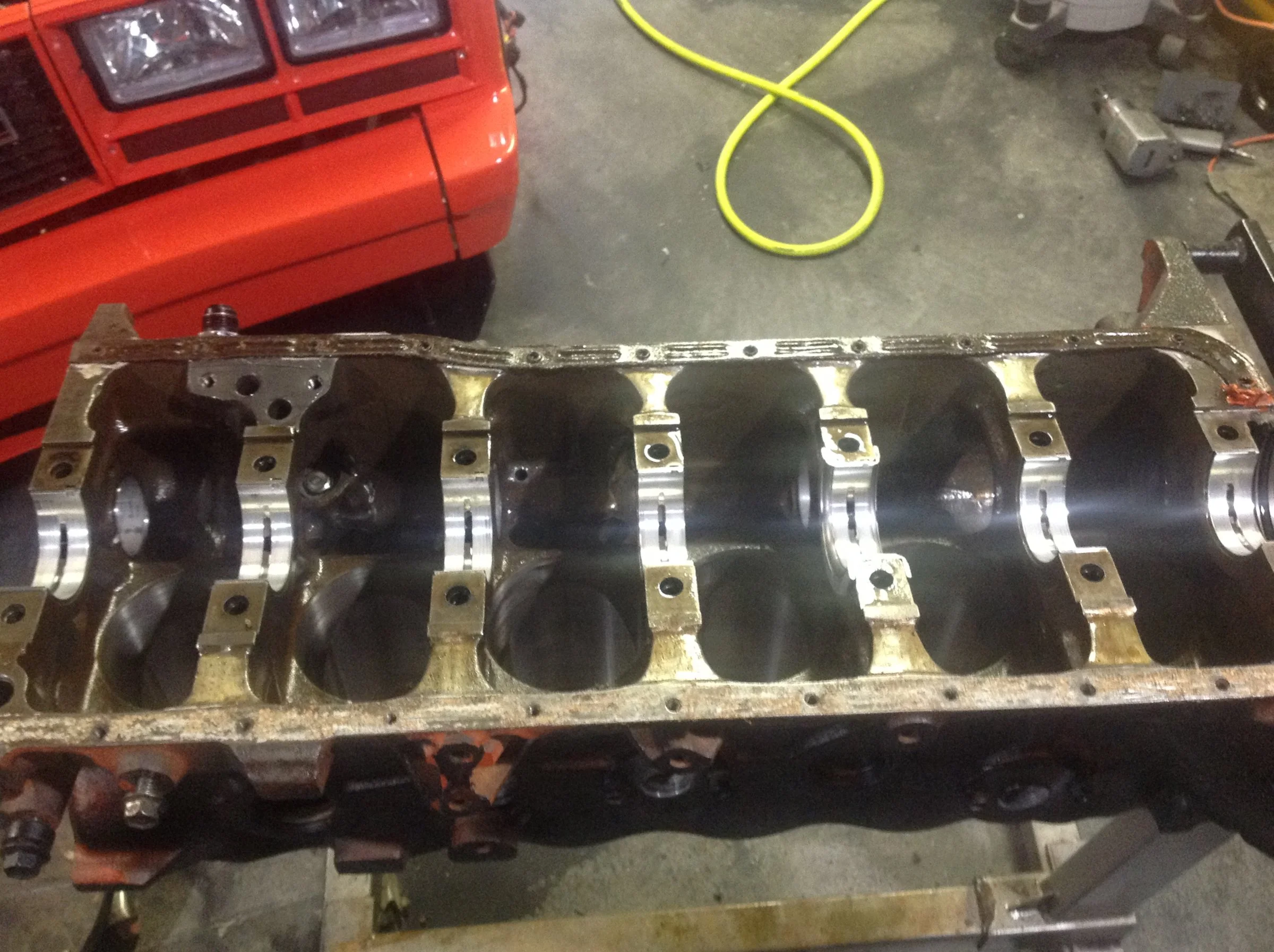

So, the last of it is apart. Every bit looks just as good as the rods did.

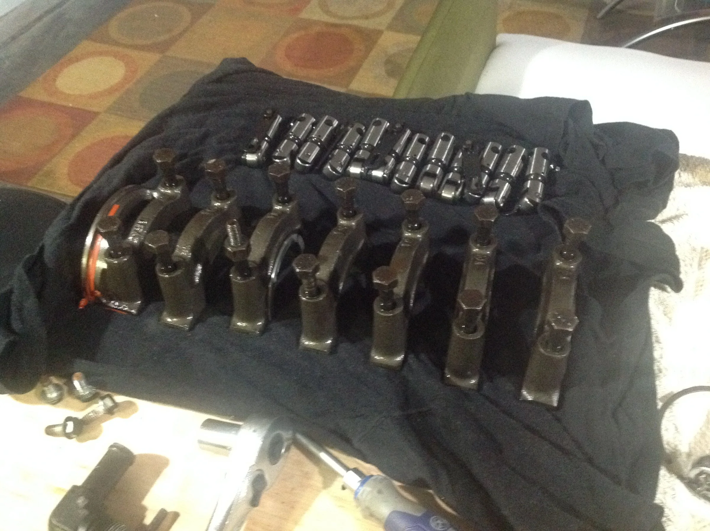

7 mains boys,...count em. This is the main reason that this stock combo will be able to withstand exposure to almost quadruple the stock rated HP of 99 whopping ponies. (Try doing that with a 5.0 block) You literally can only blow them up by neglect, but I'm sure that 15 psi, and 6000 rpm will test those boundaries. I gotta admit, I hated to tear this thing apart, but seeing that everything is so nice inside completely removes my concerns about possible contamination from dirt, gasket material and metal shavings, ( The head was off 3 times before as it is) and puts my mind at ease about leaning on it as heavily this time around. It'll only be cleaner the second time around.
Are there any companies out there that make bullets main caps for that block? Just thinking about more strength for more boost. :eek::eek::eek:
No,...there is somebody in Australia building a main cap girdle for it, but the stock main caps have to be cut significantly to allow the thing to lay flat, and cutting them that much just don't make no sense.

Looks Good! Did you not about run the thing out of oil at least once too?
Nice looking Crankshaft! Fully counter weighted!
Yes,......now that you mention it I almost did. I had to have oil in the thing by the time I got it in my driveway, but if I had to go another block,....that might've been a different story:eek:.
Although I know this was a pain in the ass, it's good to see how well this thing was holding up. Get the ring gap situmanated and you'll be good to go!
I have a Buick 455 sitting in my garage that has a girdle on it that is like that. You have to shave the caps so the girdle can lie flush and get a little preload on the caps. Most of the ones out there that sit on the stock caps of a 5.0 aren't really doing much. They are just locking all the main studs together, but sitting on the stock round cast caps, they aren't really doing a whole lot to lock them in place. The caps can still walk which is the killer.
