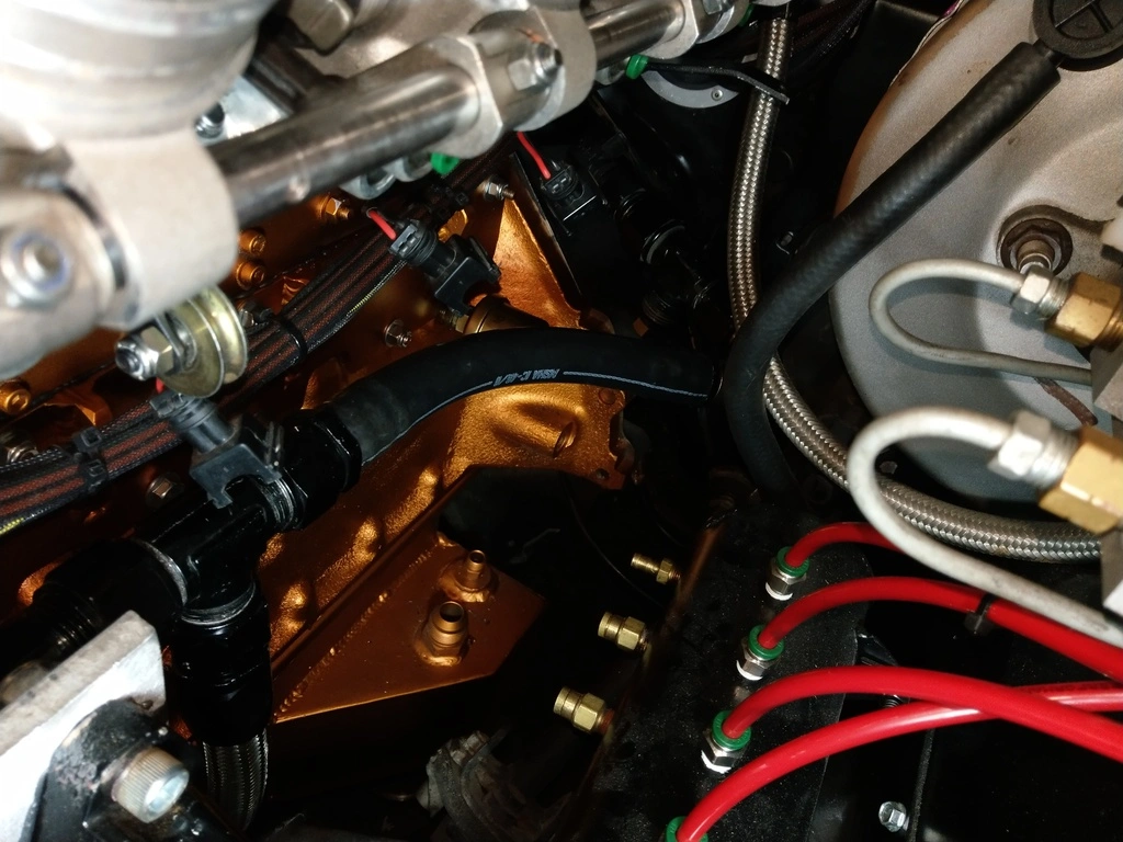

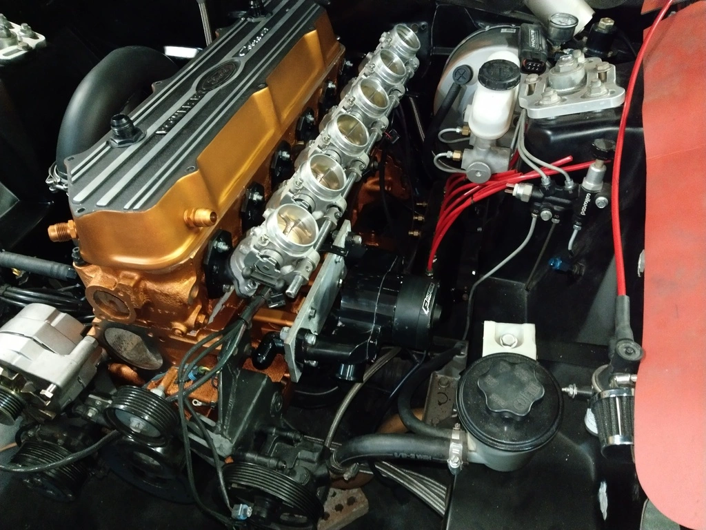

The pump now hangs from a bracket welded to the side cover.

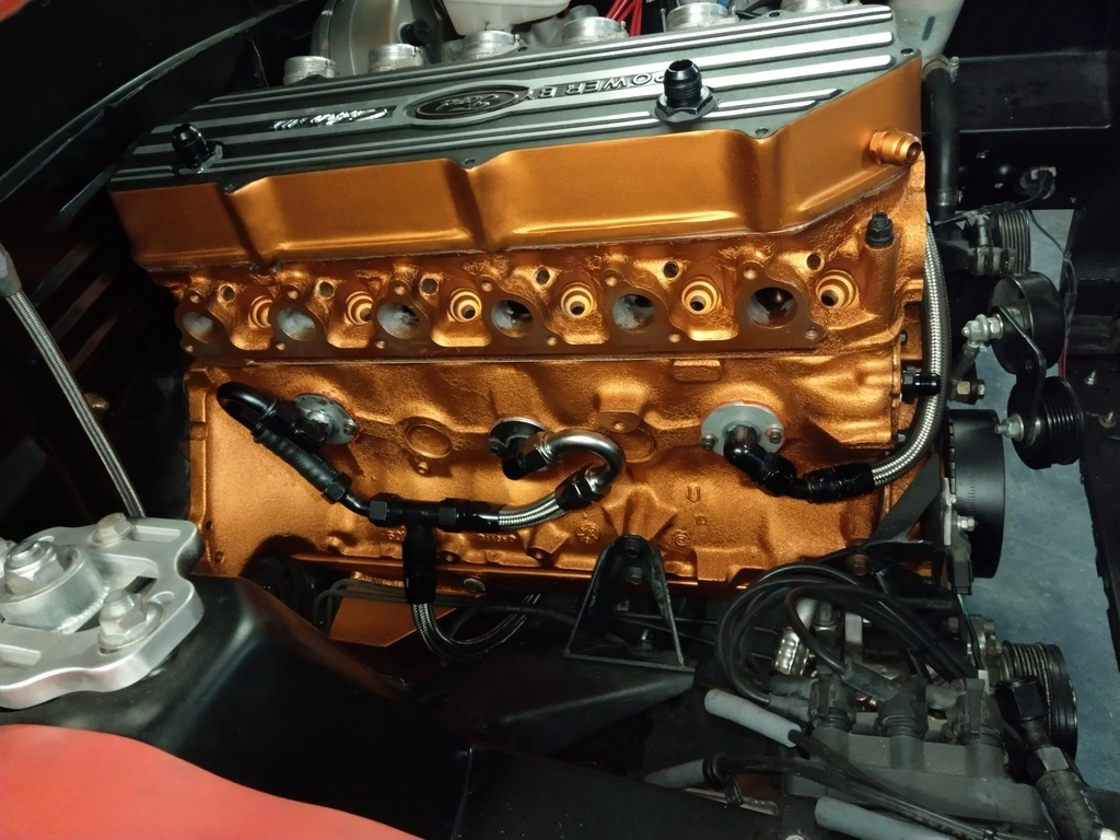

The back side of the pump feeds the heater, and passes under the pan to feed the three holes in the side of the engine...
I have all of these expensive assed push lock -12 120, 150, and 180 degree fittings...I wanted to do the whole thing in braided, but it just seems such a freakin' waste to buy new junk to do that with. Besides, the stuff I bought to make the braided stuff you see work cost 200.00 as it is..Bottom line,...the rear most fitting was plumbed in push lock junk. You can't really see it once the header is on, and it's a smaller profile than the braided fittings. It doesn't matter anyway.

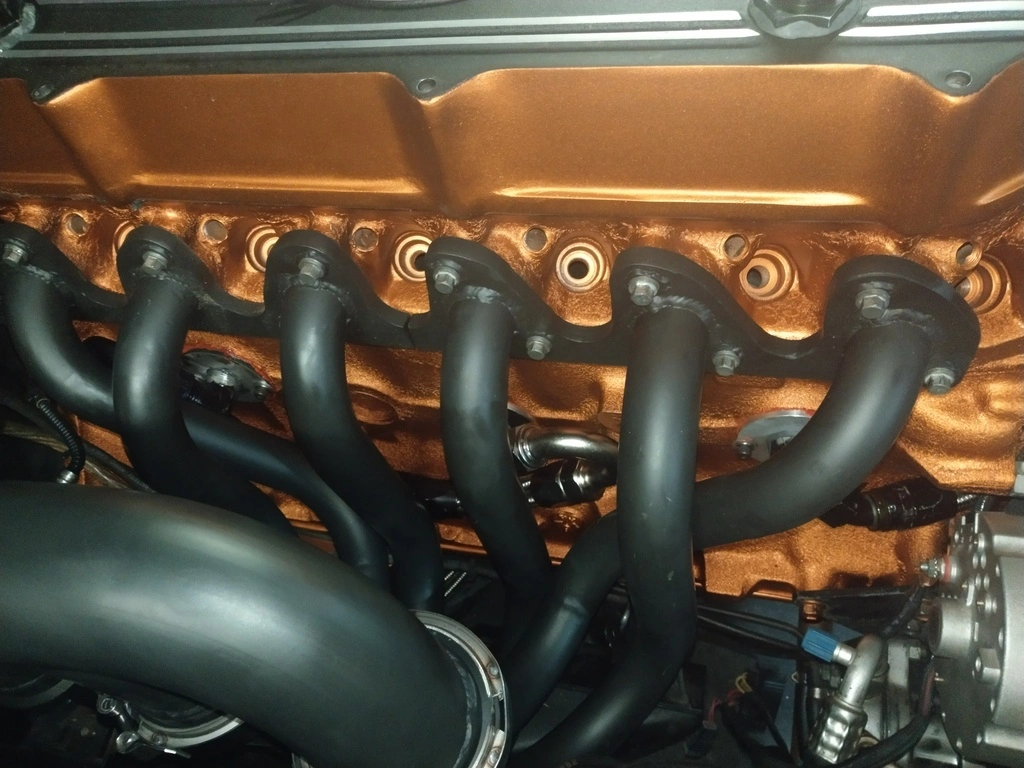

Because despite jamming the fittings tightly against the block........
Still ended up jamming against one of the header tubes.. The rear-most fitting is touching tube #6. How tightly, I got no idea. Tube #4 is barely touching the T. I also got no idea what happens to the hoses when they are attached to pieces of aluminum that are touching hot steel. I'd imagine that it'd be a bad thing, excepting that there will be water circulating through those fittings, effectively wicking out the mega heat transferring into the hoses that are attached to those fittings.

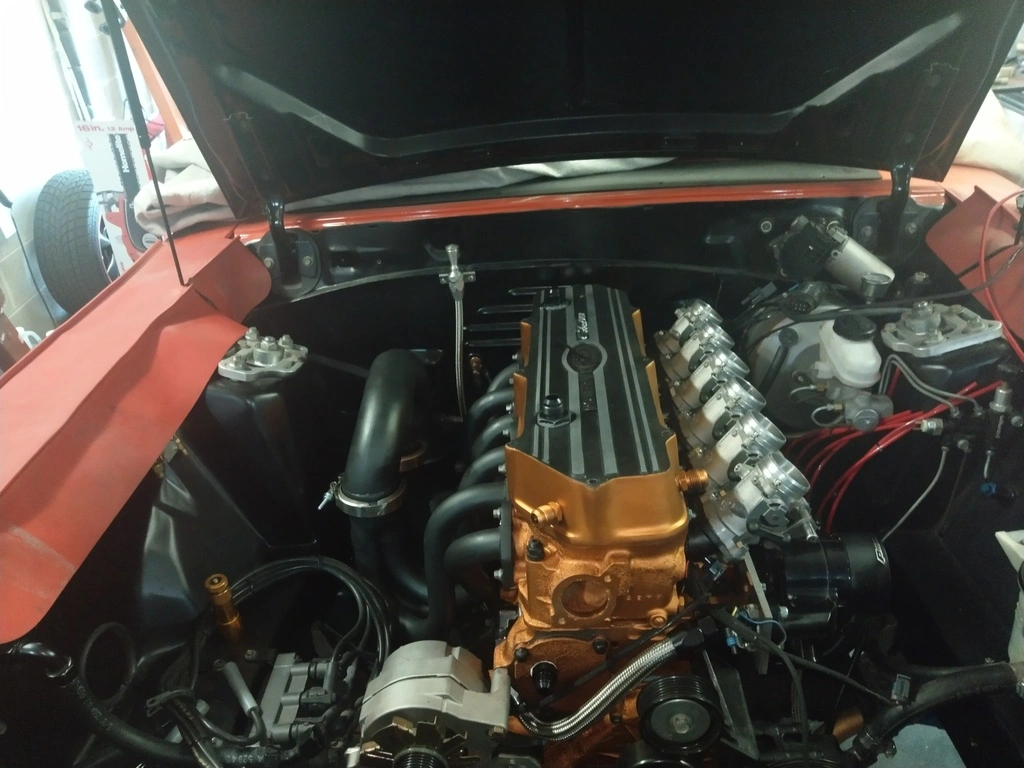

The header is mounted. The converter is tight, the O2 sensor is in, and the alternator wiring is plumbed and tight.
Everything that you see bolted on is actually permanent, except the ITB's. They have to come back off so that I can relocate the throttle linkage firewall hole.Once that is done, I'll plop those dudes back on, and work on the throttle linkage at the TB's. That is the last hurdle to deal with before being able to even consider starting this thing.

Im 34 and also ready for bed. So Mike, what keeps you from using 90's straight down out of the block to keep from hitting the header? Is that the "using what you already had" part, or more to do with circulation? Obviously you cannot leave it as is, unless you plan on wrapping the header? Would a nice thick header gasket give you more clearence?
Edit: Does your header(s) bend in toward the block instead of just running 90 degrees versus the ground? Hard to tell in the pics. 90's straight down seems like the water lines would hug the block nicely, but not if the header is also sharing that space.
Wrongo Jeeves. I'm not changing anything. I said that the contact with the fittings would be mitigated by the fact that water is moving through the fittings. Straight fittings attached to the 90's in the block stood off even further. The 180 degree fittings allow me to tilt them against the block.
