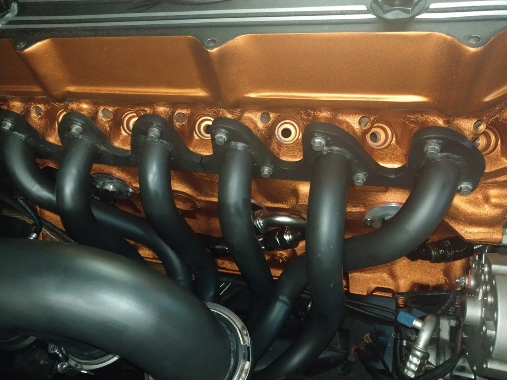

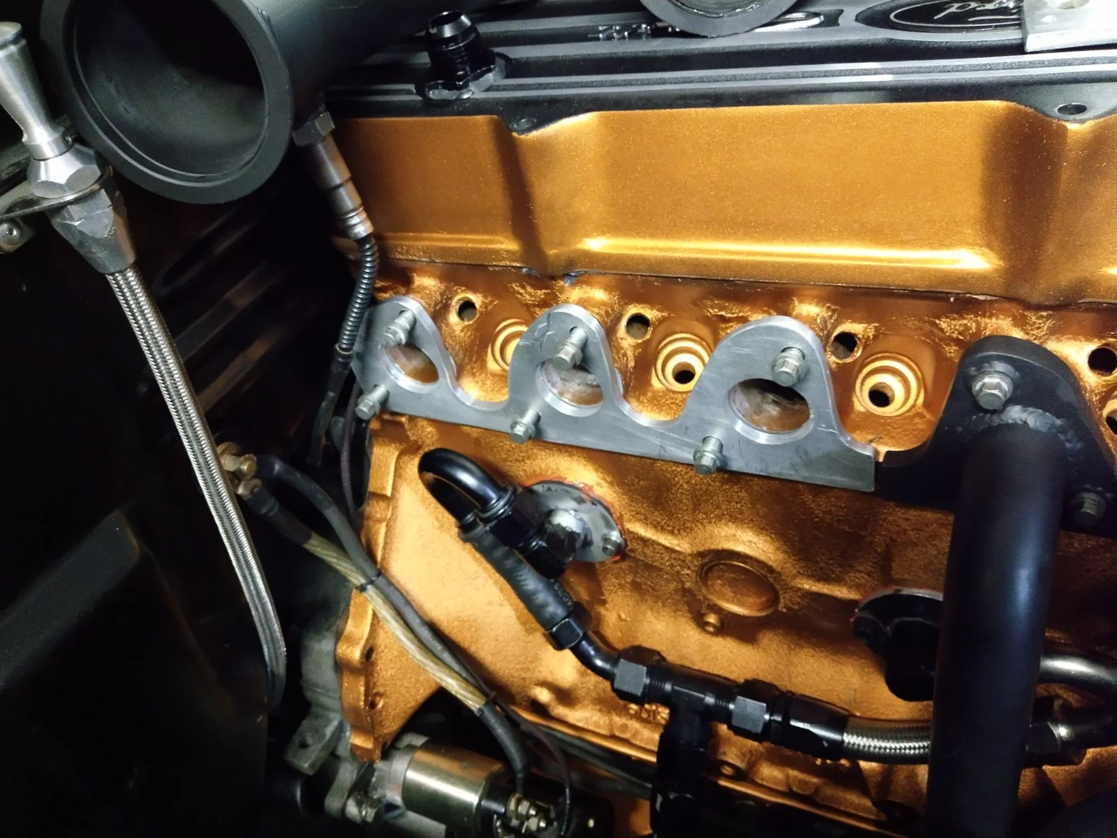

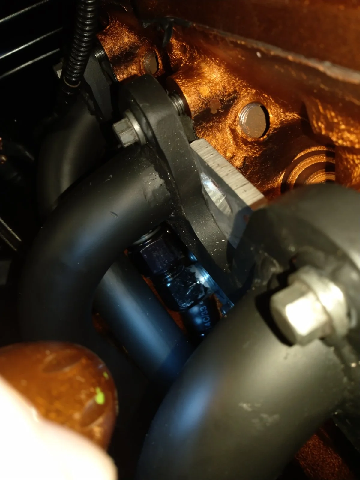

That rear header that has tubes 4,5,& 6 in one group was compressing the hell out of those water fittings. On a lark, I loosened it from the head this morning to see how far id have to space it off to get clearance. As I loosened the header bolts, it pushed itself off of the head.
It looks like I'd have to space it 1/4" to get the most minimal air gap.
I had a small piece of aluminum to confirm the required gap. I tightened the header against it, and there still appears to be maybe 1/16" between the tube and the fitting. Clearly I had binding going on, my down pipe transition popped off when I loosened the v band clamps as well.
Ironically, with that little piece wedged in there, the piece that goes on top that ties the two headers together lines up, and fits way better than it did.
So,..gee. I get to drill three big holes in a piece of aluminum plate, and use a jig saw to cut out the world's thickest header gasket today.....
CnC....plasma/water jet/ laser cut. PFFFT....I don’t need em.
I cut the existing header flange out of 1/2" plate with the same tools...aluminium should be a cake walk.

I took your advice,...I wrapped the two offending tubes as well..problem is, I used the old stuff that used to be on my down pipe. It looks like an ass sandwich.
The #6 tube had a pretty decent dent in it as a result of getting smashed against the water fitting. Now I don't know if I'll get enough clearance to wrap the tube, or whether it'll end up being jammed against the fitting again because of that. And whether it'd be better to leave it making contact after being wrapped, or better to have an actual air gap in between.

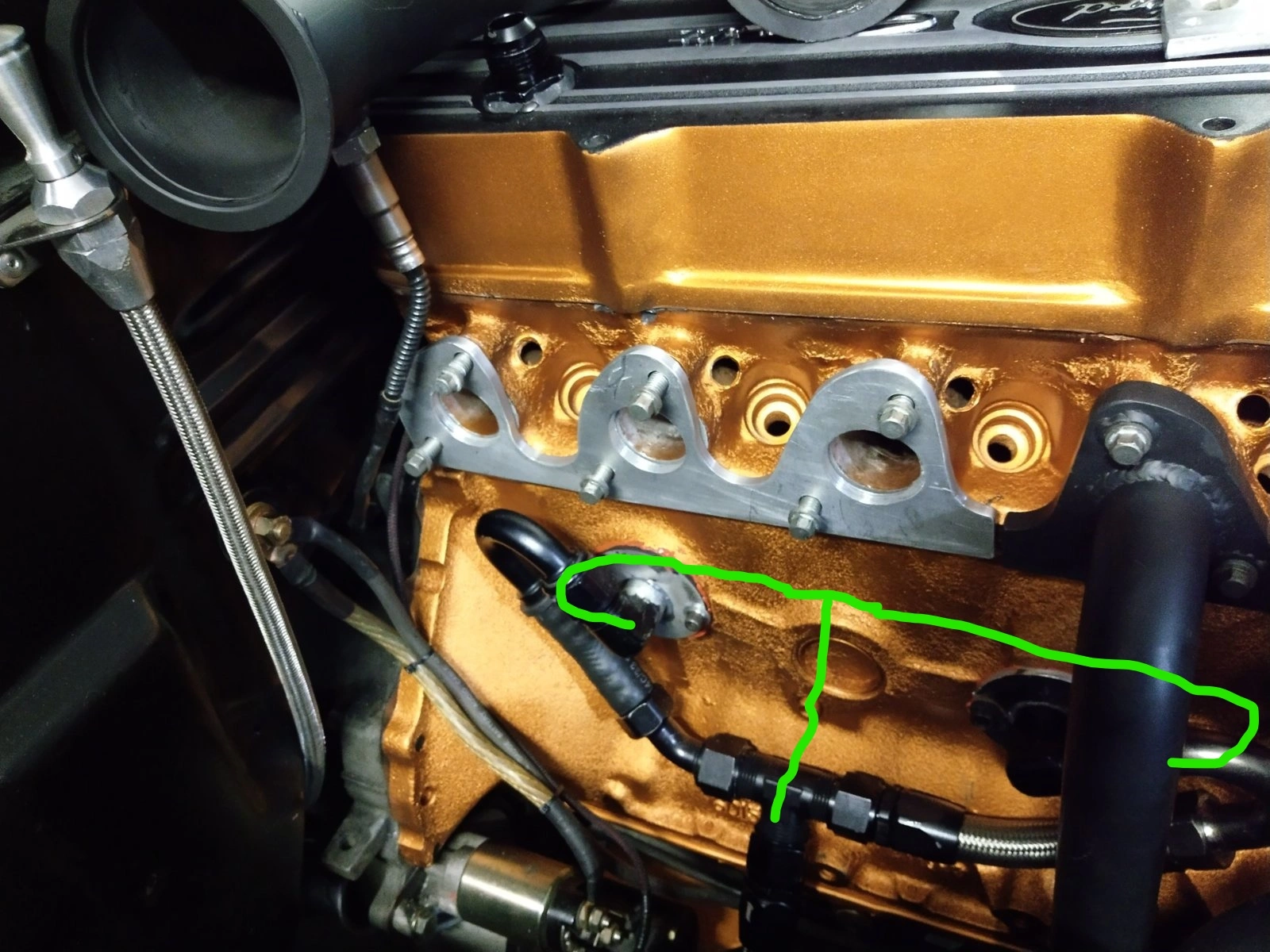

I'm raising my hand with a question.
Could you just extend the line from under to the T higher up the block toward the exhaust ports. The have the fitting on the left...tube 6 come out on top or to the right? Seems there is more of a gap higher up the block you go. Of course, I don't have a 3d monitor and can't tell and I'm not on the bottom of the earth looking up at it with a completely different perspective.
I found Paint.
No, not really. There isn't as much room under the header there, and besides..that center trunk line would have to run beneath tube 4 for the vertical run, and that tube tucks under the block tight as it is. I think the spacer fixed the problem anyway.
