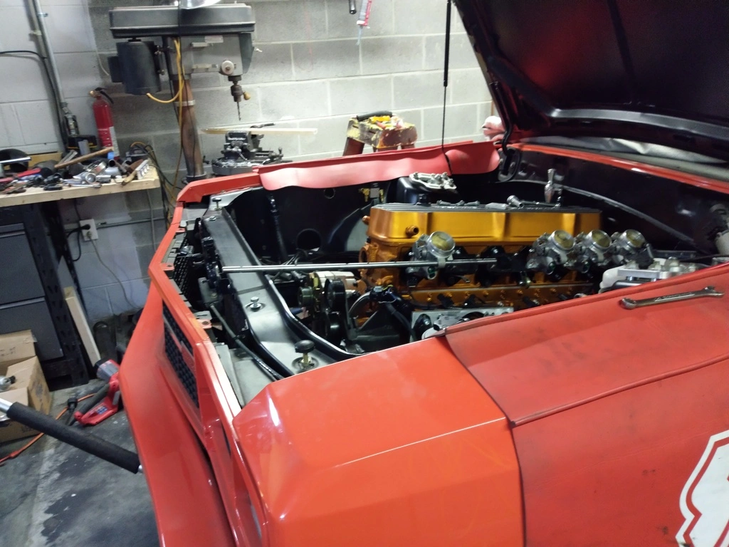

I'm committed. 4 of six throttle bodies are set in place. I started with the two end pieces, then the middle, (#4) Lastly #5. The shaft spins effortlessly, and I can guarantee that that won't change when I add the last two. Three of the throttle bodies are support versions, and 3 of them are just pass-throughs. I.e. 3 of them have no bearings, they do not touch the shaft. Therefore, there will be no added drag when I install the final two.
I will however have to come up with a way to back the shaft up far enough to allow me to even install the two remaining units (2,and 3). I can place a block under the pan, and lift that side of the engine off of its mount base, and the shaft will slide past the upper radiator saddle. I think I have this part licked.
I expect to get al of the pipe plugs from summit tomorrow, as well as some new black header wrap so as not to ignore Iowa Nicks suggestion that I wrap the tube that is contacting the fitting to add a little extra heat barrier there. Waiting on that stuff so that I can reassemble the exhaust permanently again...

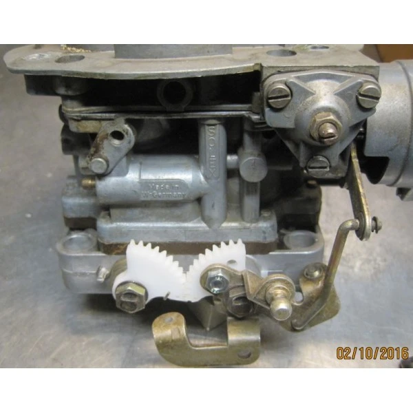

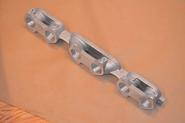

This relates to being able to split the six barrels of the ITB into two sets of three insofar as the common Solex 34 EEIT Gear Segments
are like the 38 DGES/DGAS, and allow the two parts to be phased apart about 1 inch or so
On a carb engine, the carbs are supposed to be level, so you can use the 3-1/2 degrees of engine tilt to run an ITB system leve in the engine bay, and out of phase equal to the gear segemnts.
In your case, maybee not what your looking for, but it is a trick that can work if your lashing a whole bunch of bind prone throttle bodies to gether.
Or, spltting them apart. Hence the show girl in the guillotine schtick.

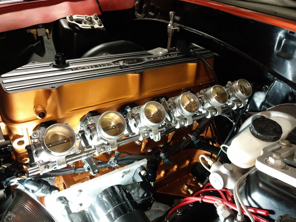

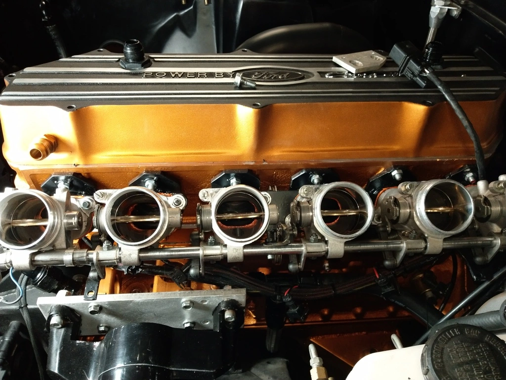

The build that seemingly goes nowhere just took another ambiguous step forward, then took another one straight sideways.
I said in my last update that I started putting the throttle bodies one at a time, all the while checking their collective alignment. I got to the point where I couldn't add any more of them because I couldn't pull the throttle shaft back far enough to allow me to install the front two TB's.
That changed when I stuck a block of wood under the oil pan, and jacked that bish up.
I was finally able to slide the shaft far enough back and get the remaining TB's installed, and lined up.
Look at the picture. All of the dog bones are installed, the throttle actuator lever is installed, and one of the two shaft restrictors are on in this pic. The shaft moves easily back and forth, so it has to have that movement controlled. Right after the #1 TB, I took one of the sleeves I made when I first cut the original shaft into sections, and used it as a shaft lock.
I also made another feeble attempt at the throttle linkage......
It only gets the throttle open to about the 7/8ths stage. The blades close to opening all the way, and are almost vertical....But...close doesn't work here. The operation is stodgy. I left the throttle cable exit point right where it was originally, and shortened the cable about 6" (I don't know why I did that,....I shoulda left it alone)

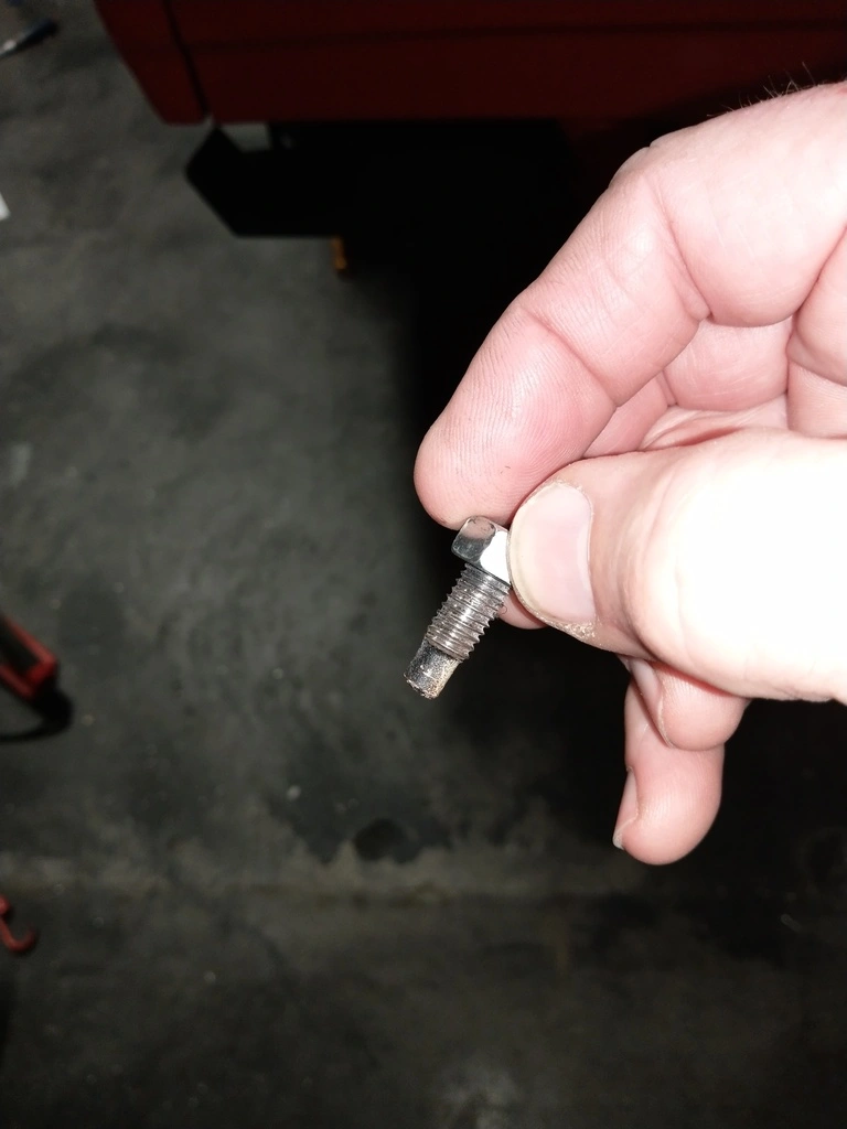

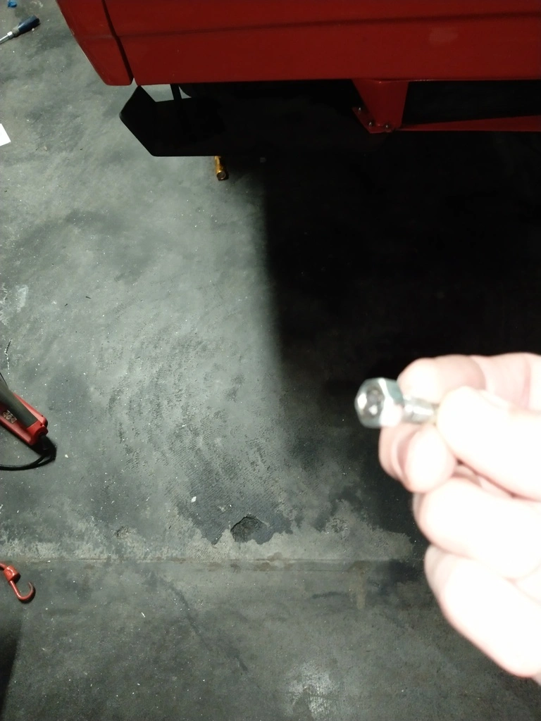

When I went to reinstall the gas pedal, I only had one nut, and one bolt to do laying on the floor to do it with. I thought it odd that the gas pedal would bolt to the floor, considering that there was a stud sticking up through one of the holes.
This was the bolt..
After looking at it though, fate reared its ugly head again...
It wasn't a bolt at all,....it's what is left of the broken off stud that is way the hell up under the dash,.....I now have to find a way to drill out a broken off stud that is so far under the dash that you have to twist yourself up under there just to see it. Now I gotta try to get a drill up there and drill out a broken off stud,......

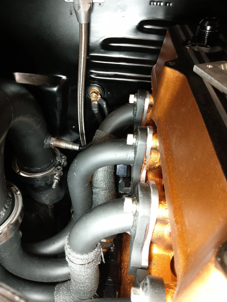

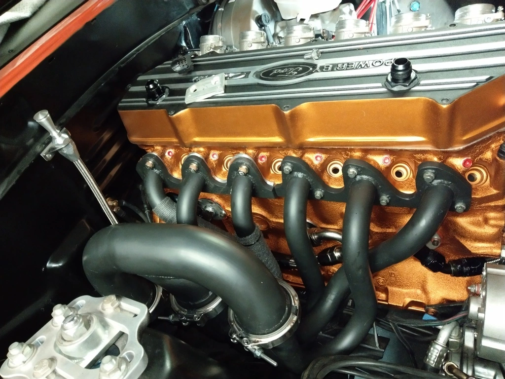

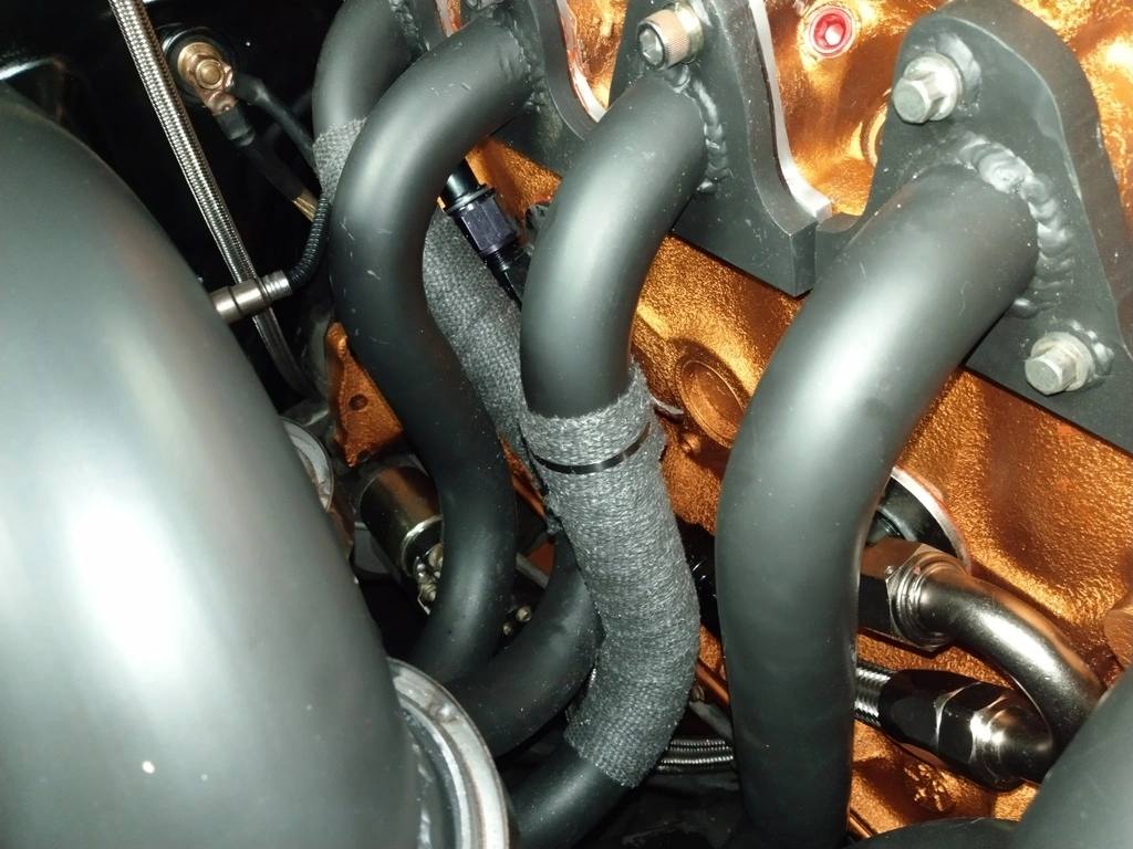

On the other side of the engine, the entire hot side is bolted in and clamped together..
As you can see Nick, @95BlueStallion , I wrapped the #4, and #6 tubes...so chalk that up on your "He listens to what I say board."
I coulda wrapped the #6 tube further down, but I was worried that I wouldn't have enough product to wrap the other tube, so I stopped short. ( I actually had enough, but it's laying on the floor now.
There is still an airgap between the fittings now, and the wrapped tubes though..
This is definitely done as far as I'm concerned.

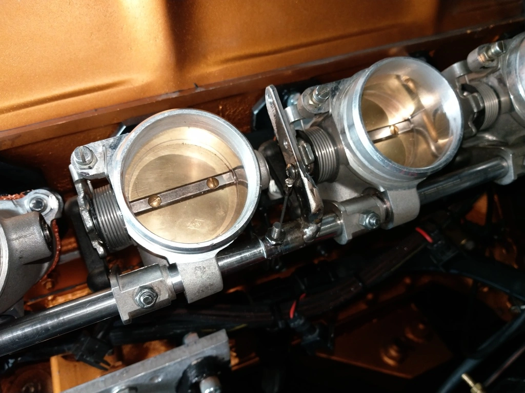

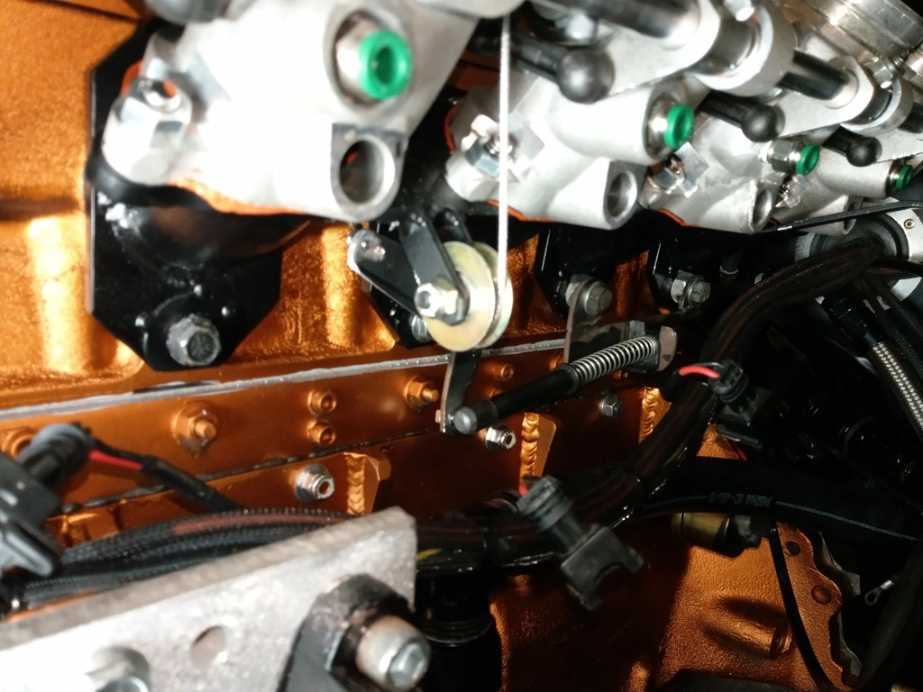

I'm gonna post a pic first and let it speak for itself. ( Then I'll speak for the pic):rolleyes:
Can you say Wide,.......Open,.....Throttle?
This was done while my son sat in the car with his foot planted on the floor. I think I've finally figured out the necessary math to get the throttle actuated.
This was where I needed to adjust my thinking. I was trying to make the throttle easier to open by lengthening the actuator rod. What that did at the same time was increase the distance a cable had to pull on that lever to fully rotate the shaft to full open. You can see the original intersect point at the end of the lever. I moved it inboard, but at that point, the thing crashes into the throttle bodies, and is all over the linkage. Just like the three bears however, baby bear's spot is the sweet spot. The pedal is distinctly heavier, but not so bad as to give me a leg cramp or anything.
Now, the last hurdle is tackled. The engine can go fully together. But first I've got to pull the throttle cable back off, the brackets, levers and the "fix" for the gas pedal mount and tweak/paint them. The cable needs to be shortened up about 1/2", the interconnect cable that runs over the pulleys is gonna be increased in diameter to 3/32" ( But now I have an exact length template to work off of)
So then,. I've got a working system that I can now refine to make it as close to perfect as I can.
I give myself 2 thumbs up.:nice::nice:
