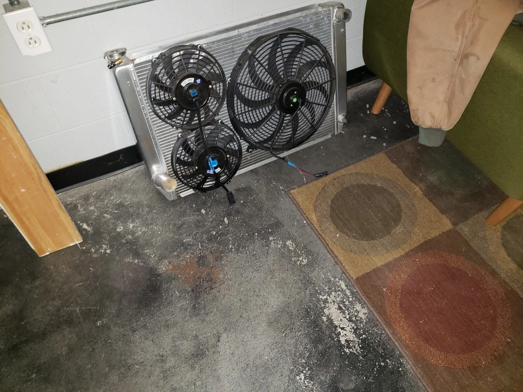

I tested the fans on the condenser...the cat ran out of basement as soon as he felt the pressure drop...* No animals were injured during the testing of these products. What he doesn't know is that I added another fan to the radiator..
Behold the Cat Shredder Max....since I cant get a shroud on this thing,.ill cover every inch with a spinning blade instead.

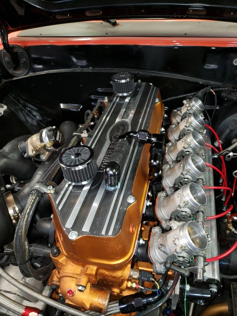

I installed the fuel rail, plugged in the injectors, wired everything back that could be wired, and installed the valve cover.
I replaced the taller Mr.Gasket valve cover breathers with some shorter units. I also added baffled grommets under the new breathers. The sewer pipe looking thing is the direct vent to the oil pan..I've made it a little convoluted on purpose to make it harder for wet oil to find its way into the valve cover. Whether or not that makes a R'sRBH of a difference.....I got no clue.
Guess we'll have to wait-N-see.:spot:

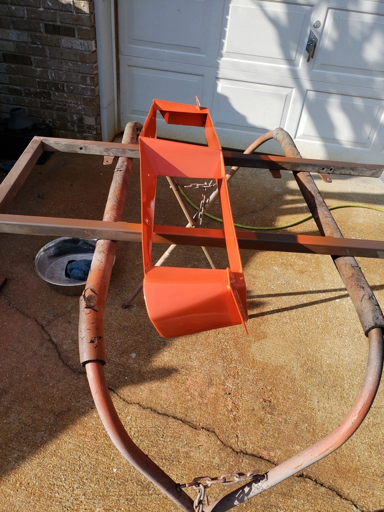

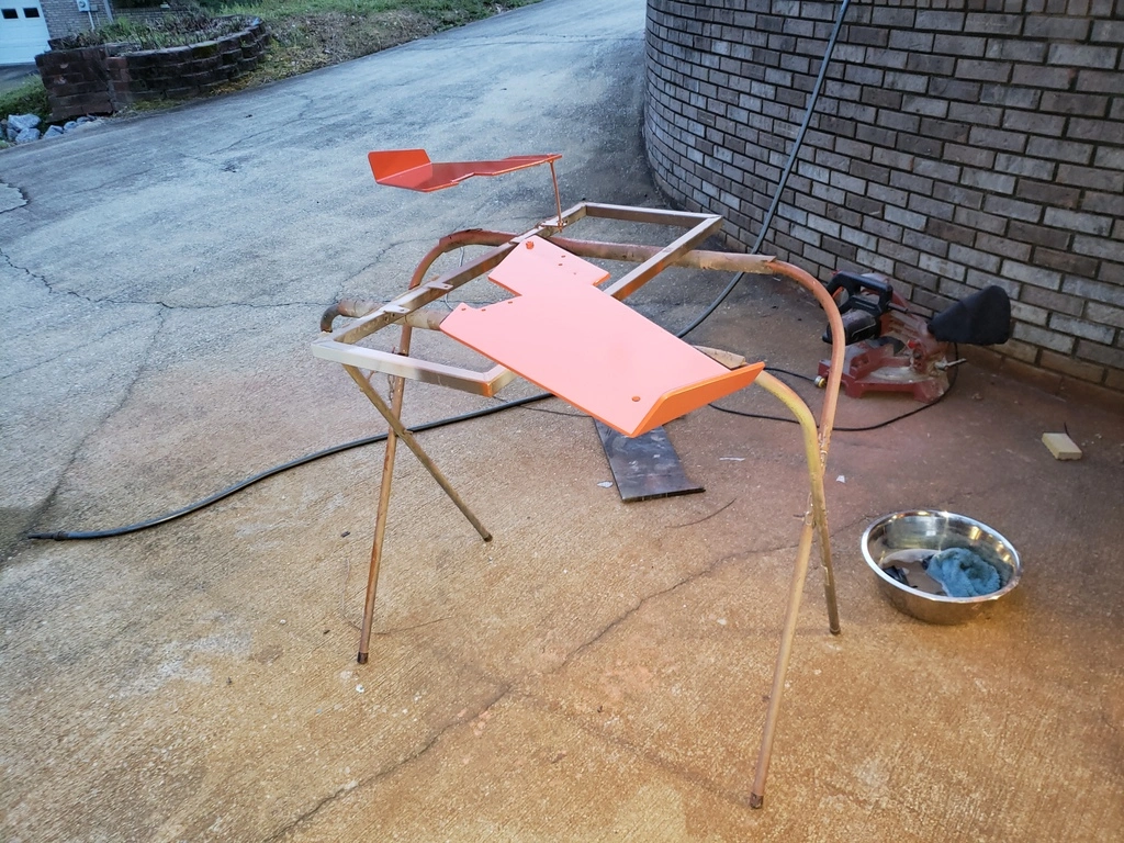

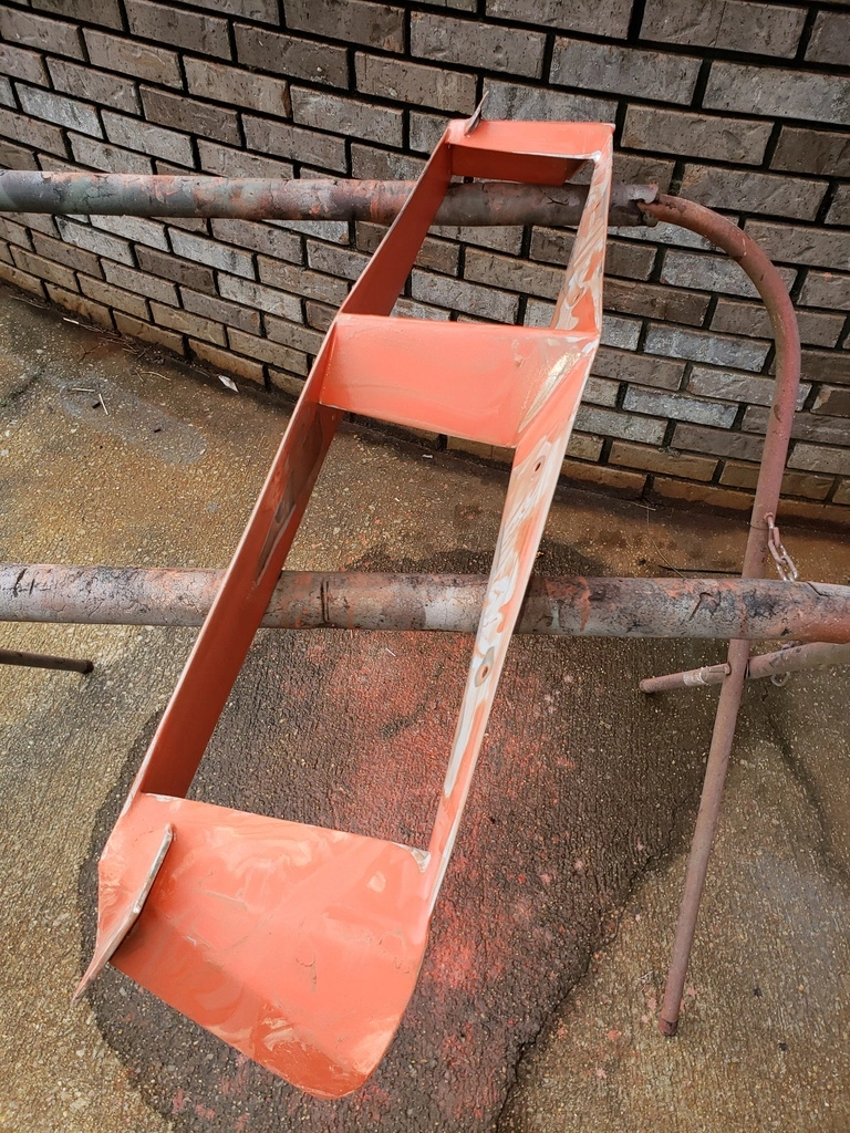

Actually, I worked on the oil cooler shroud, and the splitter pieces as my primary focus,....while I was waiting on paint to dry, I did this other stuff. Once I got the oil cooler shroud to my 80% "good enough" standard, I painted it.
With the pre-filled Competition Orange rattle can I bought last week. But using it proves to be a little problematic.
The problem was two fold however,..one was an immediate concern, the other will play out over time. The immediate problem was that there wasn't gonna be enough paint to paint the splitter "wings" in addition to the shroud itself. This stuff is enamel, and it cannot be top coated once it starts to dry,...so......I had to go and get another can if I hoped to get all of this crap painted today.
It was 4:30, the store closed at 5:00, and I was 1/2 hour away. I called them, put the paint on my debit card, and flew downtown in my oversized golf cart.
:spot:
And once I got back, I painted the splitter wings.
The other part of the problem is that enamel isn't very durable. It's soft. And having that stuff right up front in bug gut town will probably show it in short order...it's also slightly orange peely..not bad, and it's certainly not gonna cause me any loss of sleep...I'm just glad it's done so I can put the front end back together.
In hindsight, I'm surprised that I never came up with a "Gila" themed name for the shroud and splitter....it's so unlike me.

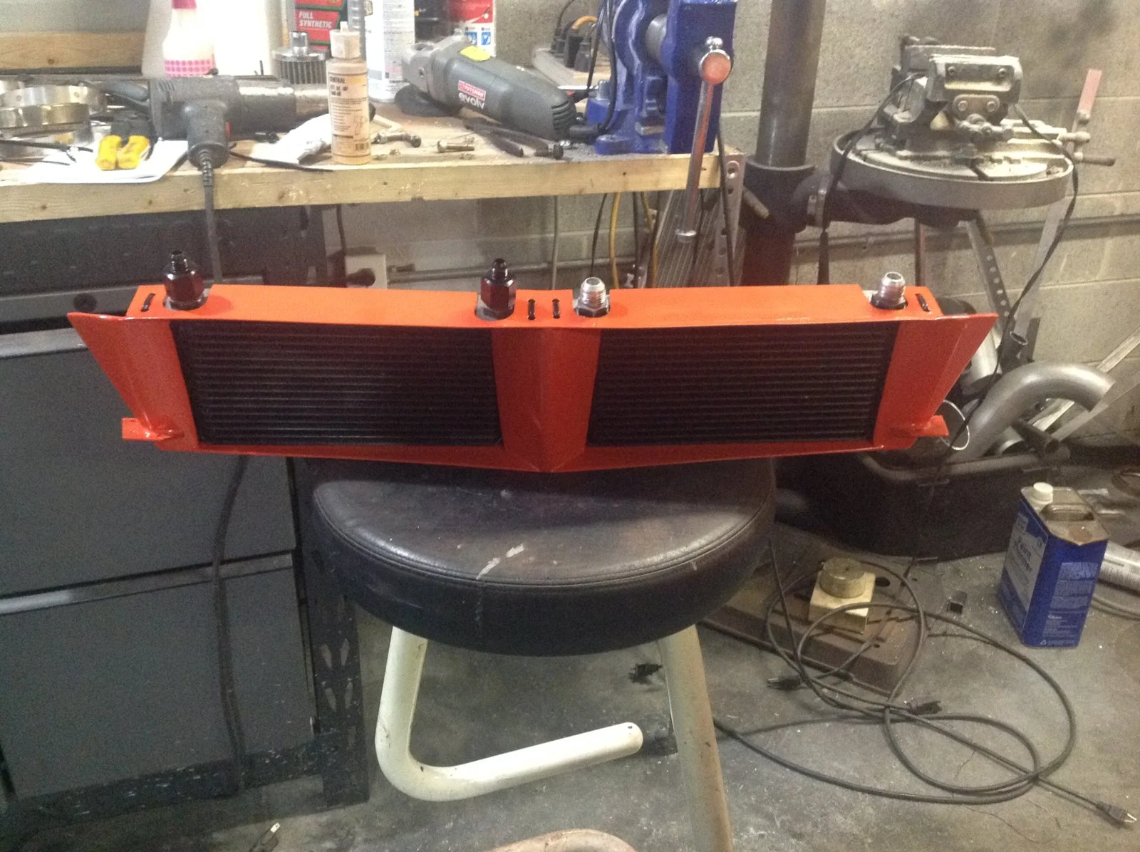

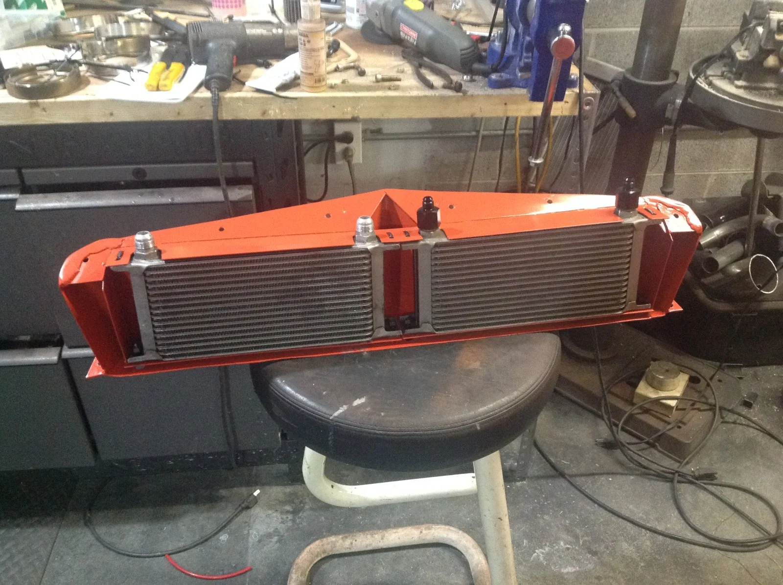

Meanwhile,...back on track.......I had to work today. But when I got home,...I fitted the oil coolers back into the shroud.
The one on the right is the engine oil cooler, and I determined it to be leaking over this tear down. It was one of the first things I bought as a replacement.
Problem with that is,...it was too small....fully one horizontal row too short.
So,..what you're looking at is the potentially leaky original gangster....both it, and it's twin brother now tied back in with Mike-O-magic zip ties...holding those two boys as snugly in place as a size 32" pair of tightly whiteys on a 34"waist.
I looked at the thing after finding out that the one that I've had now is too short.......I tried to see where it might be leaking....thinking that I may not have tightened the fittings enough.
.Wouldn't that be a btch.
