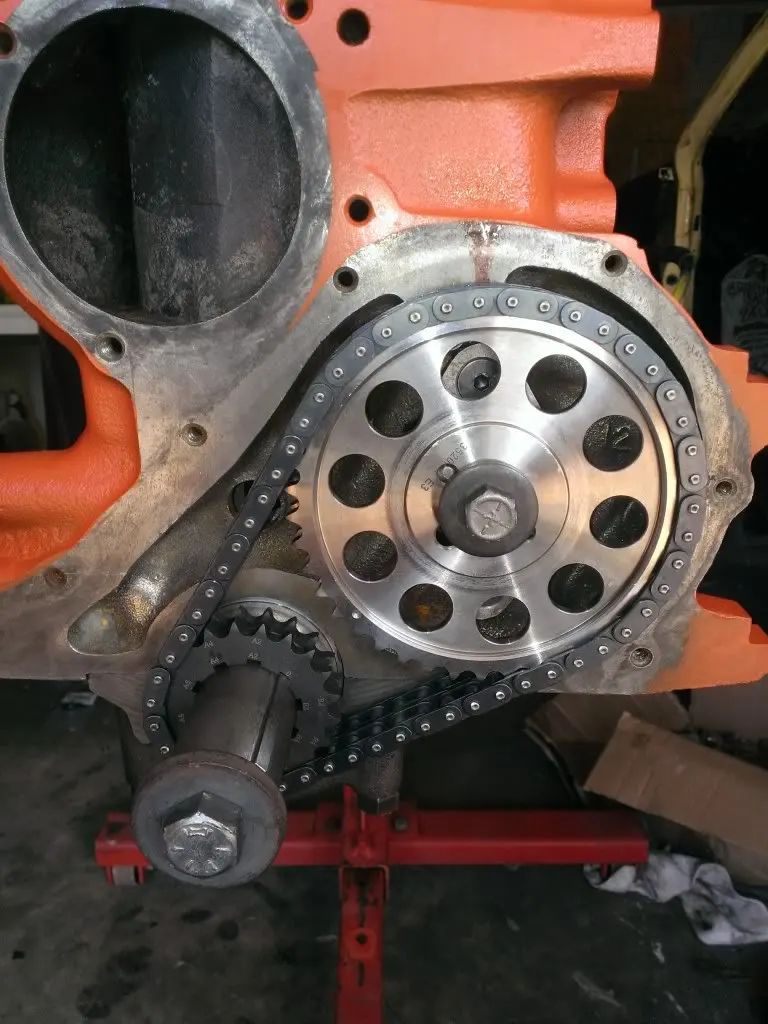

Mike did you use a factory sbf timing chain setup? Is there a flat spot in front of the timing gear on the timing cover?
If there is we can add a sensor in the cover and place a large washer on the cam bolt with a wedge cut out of it. Boom there's your cam signal.
Assuming there is enough room.
This is what Mike's timing chain looks like:
With the cover on, it looks promising enough..

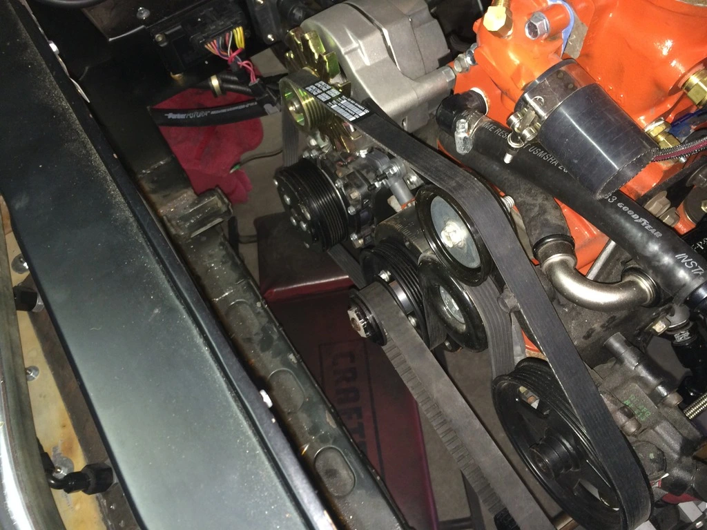

But, then all of those pesky pullies belts and hoses get added in...
