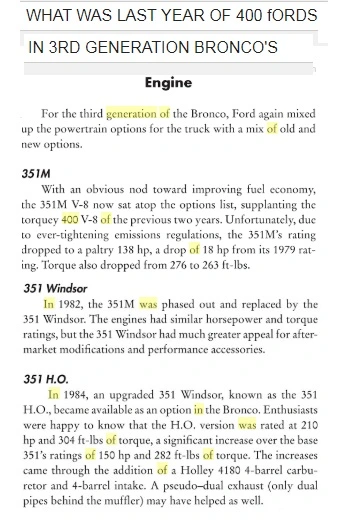

351c intake and the spacers from PME, Wieand or flatlanderracing.com, one or two Hair dryers on a later post 1977 351m or 400 with the cam retard taken out annihilates any other engine. 460 included.
Let all know that the finally crack free Cleveland foundary blocks were the 2nd and 3rd Gen truck engines, and just like the little 200 or 250, you can quadruple the power with just a turbo, a little intake work, and in that way, they are the engines in my opinion with the most latent potential. Even verses a 460.

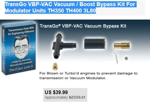

Yup. Modulator valve. Humf...
If you reverse the following system the way Cosmo Kramer does it, you'll most likely control the shifting better
VBP-VAc For trans's with vacuum
modulator and superchargers or Turbo. All you do is put a T and a one way check valve to bleed off boost, the rest of the time it will work on vacuum like normal.
Dang Yankee's...
IIRC, This is what the 1980 Fairmont Turbo 2.3's used with the C3 Bordeaux, a non return valve.
Vacuum/Boost Bypass Kit: All trans with vacuum . Prevents boost pressure from causing runaway line pressure.

I have that thing presently...it's a bleed valve alright, .....like it wont let the iron lung build any pressure at all. put 20 psi in, 20 psi goes right back out that hole. I modified it by tapping the thing so I can restrict the upward movement of the check ball, but in order for very little boost to get past it, I have to close the set screw down too tightly and it'll pass the boost through to the modulator. Open the set screw to minimize that, and let boost blow by, and the iron lung don't hold regulated pressure.
I put a standard one way check valve in line like you'd use in an AC system. Once installed, the iron lung holds 20 psi if I set that pressure at the test regulator.
I don't understand why I wouldn't use this thing..... once the lung converts to vacuum, the check valve pulls open just like normal, and the modulator would see vacuum again. The check ball thing I was using would let boost vent to atmosphere, and the rest of the line to the transmission after that would have to be equivalent to neutral...no vacuum, no boost.. What would be the diff here by using the check valve?
The only question I have is how the transmission will act on a WOT pull under boost shifting through all three gears...Before, with the check ball thing in place, there'd have to be no vacuum in the equation, and it worked..id have to imagine things will be the same.
Ok. Called transgo he said he didn't care what I use as long as the vacuum modulator never sees positive pressure.
The vacuum modulator regulates line pressure,.....it has nothing to do with the 1-2, or 2-3 shift per se', but keeps the necessary pressure in place to keep the clutches or bands applied when they need applying...so.....as long as that stupid little 5 dollar check valve don't rupture........I'm golden. If it does, I'm phcked.
