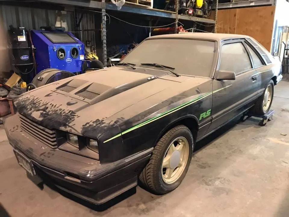

OK so I have spent the last hour online trying to figure this out with no solid info on the 4.2L V8. There is a 1980 Mercury Capri RS for sale, with said 4.2L V8, that I am very interested in picking up. As most of us know 1980 into mid 1982 the Ford fox platform had the 4.2L V8 ... not the 5.0 engine in. My question is about doing a 5.0 swap. Is a 5.0 swap just pulling the 4.2 drivetrain and dropping in the 5.0 drivetrain? Do they have the same mounting points, bell housing, etc? Another question is would it just be better to do a Maximum Motorsports tubular K member swap with the 5.0 set up and set it up that way? I do plan to build a street and mild track build. Thanks in advance!

Aloha gonzo, I just picked up the Capri a few days ago. It's a 40 year old time capsule! The car is completely stock except he replaced the stock carb and tires. Interior is in in excellent/near-mint condition, just smells musty. Carpet looks and feels new, not soiled at all. Guy washed off the car and brought it back to his home where he washed it off. Paint is mostly still real good with with very small chips flaking off. No scratches, just swirls. Clearcoat is still excellent, absolutely no fading or chalking. Guy also included the original TRX wheels with the original tires still on them. And no rust on the car. No dings, no dents at all. So glad I got it. You missed out on an absolutely rare find, esp in Hawai'i. It's a true barn find! Aloha // SL
