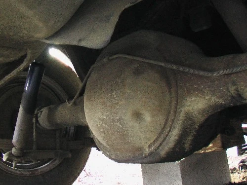

here's a few pics
I think it's definitely an 8" but you guys can confirm.

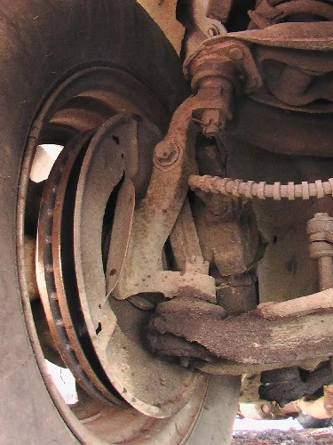

So I'm in the process of the taking off the spindles, and in the directions from CSRP, it says to really whale on the 'mounting bosses' with a 3lb hammer. I just wanted to double check before I start whaling on my front suspension - where is it exactly I'm supposed to hit? It looks like I would have to hit the lower A arm upwards, and the upper A-arm downwards to loosen the studs from the spindles. Is this right?

you don't need to do that. here is how i do it:
loosen the ball joint castle nuts but do not remove them and hit the spindle on the side of the boss where the ball joint bolts in.
generally just a few sharp whacks will pop it loose.
I guess I'm feeling mechanically slow today. Do the studs then come off with the spindle, or does the spindle somehow slip off the studs? I've been trying this for two hours and feel like I'm seriously missing something.
-the castle nuts are loose
-the tie rod stud is now off (done by taking the castle nut almost all the way off and gently tapping it to drive the stud down through the mounting hole)
-the spindle is still on the ball joints. After it 'pops loose' what then?
Do I need to take the lower A arm off?
Thanks guys. These are probably dumb questions but I don't want to break something. I haven't done much with suspension before.
Again, thanks.
I finally got them off. Just as you guys mentioned, a "few" sharp whacks and they came off.
