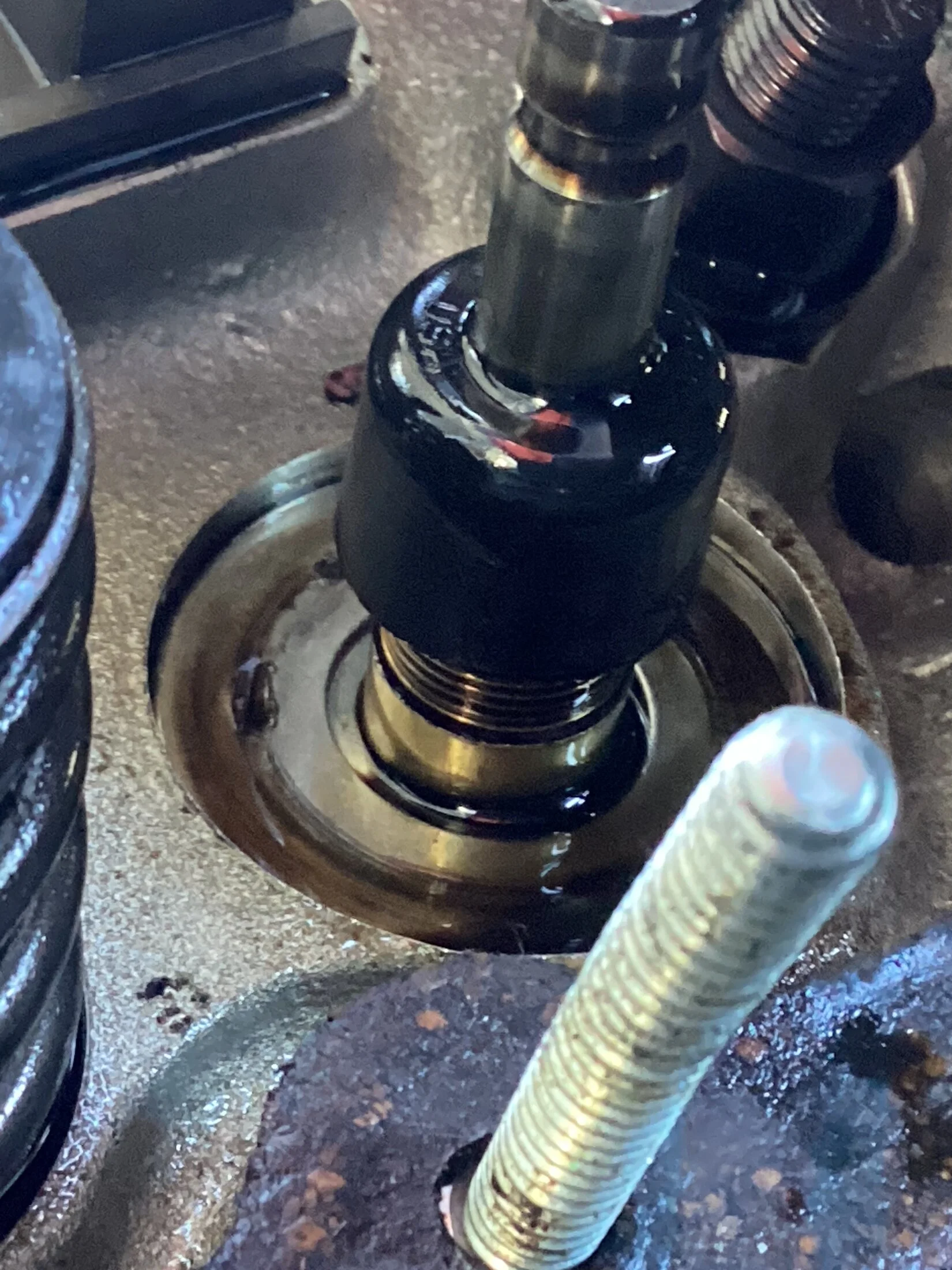

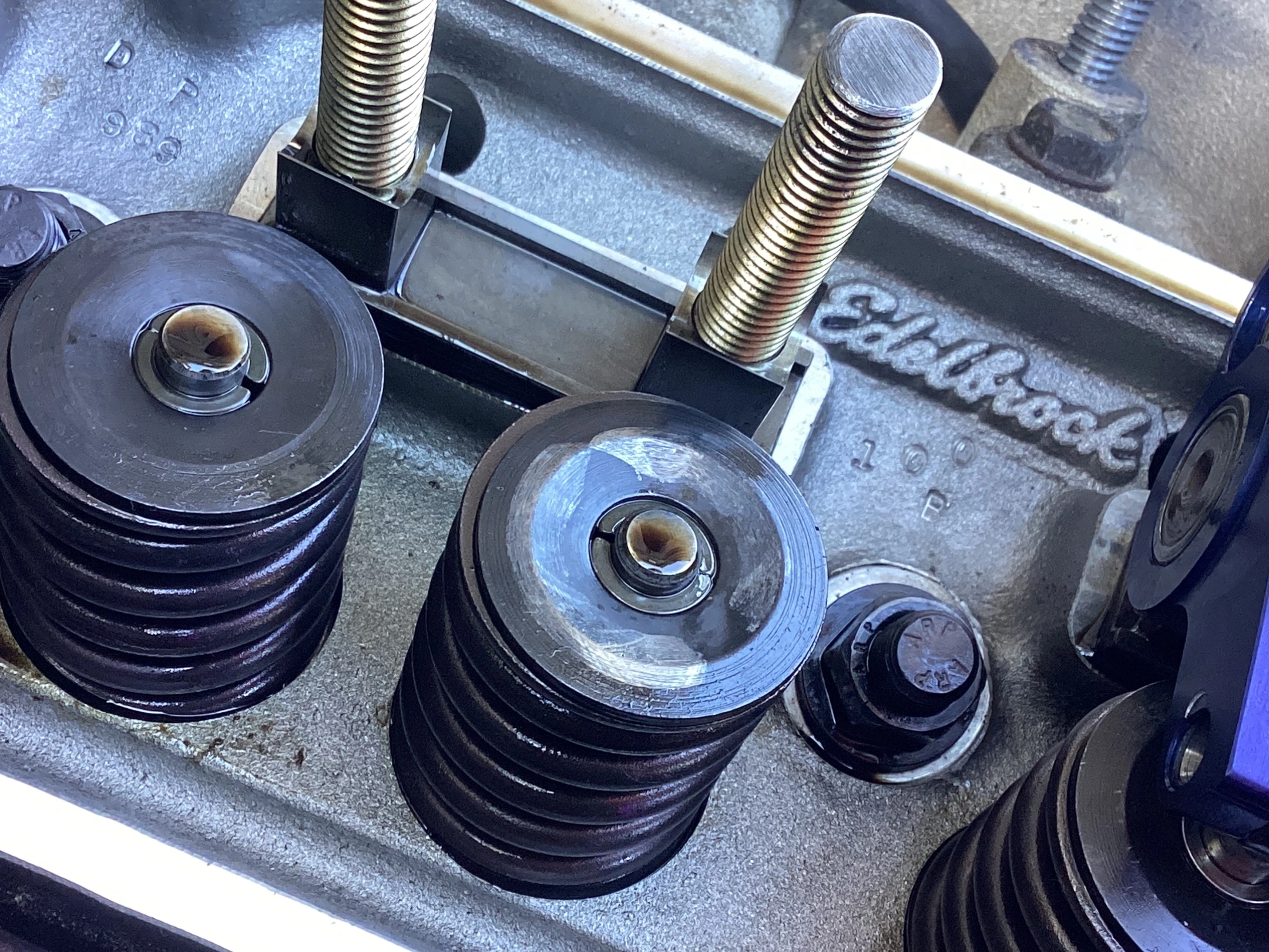

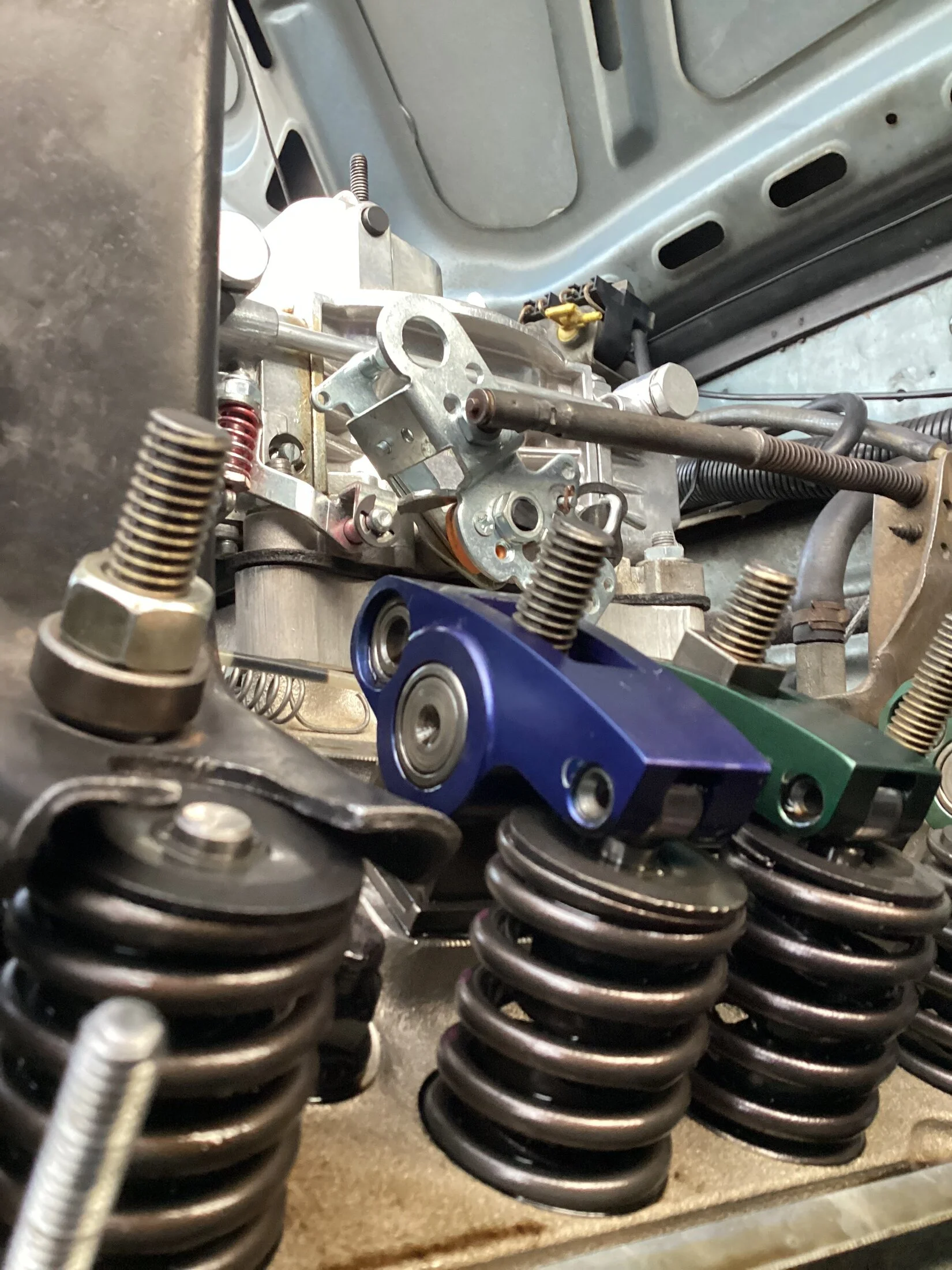

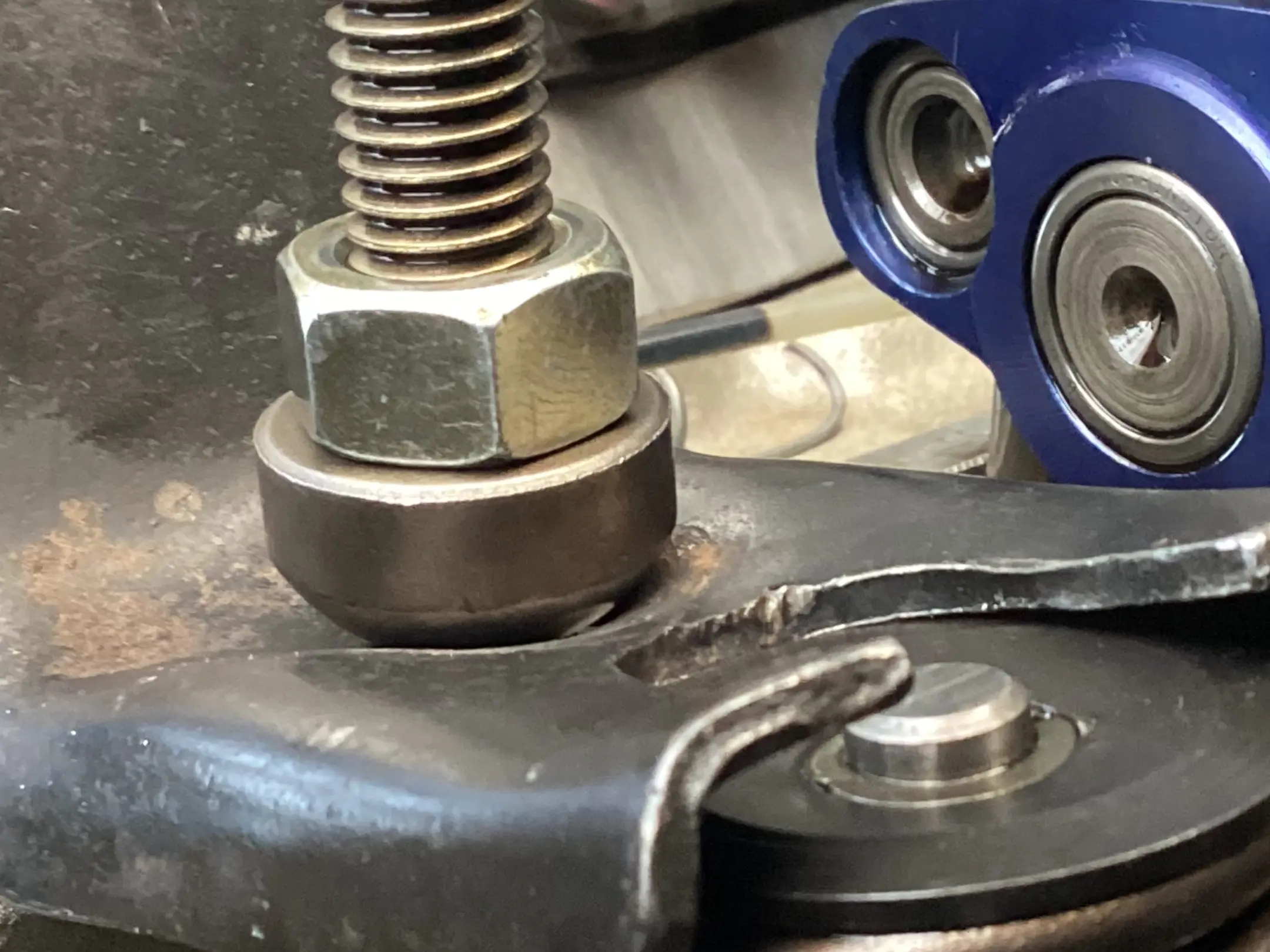

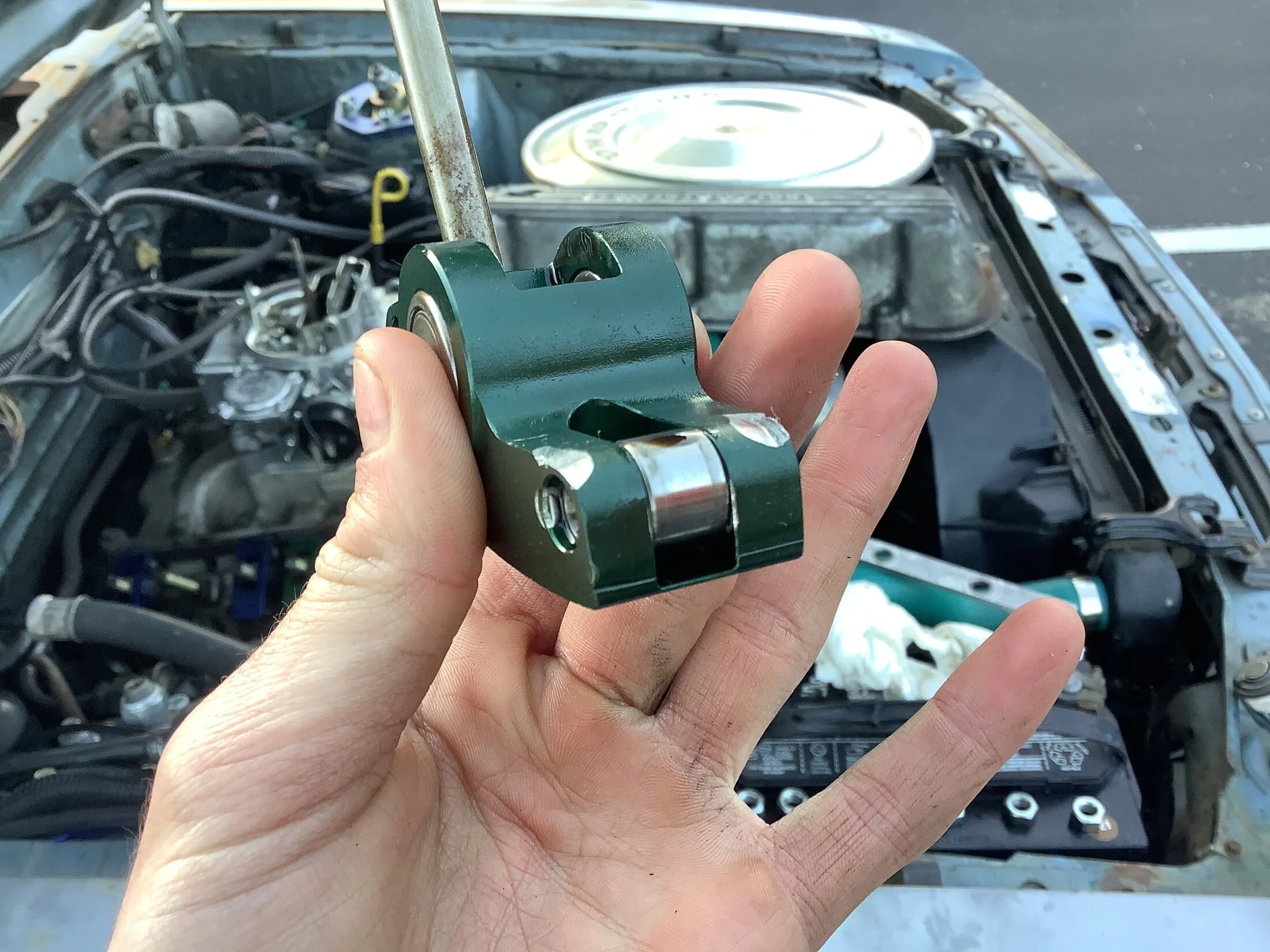

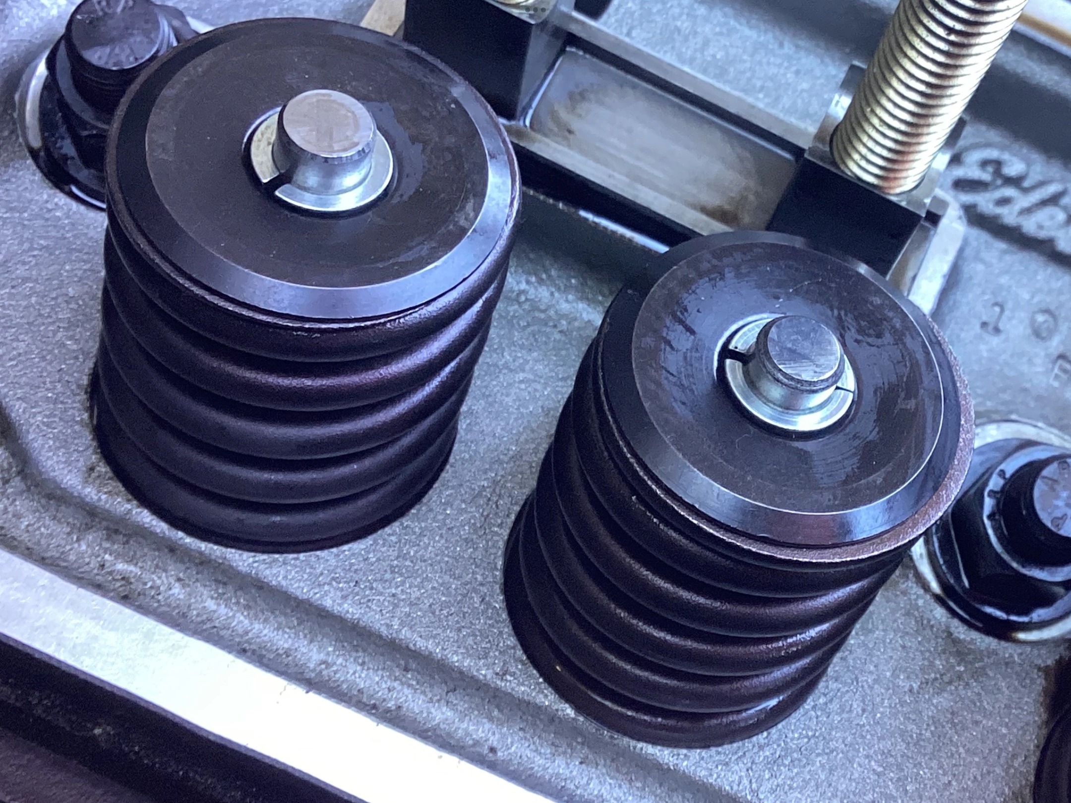

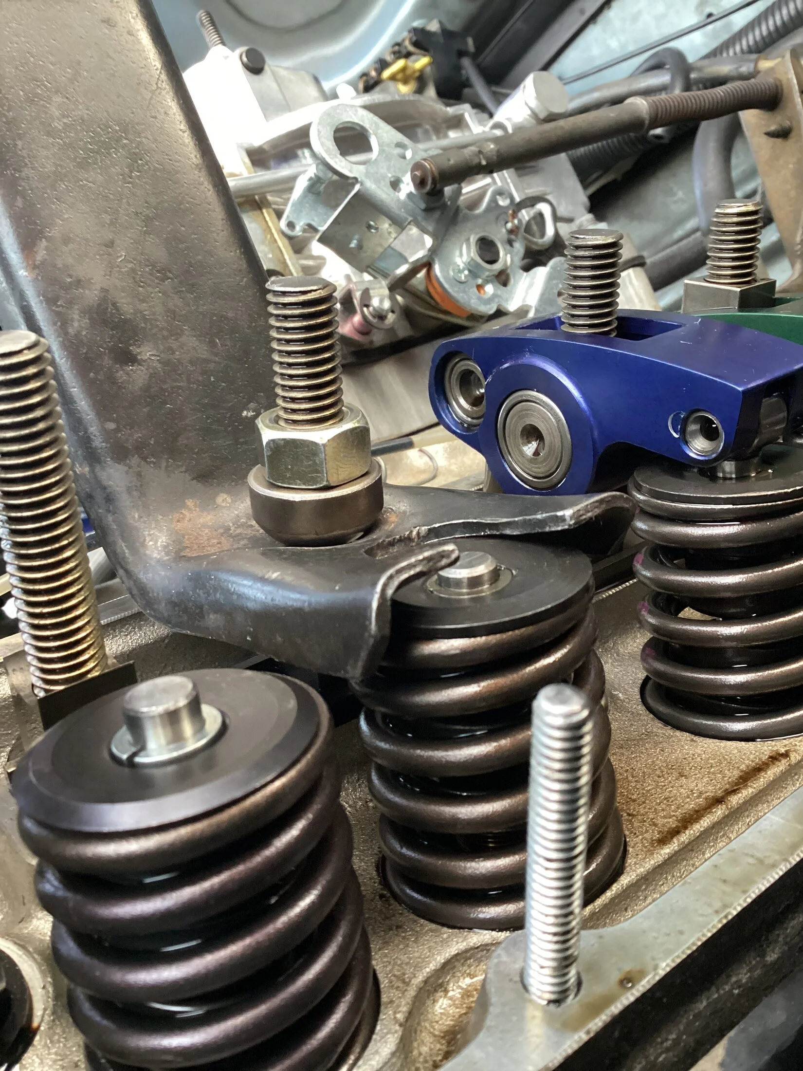

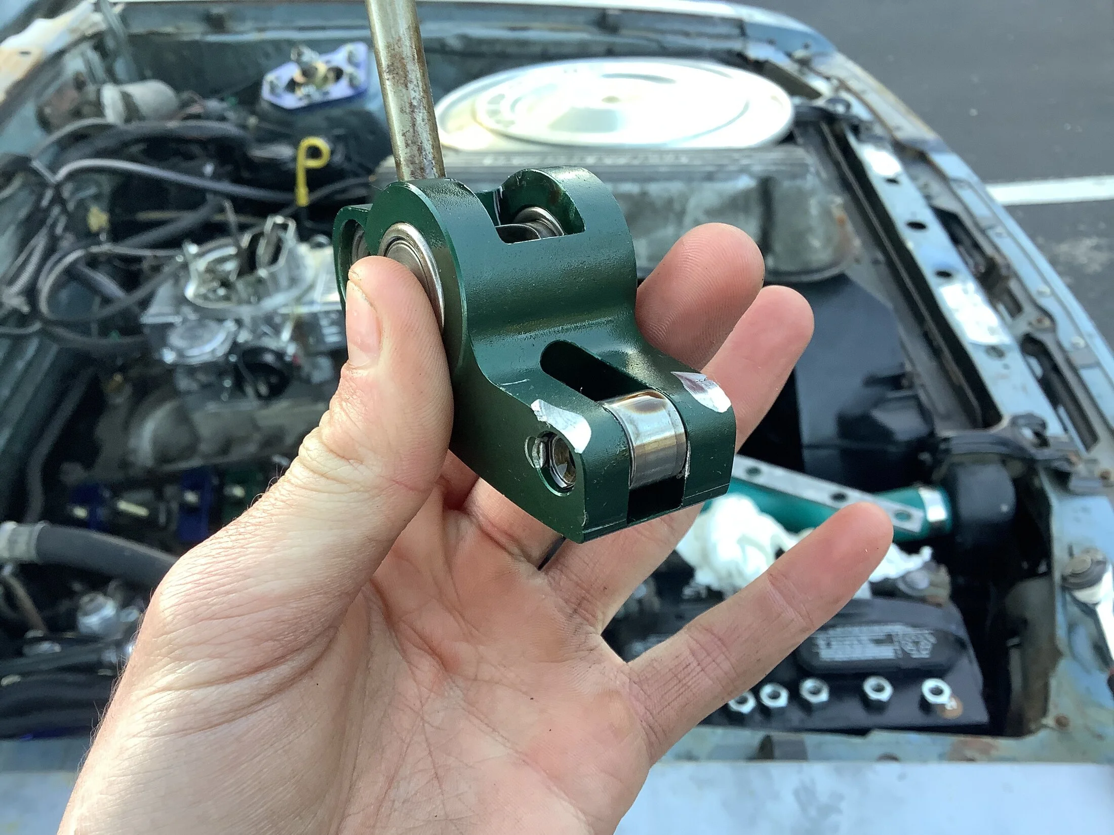

Hey guys it is coming along slowly, I got an exhaust leak and some other minor stuff to take care of but it's running well. I am getting another tranny rebuilt and planning to replace the clutch as well as supporting parts while I have the tranny out. I checked my roller rockers and I found that an old needle bearing broke, so I replaced them with solid rollers. When I was going to install the replaced rockers I noticed that the valve was hammered down in the retainer. And now for my final act, I replaced the keepers and retainers, to my avail the valve stem was pulled back up and is hopefully helping them seat a little better!:coff:

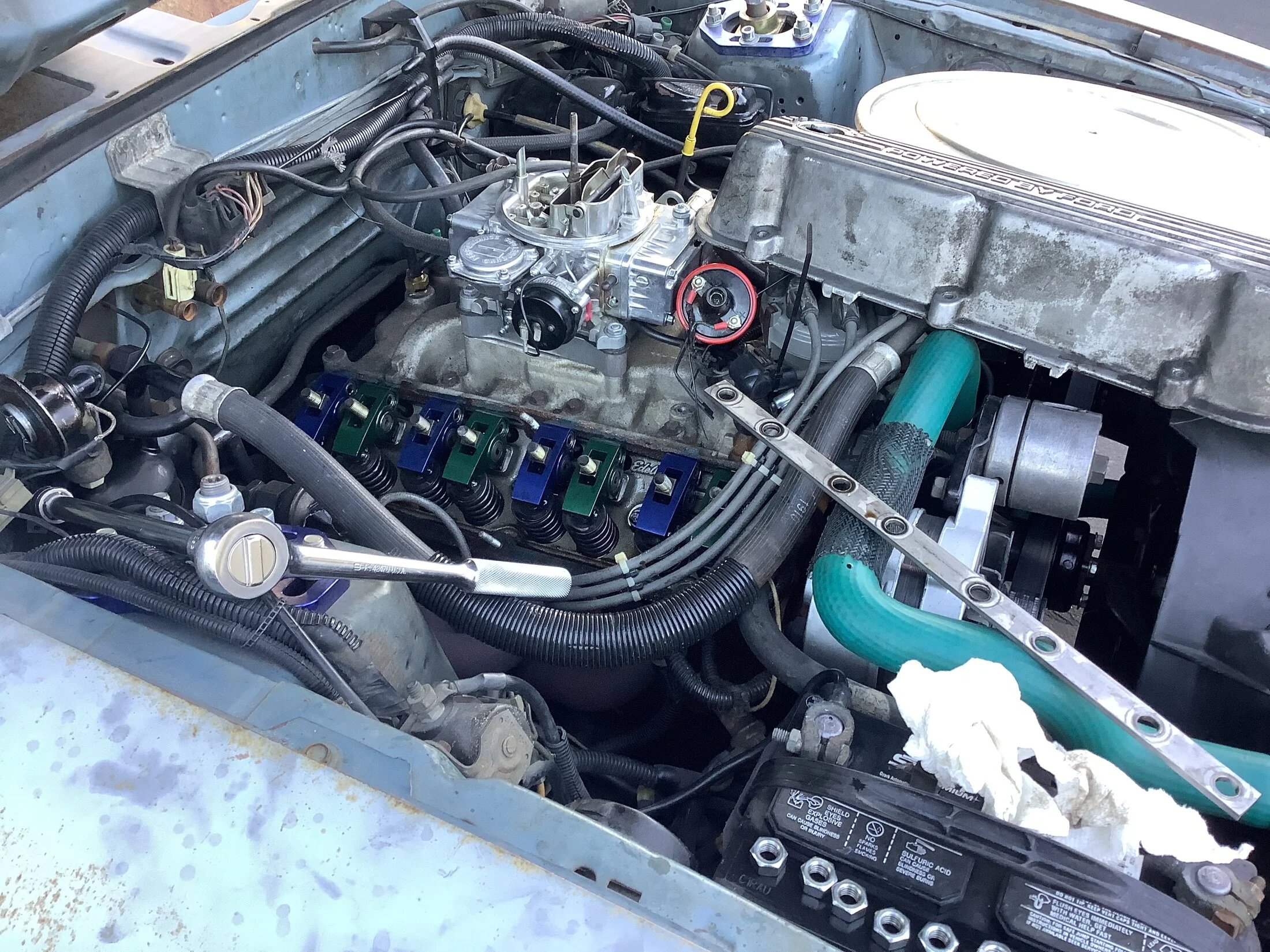

I had the header out yesterday to attempt a fix and reading some other posts, plus what I was recommended by my Grandpa was to use the Copper RTV. I could visibly see where the gasket was blown out, which was a relief. I applied some RTV evenly around each port, and got it bolted to the H pipe, but tragedy struck and I made a mistake. Putting the plugs back in my swivel and deep socket were not being friendly to me while I was snuggin ‘em up. On the third plug I snapped it, but its all part of learning! :crazy:

Yes my valve cover studs are bent, but look at how much those valves were pulled back up! Interesting . .

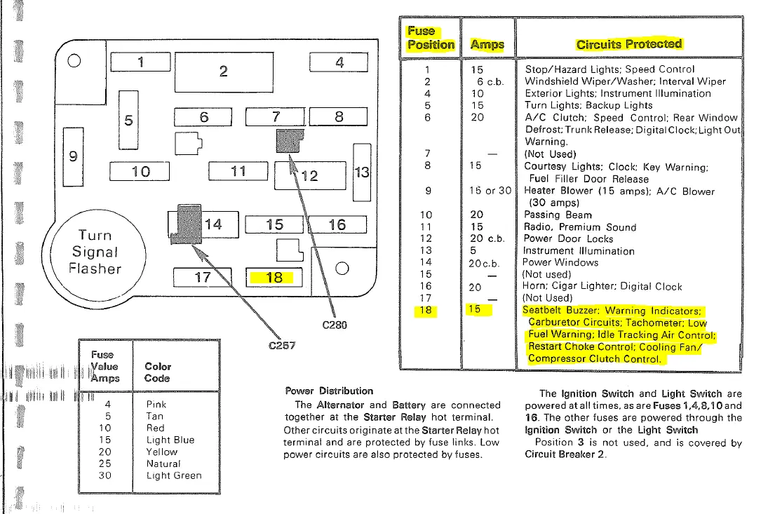

Would anyone know why the Tach fuse instantly blows when I turn the key/ when it gets power? It worked for a while then croaked, I figured it was a bad fuse, swapped it, it croaked again and now instantly blows when the key is turned. Has anyone run into this before?
On my 83 this fuse does more than just the tach.. Mine blew when I had grounded another wire....
The "tach" fuse has a ton of other circuits on it depending on engine type, etc. On my '85 GT, I seem to recall a blown fuse issue once that was related to the wiring in the "warning center" display in the center console. Another spot that often causes issues can be wiring related to the "Wide Open Throttle/A.C. Cutout Switch" switch that was attached to the factory carb. Try looking for a red wire with yellow hash marks on it that may be grounding out.
